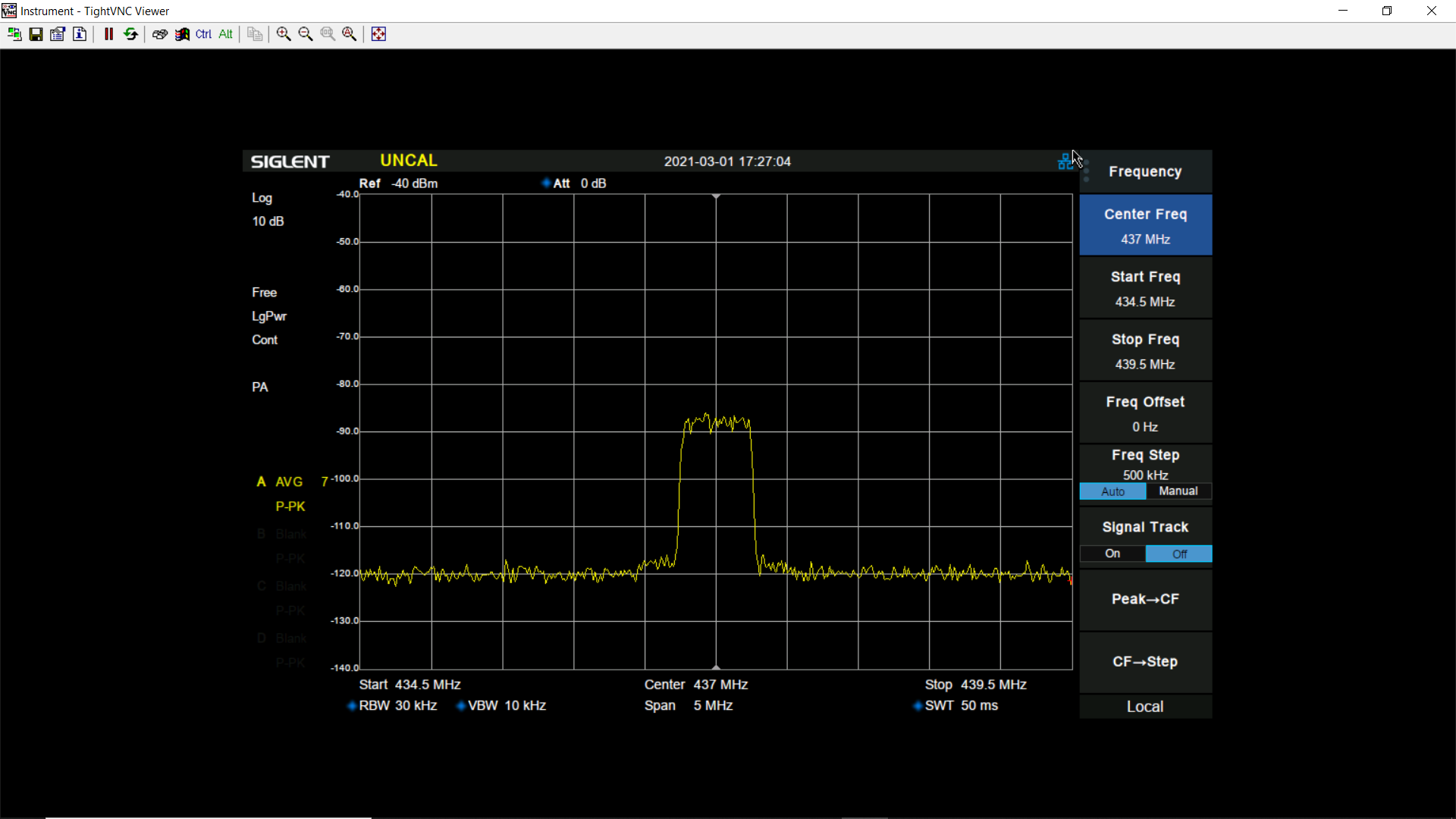

Today I had fun viewing and controlling G8XTW's spectrum analyser over the internet my dvbt signal was produced with the Portsdown 2020 and a Lime mini into a CML class A amplifier at 437MHz producing 20w O/P. I have attached a screen grab from Phil's analyser.

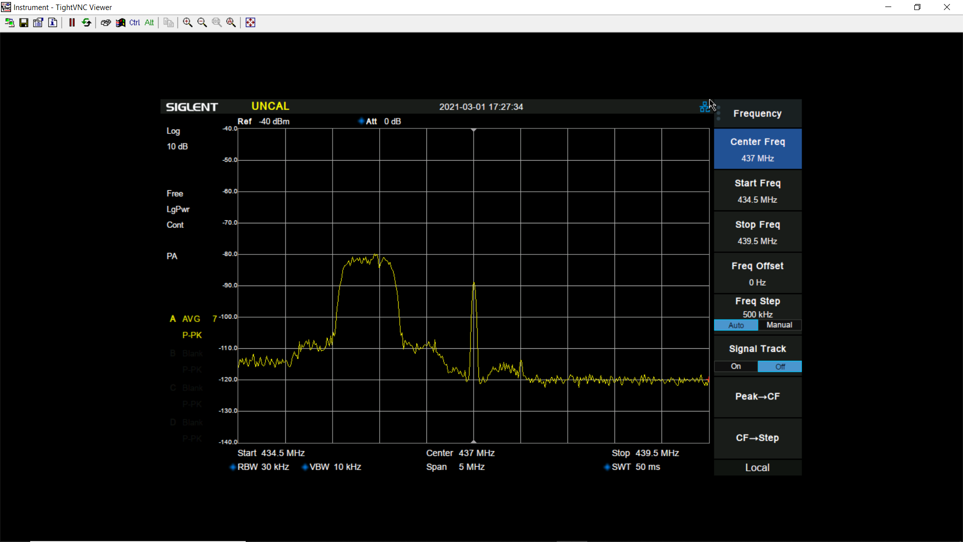

We then decided to take a look at the dvbs signal from the same setup with a surprising result the dvbs signal appeared at about 1.1MHz low and with an unmodulated signal at 437MHz. Has anyone else observed this or is it something strange with my gear.
LIME MINI Test report reads Hardware V1.2 Firmware V6 Gateware V 1.30 and the last 4 tests show Failed
73 Arthur G4CPE

Did a force update today and both dvbt and dvbs now working again.
73 Arthur
G4CPE
Re: New Portsdown 2020 Software Update
Post by G8GKQ » Wed Mar 03, 2021 10:22 pm
Hi Arthur
I was finally in a position to test and try to reproduce this problem today. I could not see anything amiss.
Please let me know if it happens again and we'll try to track down the cause.
The fact that the LimeSDR fails the last 4 tests is not unusual. It is normally caused by the gain of the TX and RX channels being slightly out of tolerance. You may find that it passes the tests when cold and with nothing connected to the SMAs.
