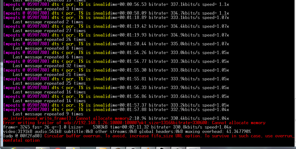

I am finally beginning to understand and use OBS and have now a hopefully small issue when using Recording to send video/audio using ffmpeg.
I am using the batch file and ini file as per Wiki https://wiki.batc.org.uk/OBS_-_Open_Broadcast_Studio
For testing purposes I have replaced the IP address for Portsdown with the IP address for another computer to view the stream using VLC player. Occasionally I get a number of errors at startup but the steam does send to VLC on the second computer.
However, after a minute or two the steam stops with the error message shown in Red in the image below.
Errors displayed when recording from OBS.
TS Errors.jpg (472.85 KiB) Viewed 6083 times
The batch file I am using is as below:-

I have made a few changes. The text "1000" in "udp://%ip%:10000?pkt_size=1316&bitrate=%TSBITRATE%" was removed as it seemed to duplicate the IP address, but this did not cure the issue with the stream freezing (red errors shown in image above).
After some searching on Google I added "overrun_nonfatal=1&fifo_size=2000000&" to the script above. This seems to have stopped the script from freezing, but I don't know enough about ffmpeg to know why this works or if I should have put this in.
While the freezing has stopped I am still getting some stuttering on the VLC player on the other computer. This occurs when there is quick movement on the video and results in the Yellow errors "TS is invalid" in the image above. When the quick movement stops VLC resumes showing the video.
The computer I am running OBS on is an Intel I7 at 4GHz, with 16GByte of memory. Task manager shows there is not much load on the processor and only 4GByte of memory in use. All tests have been done with FEC 2/3 and SR of 250ks.
How can I alter the script to make the stream smooth and remove these error messages ?
Any advice will be much appreciated.

Yes it was about the Pluto, but fundamentally it is producing a UDP transport stream, which is what you are trying to do. Look at the format of the ffmpeg commands. Until you understand ffmpeg it's unlikely you will get anywhere trying to edit that script as you don't know what you are doing. For example I think you deleted a key command at the end because you saw it as duplication.
The problem you have with dts < pcr is a audio / video timing error that usually appears from combination of trying to put too much video information through too small a multiplex pipe and also not having sufficient buffering to allow the codec to work with that content. If you set the video bitrate too high these errors will occur. If you set it too low the video will be terrible. Larger buffers help but add to the latency. If you try to put too high a resolution through the H264 encoder it will be very blocky with anything that moves. Some compromise is needed to get good results and it depends on the content. If you look at the example in the article you can see what settings I used for H264 2/3 333ks QPSK.
When that script was developed in 2019 we were in the early stages of understanding how to operate low bitrates successfully. There has been huge progress since then.
You should be able to take the H264 script, or an H265 script if you have a suitable graphics card or very fast CPU, and parameterise it if you want.
By the way, your script doesn't seem to do any coding, only copying, so if you are using OBS record you need to have the correct settings there too. That's quite a detailed thing to set up and covered in John G7JTTs article. Again there have been developments since that was written. If you don't match the TS rate coming out of OBS to that in the script it's going to overflow. The other way to do this is to either use OBS Camera plugin (not the built in version) or set a high quality UDP output from OBS and re-encode it in the batch script. This saves needing multiple OBS profiles for each bitrate.
