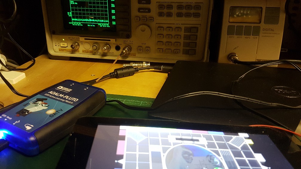

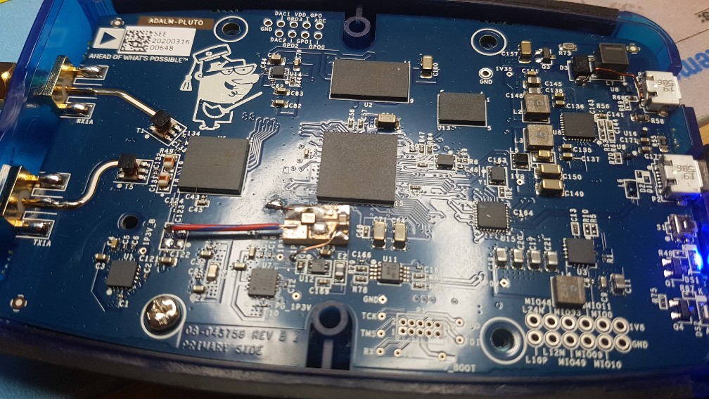

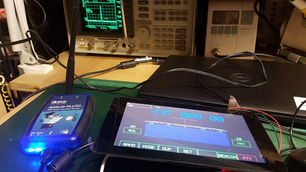

I've modified a new Pluto so the ground mod and 0.5ppm TCXO are fitted pictured. The Pluto did a SATSAGEN spectrum analyser and tracking generator sweep on a coax cable from 50MHz to 6GHz just fine with DATV firmware. It transmits a signal in FM with the Langstone that shows up on my spectrum analyser on e.g 2m, 70cm and 23 cm bands. The DATV firmware info page shows up no bother. All attempts to produce a DATV signal in Pluto output in Portsdown 4 have come to nought. :( Should it just work out of the box or is there a hidden switch? I'd better look for a 40MHz signal with my oscilloscope no it's all in doubt.

Post-mod pluto
Post-mod pluto

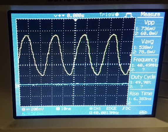

All this was done with the Pluto plugged into a USB3 port. I tried the prescribed settings and no DATV signal rose out of the -70 DBm noise floor. The only difference before was 1/2 FEC. I rebooted the Pluto from the menu but no change no signal. Langstone FM with a mouse attached - nice tuning - was just fine. The TCXO is putting out 740mV peak to peak of 40MHz according to my cheap scope.

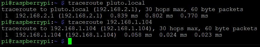

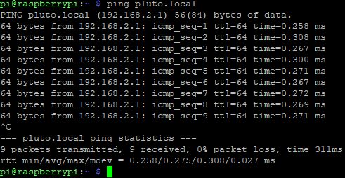

So that I can find the right Pi amongst five on my network after doing a new build, I temporarily add "ip=192.168.1.104::192.168.1.254:255.255.255.0:rpi:eth0:off" in the same line in cmdline.txt in the boot folder. It forces the Ethernet interface to become dual homed, adding a fixed IP to the DHCP router assigned address. This avoids having to use the Angry IP scanner and work out which of half a dozen Raspberries on your network is the one you want.
Having got the P4 running, I hadn't removed the temporary addition to cmdline.txt, so to eliminate the possibility of a self-inflicted error, I removed it and then used the the correct method to create a static IP which modifies /etc/dhcpcd.conf. Testing again with the Pluto made no difference.
I then ran traceroute pluto.local and it correctly reported 192.168.2.1, although it took a long time for the DNS lookup to complete
I then ran pings to the IP and name and got this, again after a wait of more than 10 seconds:
That would suggest to me that the Name Service is working as it should.
Can you offer some further suggestions?
73, Clive

Thanks Clive
I am now very puzzled, because if you can ping pluto.local, the Pluto button on the "Output to" menu should not be greyed out (you can only see this if you select BATC or another output).
Can you successfully reboot the Pluto now that you can ping it? If, so, after a successful reboot, it might be worth trying TX again.
