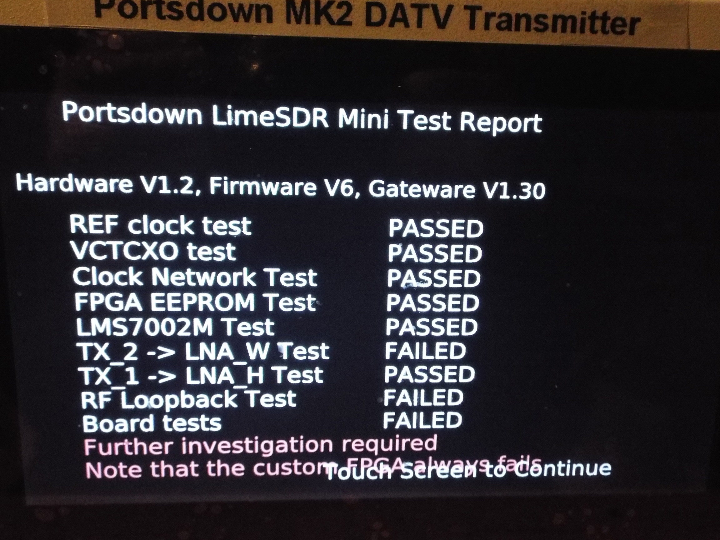

Lime Test after Custom DVB Update
After Lime Update to Custom DVB Firmware.jpg (879.9 KiB) Viewed 2568 times
Can you let me know if the failed tests shown above are the ones to be expected ?
Regards,
Nick.
