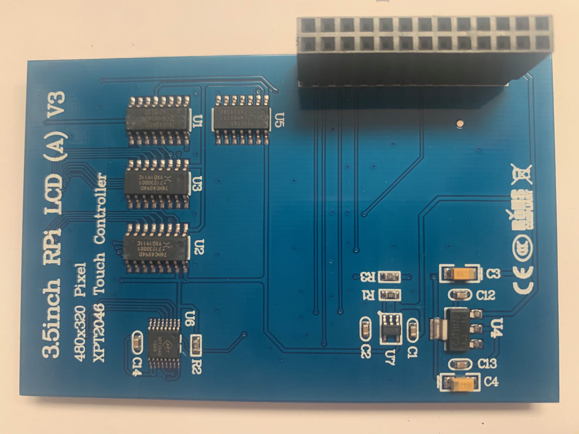

If a 3.5 inch screen, please could you provide a photo of the reverse (PCB) side of your screen so that I can check the version.

See attached pic of display.
lcd portsdown.jpg (419.9 KiB) Viewed 4542 times

Your problem is that you do not have a genuine Waveshare Type A Display. It is a some sort of (poor) copy. Same problem as PA3FBX here: viewtopic.php?f=103&t=6976
The genuine display is marked like this: https://www.waveshare.com/product/displ ... -lcd-a.htm
You could go into the c code (rpidatv/src/rpidatvtouch.c) and try to modify it to work and then recompile, but I would suggest that it is not worth the effort.
We had lots of similar problems when we started the project 3 years ago. If you have room, I would suggest that you replace it with the Raspberry Pi Foundation 7 inch display https://www.raspberrypi.org/products/ra ... h-display/ then you can use it to watch smooth video from the streamer or (with a MiniTiouner) as a DATV receiver.
