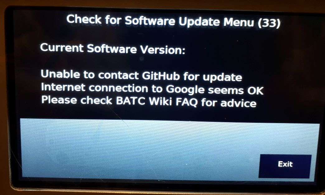

With the update menu I am getting a can't connect to Github error - but the internet is OK and it can contact google. Can you remind me what to do to fix that? I can ping github so rather odd?
Edit - a manual ssh rpidatv/update.sh update is going ahead OK it seems.

Post by G8GKQ » Mon Oct 26, 2020 10:36 pm
Sounds like a temporary internet or DNS glitch Mike. Anyway, you can try again if you want - I've just pushed another update.

Post by g0mjw » Mon Oct 26, 2020 10:53 pm
No - just the same. Problem with the setup maybe?
