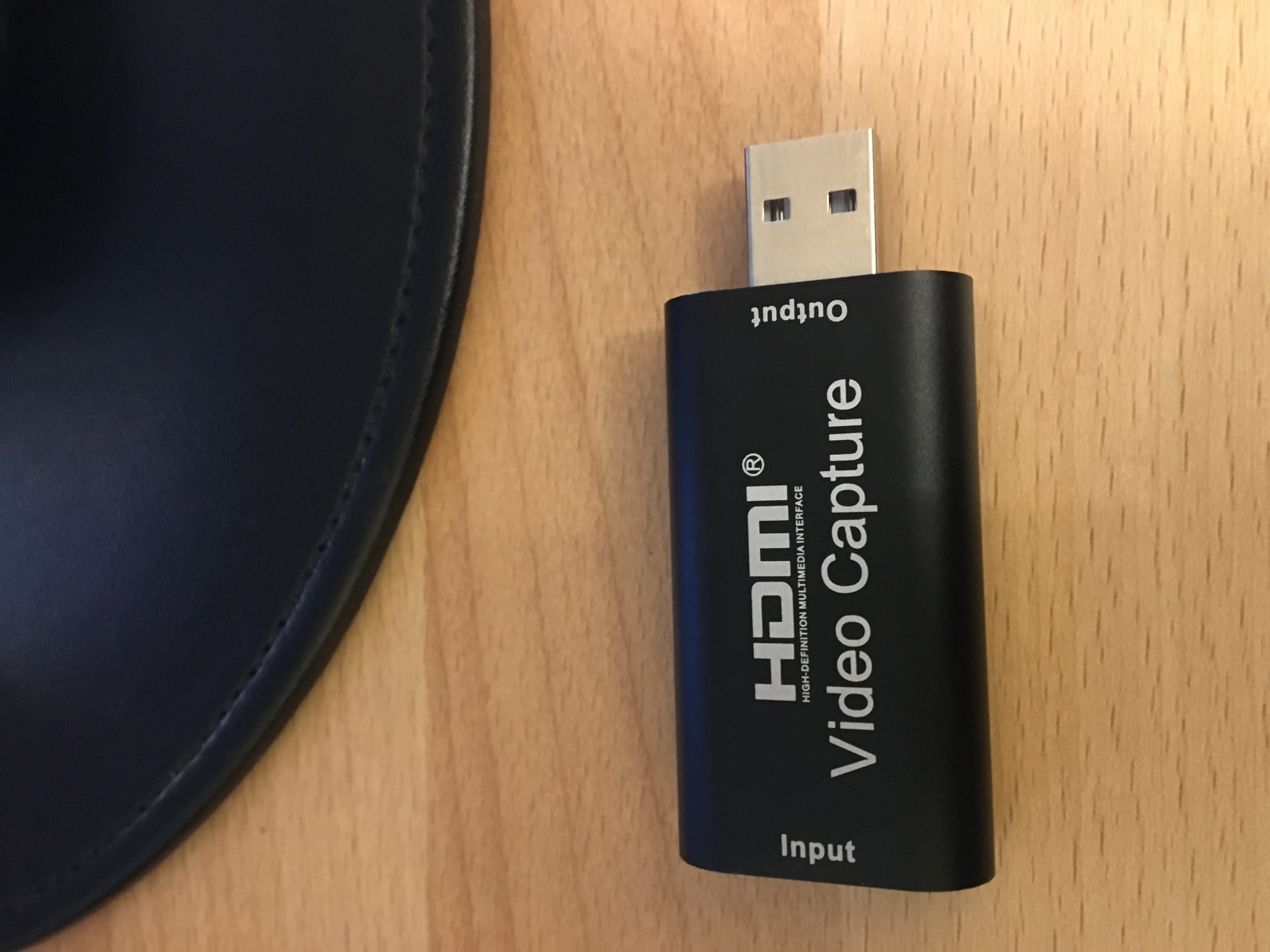

There has been some talk of a cheap HDMI to USB dongle floating about recently.
I purchased one of these to try with the Pi back in April but never got round to it.
Today on plugging it into Portsdown 2020 and selecting video monitor and video and audio monitor on M2 was greeted with pictures and sound.
Source was a freeview box.
Also had some success in getting Portsdown to transmit the HDMI input in video and sound. Selecting source as Comp Vid, and audio in auto or easycap.
I had best success at 8psk., but be warned not many combinations work and a good 2 hours were spent to find some that did.
- IMG_3333.JPG (1.62 MiB) Viewed 7522 times

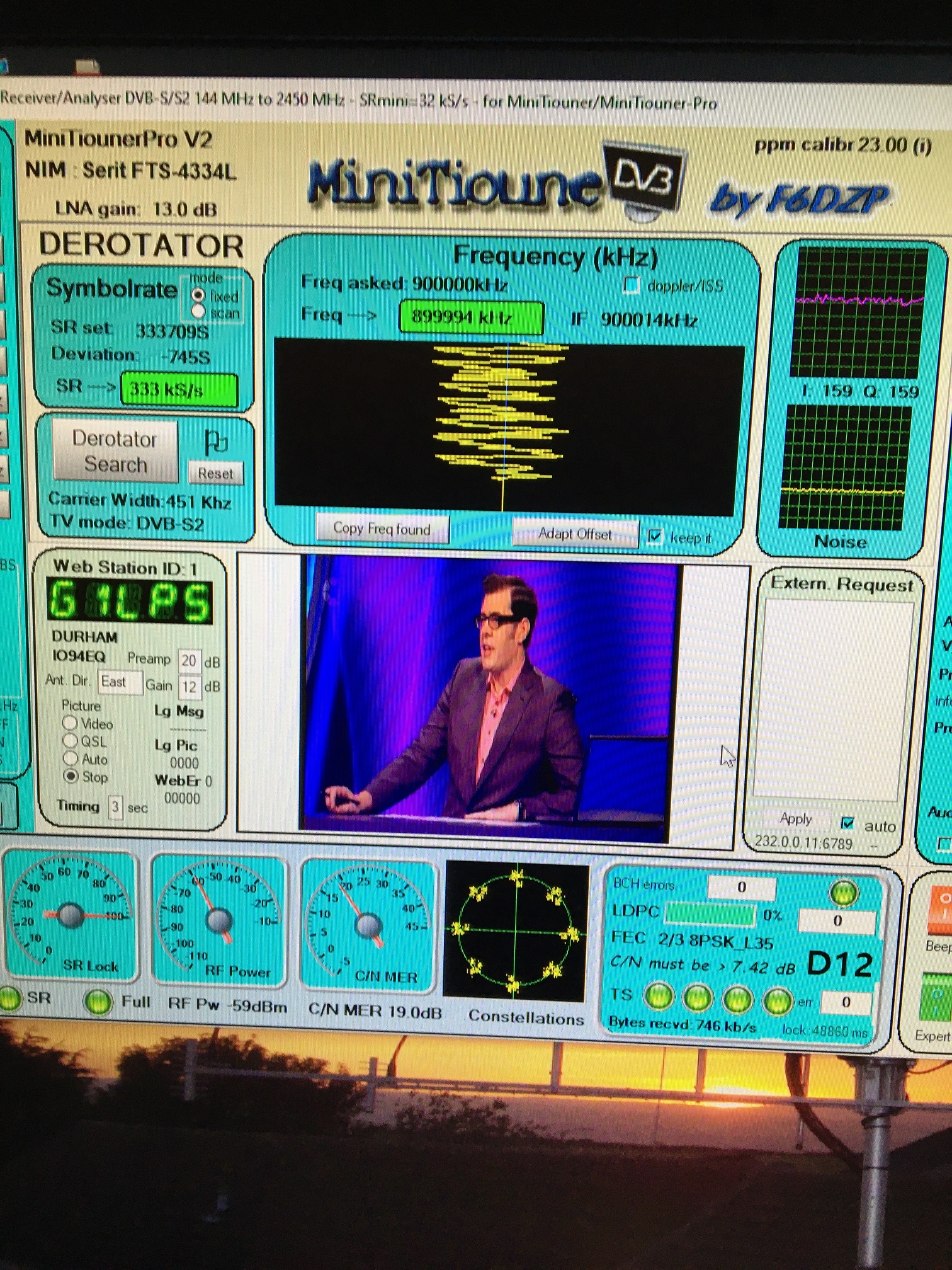

NO ANTENNA ON RX so constalation looks strange. was ok when connected
- IMG_3329.jpg (1.33 MiB) Viewed 7518 times
