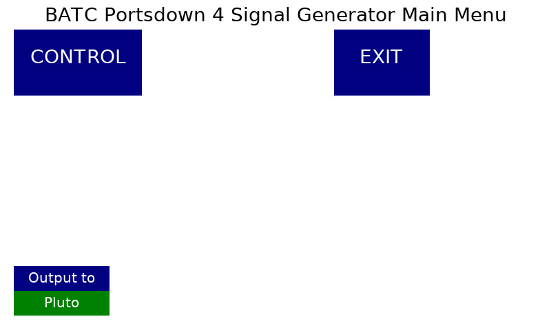

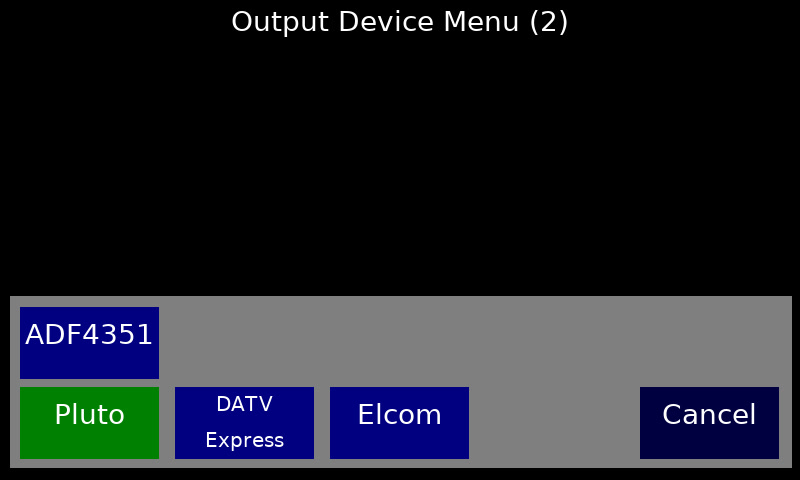

After updating to the latest release (202010120) a Sig Gen button is added to the top line of Menu 2. Selecting this takes you to the Sig Gen Menu. Here you can select the output device to use, a settings menu, or the main control page.

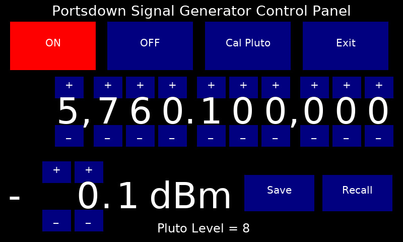

If you have Pluto selected as the output mode, you will need to calibrate it near the output frequency and power that you propose to use. So select those, MAKE SURE THAT NO SENSITIVE DEVICES ARE CONNECTED TO THE PLUTO OUTPUT, and press calibrate. You can then reconnect the output and the risk of power spikes is low after that. Frequency coverage is from 50 MHz to 6 GHz and the selectable output level is from a plus a few dBm right down to about - 70 dBm (both frequency-dependent). The displayed output level is within about 1 dB on my 2 Plutos, and is corrected for the Pluto's frequency response. It is worth rebooting the Pluto (from the settings menu) before and after using it with the signal generator for accuracy and reliability.
Similarly, a DATV Express board can be used as an output device. The frequency range is 70 Mhz to 2450 MHz and the level from about +10 dBm to -30 dBm. No calibration is required and you can apply 333kS QPSK modulation to check PA linearity.
To use an ADF4351 it needs to be connected to the GPIO pins as specified here https://wiki.batc.org.uk/Portsdown_4_GPIO_Connections. It will cover from 35 MHz to 4.4 GHz, but only has 4 output levels, 3 dB spaced, around -5 dBm.
The software will also drive an Elcom Microwave source within its operating range somewhere between 10 GHz and 14 GHz (depending on the model).

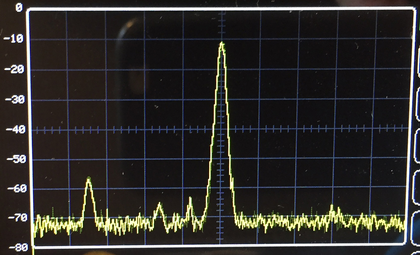

  • The Pluto signal has a spurious 4 MHz below it at about -45 dB and 3 others (2 MHz below, 1 MHz below and 2 MHz above) at about -55 dB. Spectrum at 0 dBm 437 MHz shown below.
Pluto 437 0dBm.JPG (323.3 KiB) Viewed 2854 times
