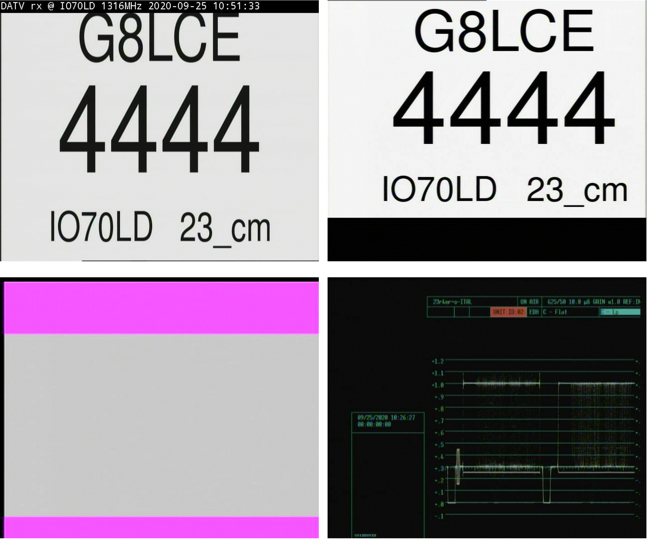

Post by g8lce » Sat Sep 26, 2020 7:03 pm
I have three DATV receivers monitoring on one web page. When I transmit from my Portsdown 4 the contest numbers they show a black line on the bottom of the commercial RX, nothing apart from a pink band on my Echostar 3000 but are OK on my Comag SL60.

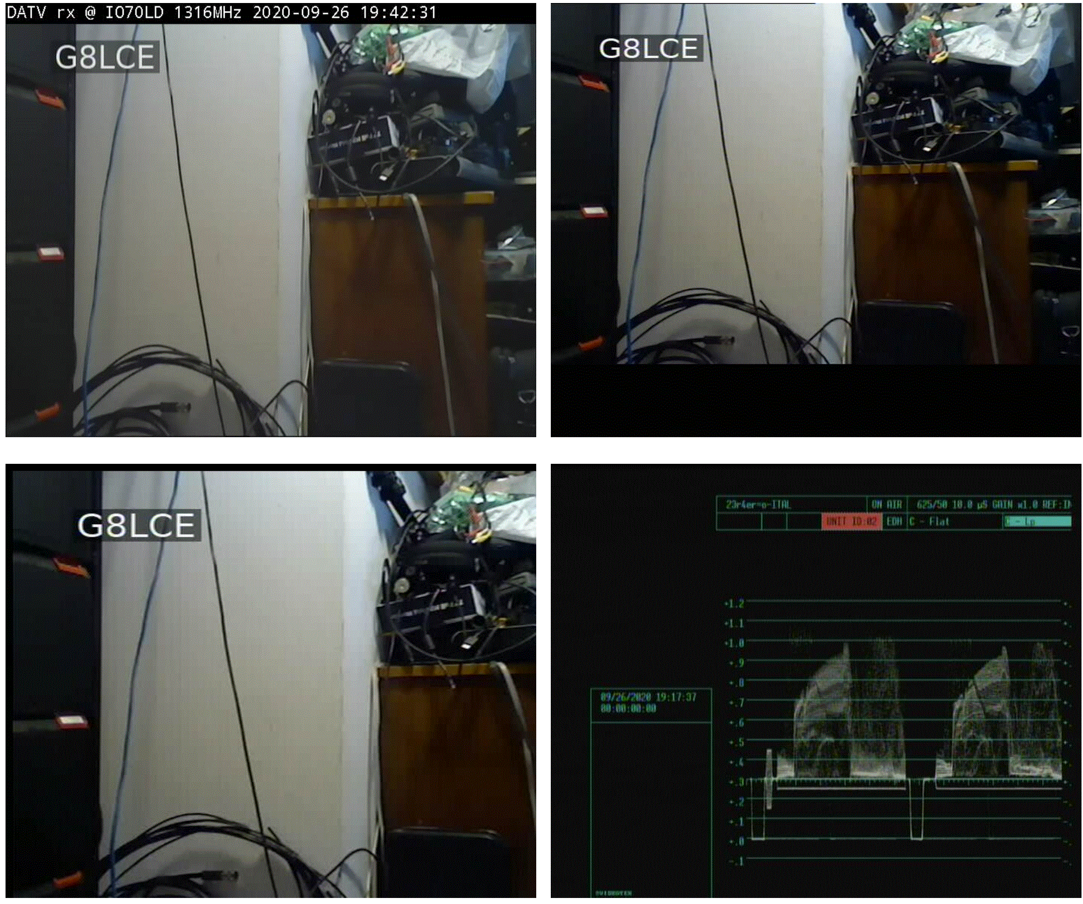

I also found that pluging in an old webcam it worked when I selected compvideo as source!!
webcam not compvid.GIF (1.38 MiB) Viewed 2308 times
I know the webcam is not supported (a logitech 3000 ) but it has the same black band on the Tanberg Alteria commercial RX

Post by G8GKQ » Sat Sep 26, 2020 8:21 pm
  • The Black line is down to how your receivers choose to display an image that is not the same aspect ratio as their display. The Comag expands it to fill the screen, and the (very old) Altea RX fills the longest dimension and keeps the pixels square, then fills the remaining space with black.
  • The missing picture on the Echostar is because the transmitted digital bitstream from the Contest Caption is not perfect, and the Echostar can't cope with the minor errors.
  • The switching between sources on the Portsdown is easily confused, particularly if you connect video sources after boot. It does not support "hot-plugging". MPEG-2 encoding is more tolerant of non-supported cameras than H264.
