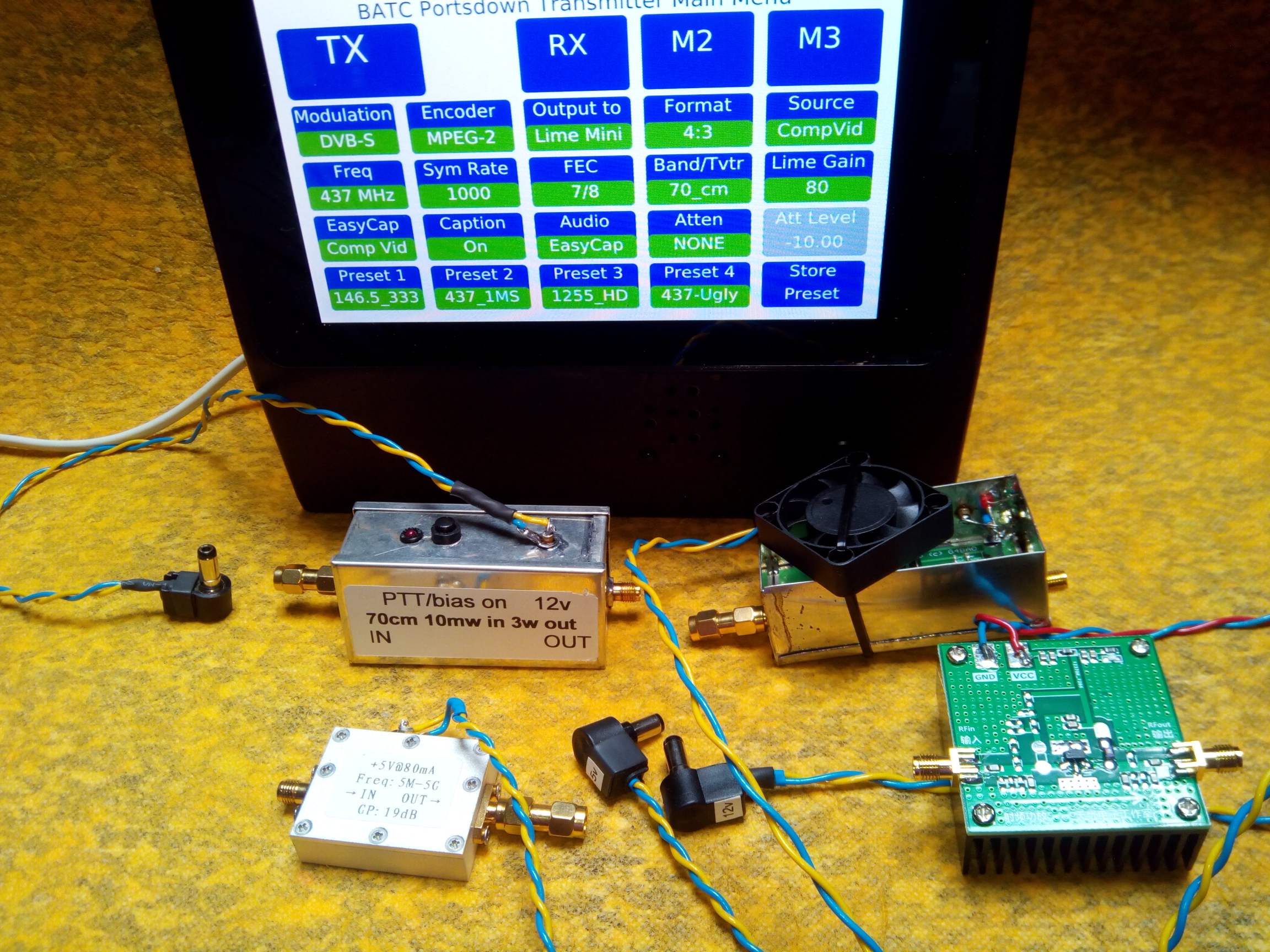

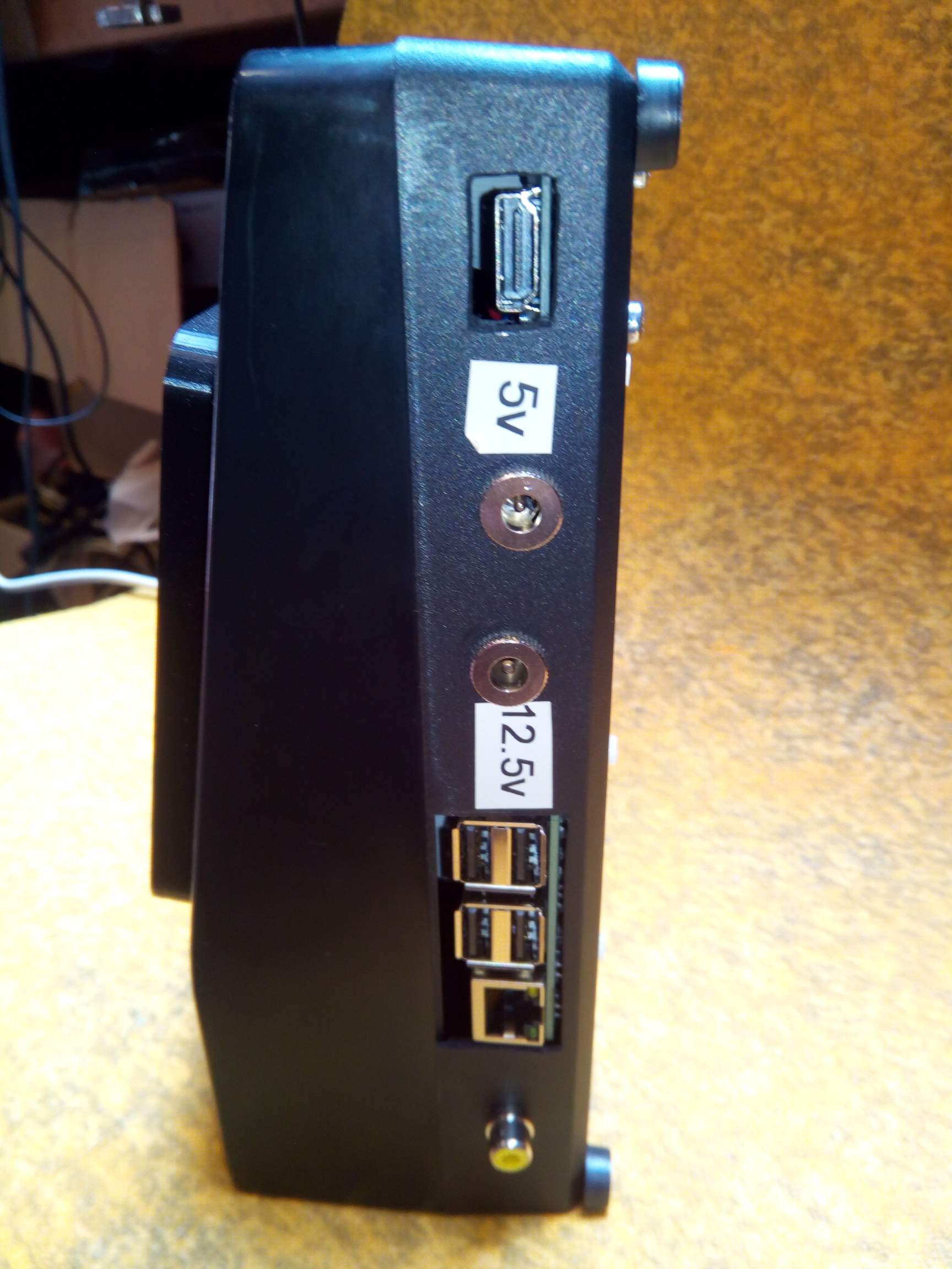

Both the 5V out & 12v Buck out, are on side of case for powering those little Chinese amps. or BAO 23cm & 70cm.

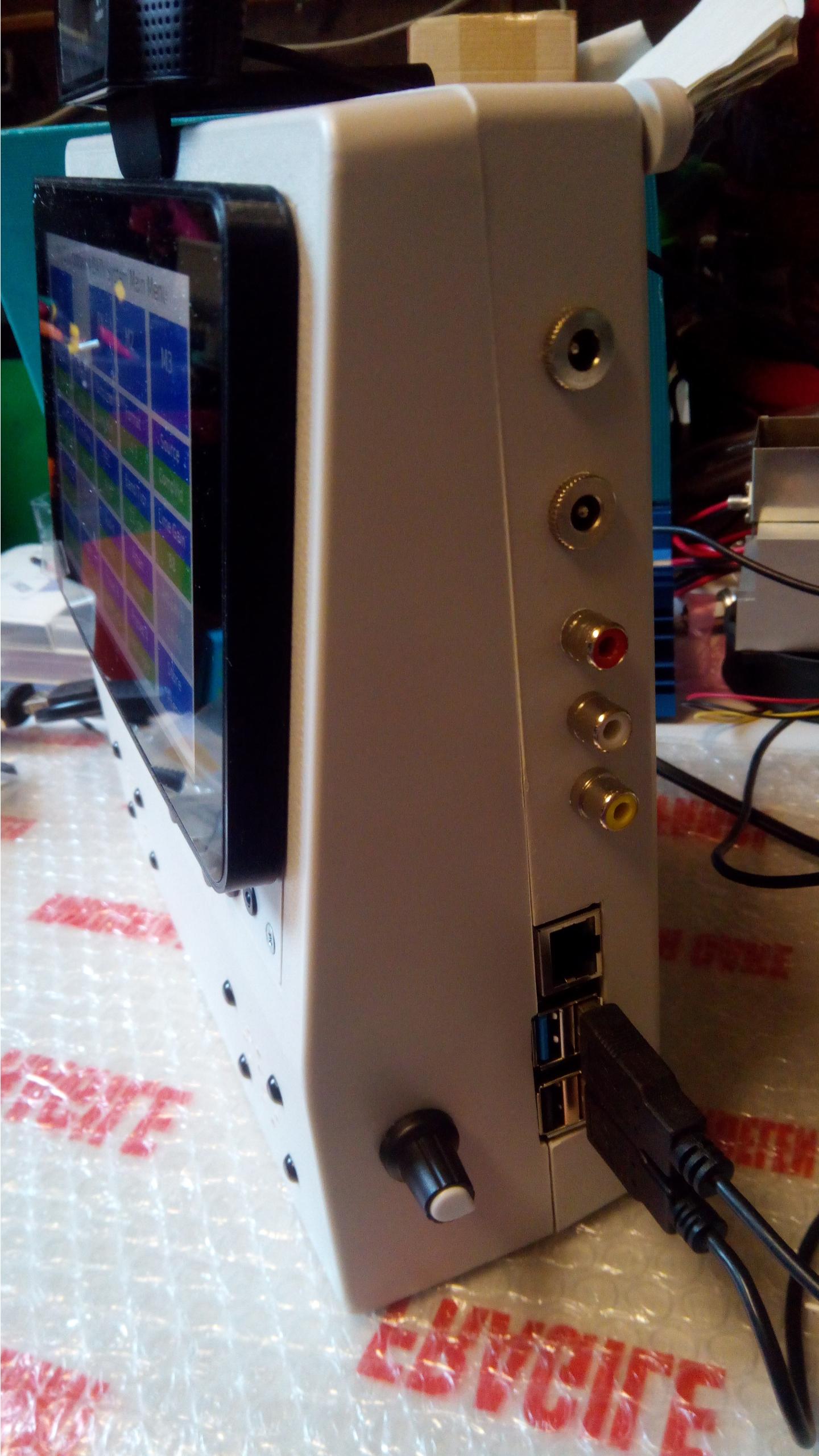

1st photo is of it laid in "laid down mode"
2nd photo shows interface sockets on side
3rd photo shows it stood up "on its back edge"

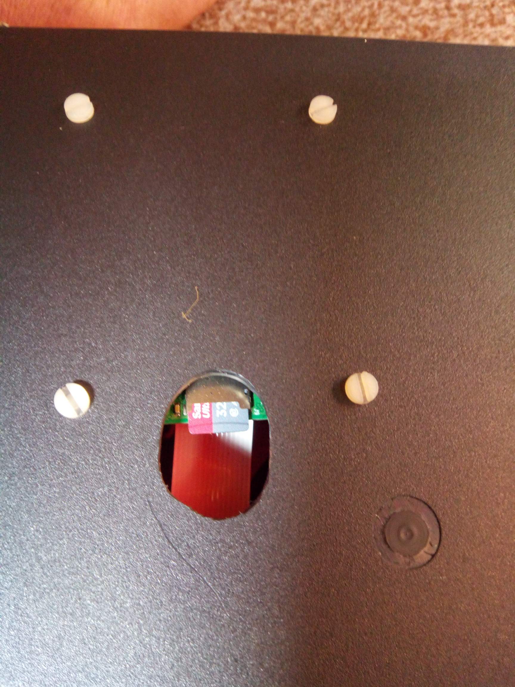

4th photo shows access to the tricky little thingy SD card.

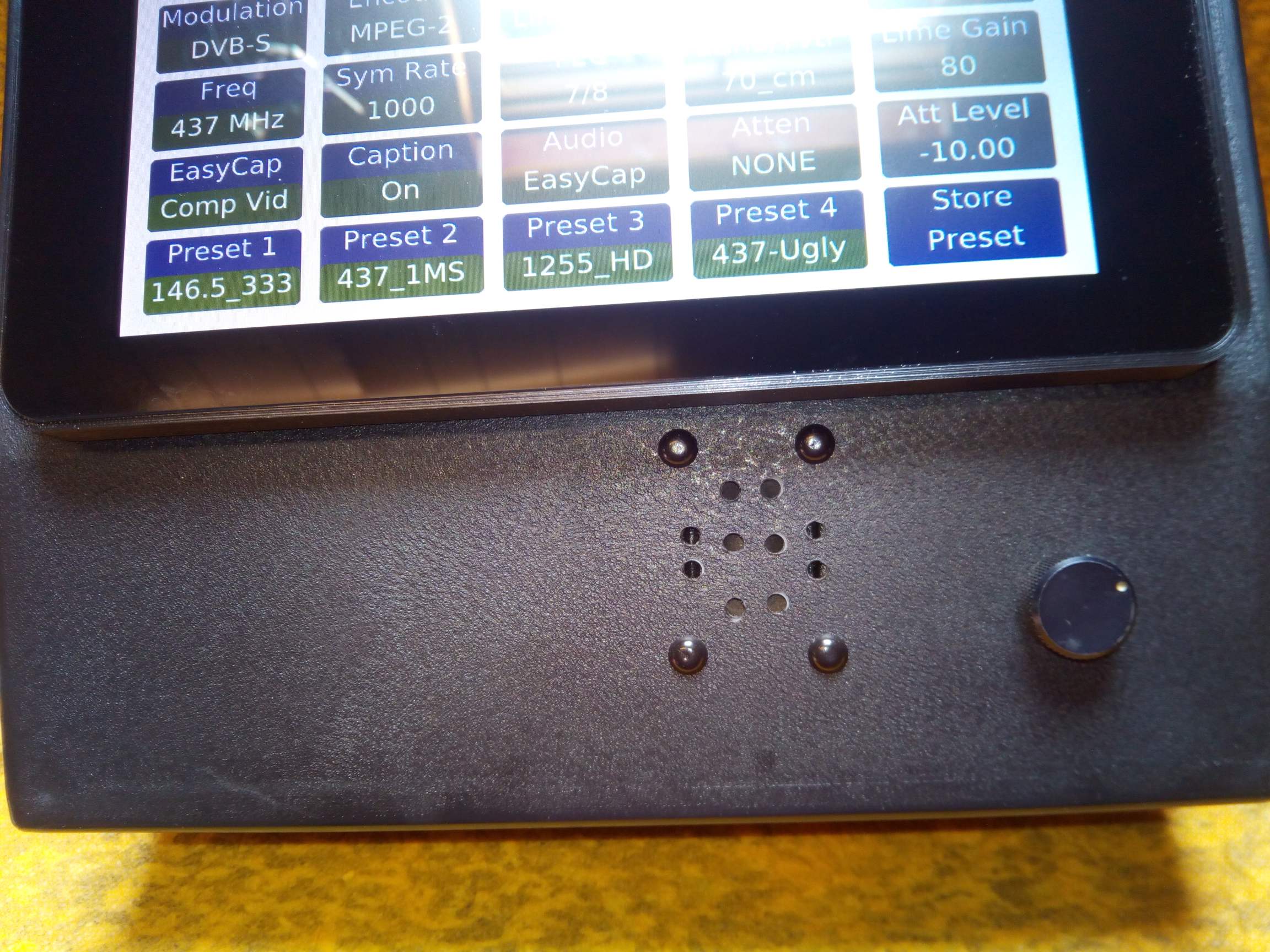

5th photo shows speaker and vol control.

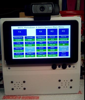

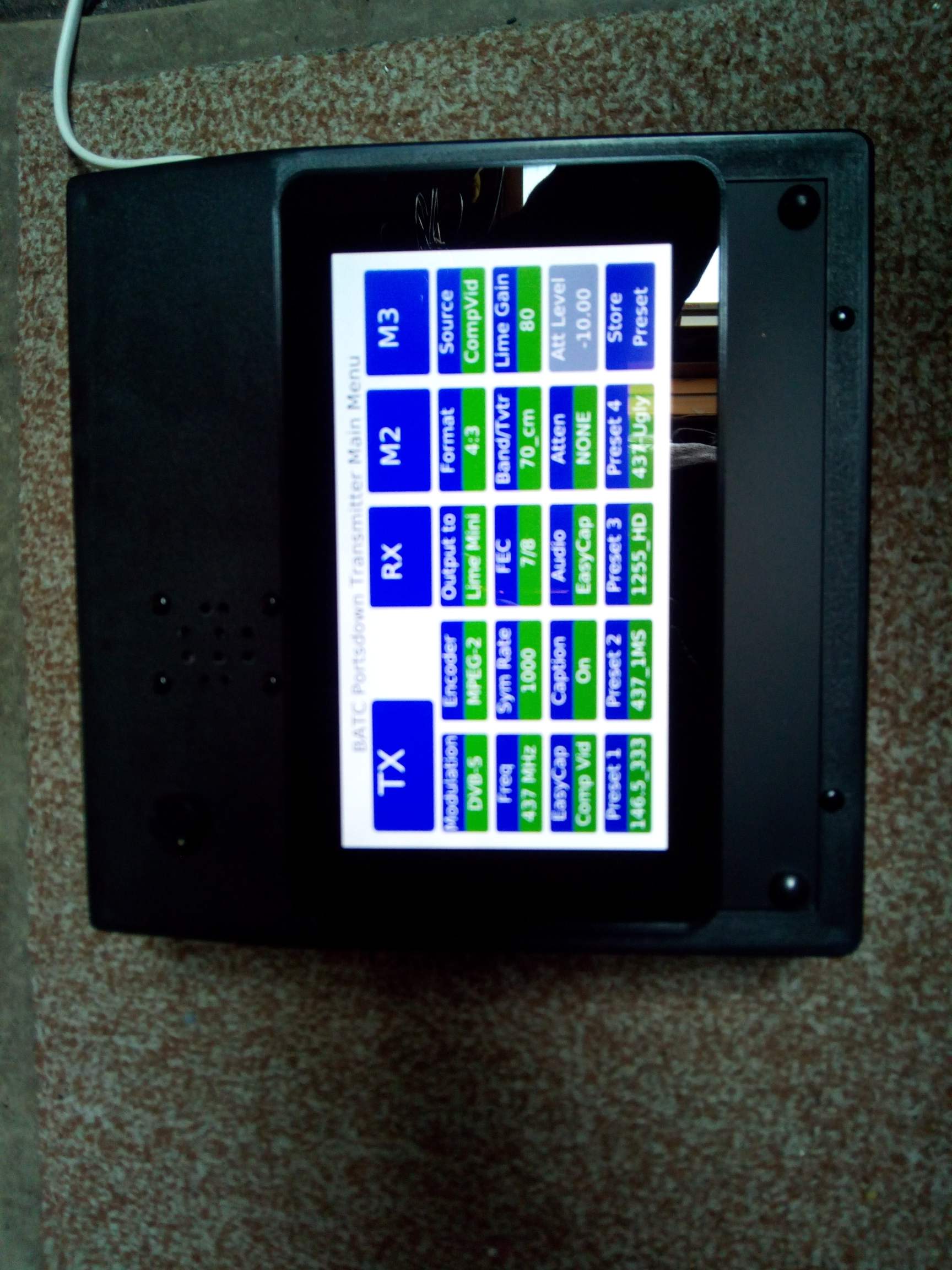

My Portsdown Pi4 build
It similar to the one I posted further up (black case with a Pi3B+ .
This one with Pi4 is Same case but in grey. I added stereo amplifier this time and x 2 speakers
The 2 buttons just under screen turn on 12v and 5v outputs to side of case for powering external small amplifiers
The C920 webcam sits nicely on top.
