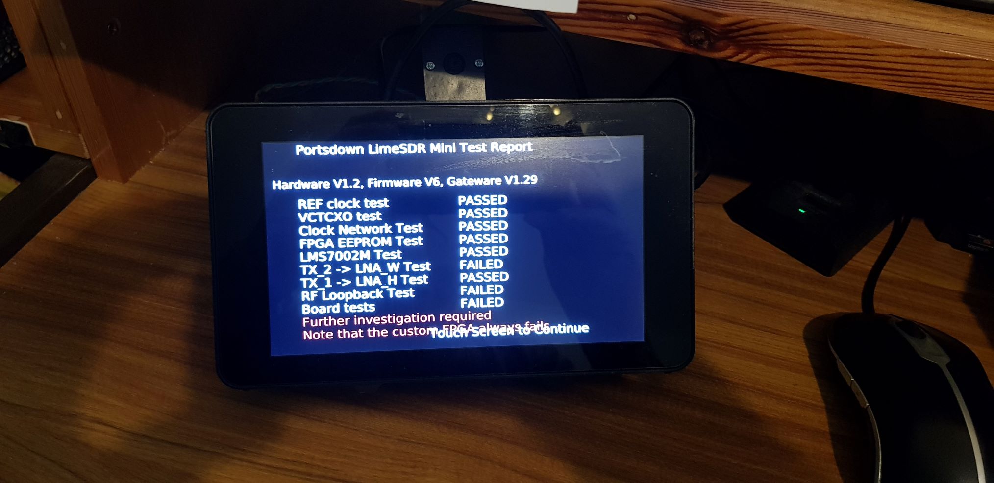

Hi Dave,
Programmed the SD all OK
Updated the Lime Mini to LIME-DVB firmware.
Could not get the lime to drive my amplifies.
I managed to see a poor signal locally as though it was very low power from lime.
Also tried the 1.29 and 1.30 with same results.
The Lime Test Report had three failures.
Also couldn't change memory 1
I have put my original SD card back all now working.
Sorry I failed now time to sit in dark room.
