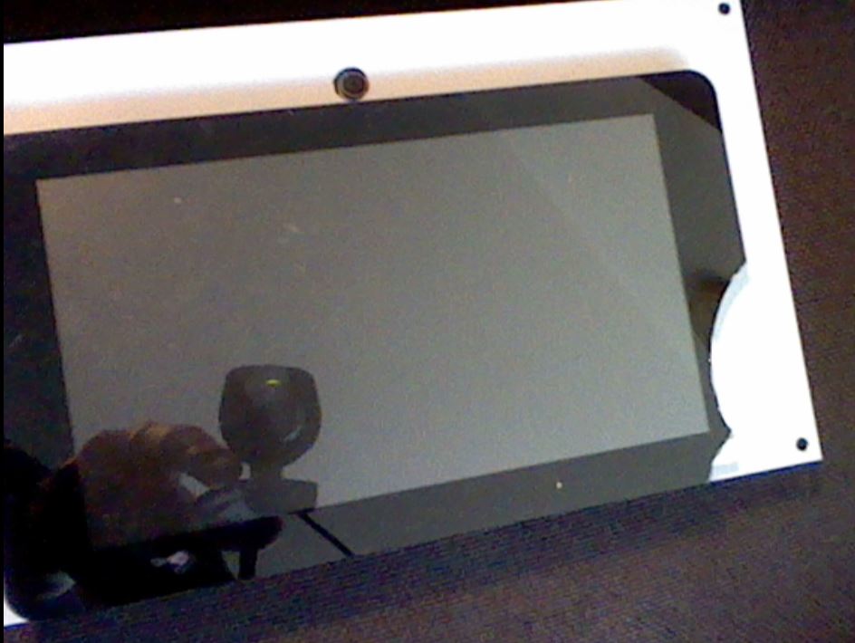

This one still works even though it has had a byte taken out of it!!
Martin G8LCE

Thought Id give an update on my fiddling with this issue. The new 7" screen was fine till I boxed up the project. I have a 4U rack box and mounted a 70cms linear in the same box. When I tx with the linear on the touch screen looses its touch function. This seems to be rf on the ribbon cable between the screen and the pi that stops the screen working. I re-routed the amplifier output cable and the issue doesn't now happen. So if you screen behaves erratically it could be this issue. I do like the bitten Screen!
