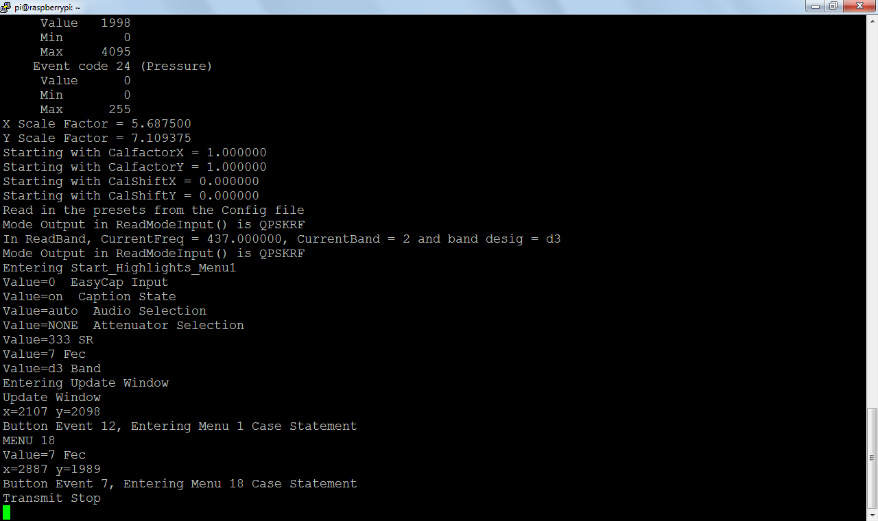

When I press the button for FEC 3/4, the terminal screen clears and goes back to the command prompt. I just managed to capture it before it cleared.
I can type gui again to restart it.
Thanks.

Posts: 3028
Re: Portsdown Software Update 201912100
Post by G8GKQ » Wed Dec 25, 2019 5:59 pm
Hi Brian
Looks like a problem writing to the config file. Please try:
Code: Select all
ls -l ~/rpidatv/scripts/portsdown*
and
Code: Select all
df -h
and post the results here.
Posts: 1530
Post by G4EWJ » Wed Dec 25, 2019 10:08 pm
The files have only root write permissions. I think I must have done a sudo su as an automatic reaction after logging in.
I've started again from scratch and I can change settings now. I'll try it on tranmit tomorrow. Apologies and thanks for your help.
