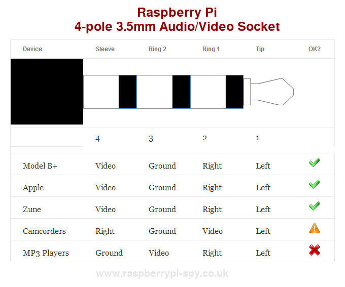

There are statements in software release notes that composite video out to a FM transmitter or analogue display is now possible with a 7" screen fitted. I can see that there's a button for it in the new screen setup menu too. What are the wiring connections please? The screen has to use the video and audio output socket so from where does the composite video output come?

Hi David I use the 3.5mm AV jack on the RPI to get the audio and video its a 4 ring plug see the picture below
Hope that helps John G7JTT

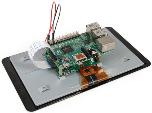

I'm slightly confused at your statement. The recommended 7 inch screen only needs to connect to the CSI socket (by ribbon cable) on the RPi board. See picture below. The only other connections required are Gnd and +5v.
7 inch.jpg (45.47 KiB) Viewed 2761 times
