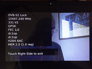

I have just released an update to the Portsdown software which significantly improves the useability of the LongMynd receiver. Thanks to Phil M0DNY it now displays: Modulation Mode, FEC, Program Name, Service Provider, Audio and video encoding types, and (for DVB-S2 only) MER.
RX Parameters.jpg (28.03 KiB) Viewed 6923 times
