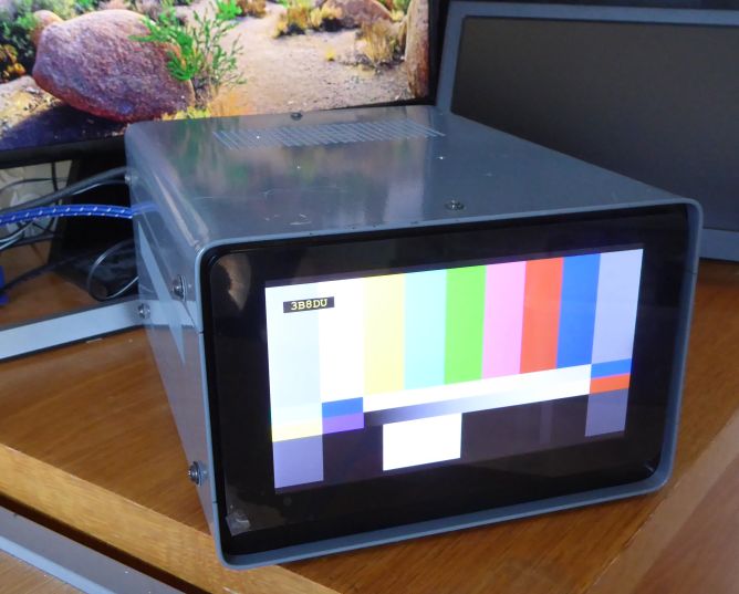

Mine is working now - I have the 7" screen, a minitiouner and a LimeNet Micro in the box, along with PSU and a USB hub. I was just looking at implementing an audio amplifier until I realised I could get one from Ebay for £2.
