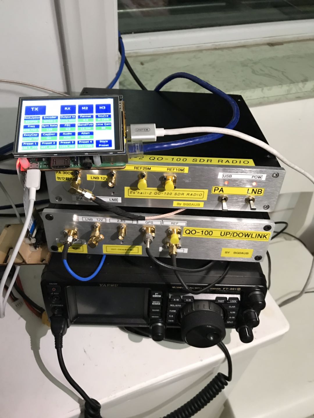

hello
I am BG0AUB. Recently I built portsdown2019, this is a great project.Easy to use DATV.I tested limesdr mini + portsdown2019 QO100 repeater.His work is very good.It's very convenient.But I find that if I set of DVB - S2 QPSK H264 mode.Limesdr mini did not produce the correct spectrum.If when the SR low, will produce a larger peak at the center of the frequency point.The SR is high, he what also have no output.I consulted another article about H264 don't work in the BBS posts, and repeatedly in different SD card to recompile the portsdown2019.The phenomenon still exists.

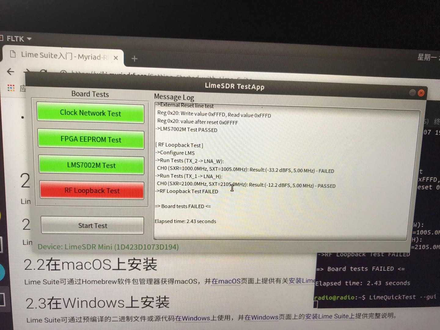

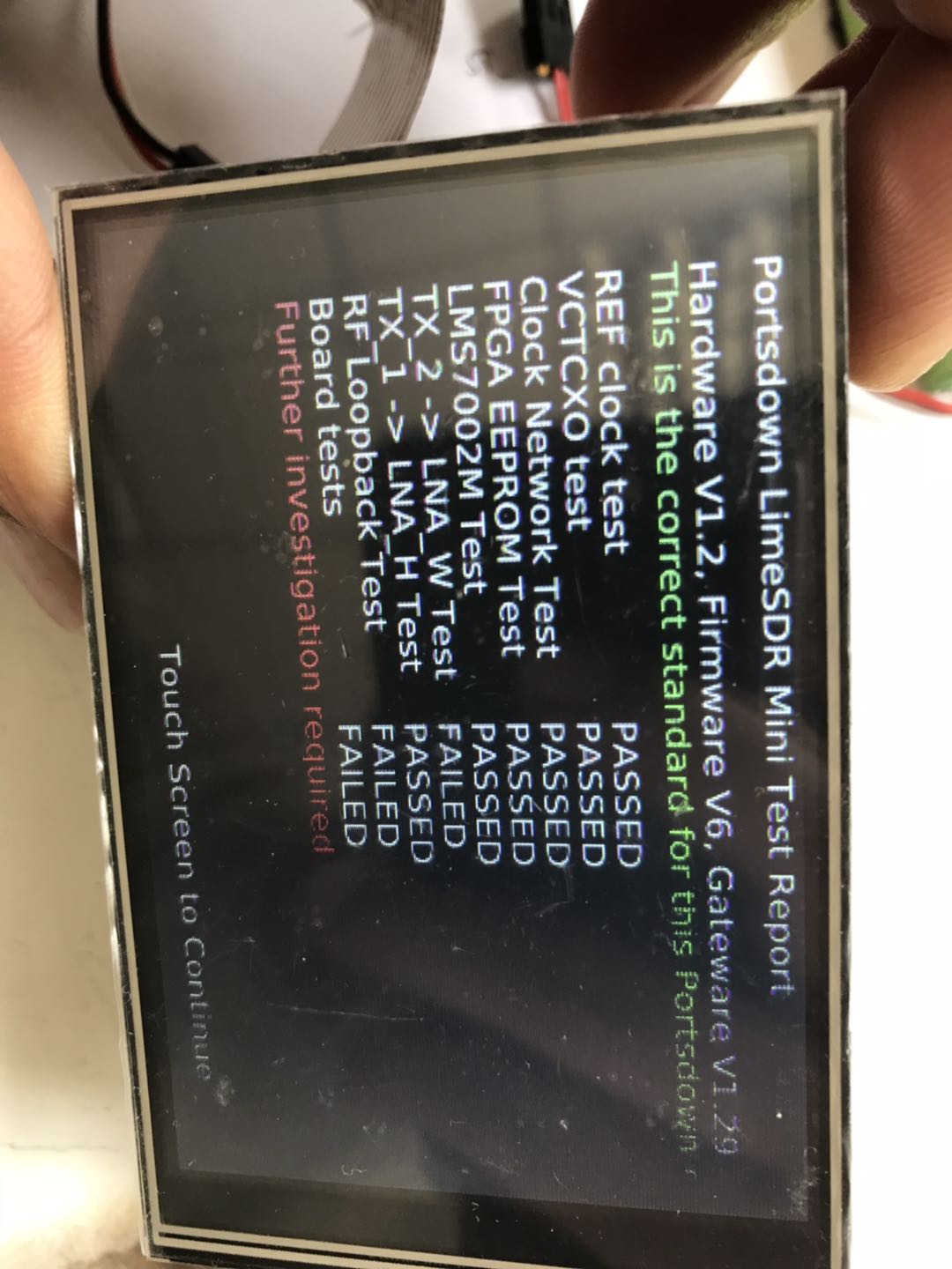

Hi
The report on your second picture shows that your LimeSDR is failing the LimeQuickTest. More details here: https://wiki.myriadrf.org/Testing_the_LimeSDR. So that is a LimeSDR problem, not a Portsdown problem. Some LimeSDRs fail this test (by a small tolerance) but still work perfectly.

The loop test of limesdr using PC software still failed.It seems there is a limesdr problem.In Ugly mode.Should h264 be working?
Re: Portsdown2019 H264 mode will not work
Posted: Tue Jul 09, 2019 11:21 am
by BG0AUB
Limequicktest loop test prompt failed because tx_2-lna_w. Limesdr mini has only one TX interface.Tx1. All of the following pass the test.I don't know if everyone has this problem.Maybe I misunderstood

LimeQuickTest works on all the LimeSDR Minis that I have.
