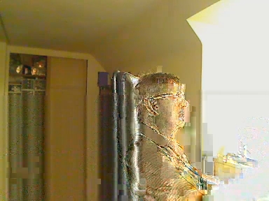

I have finally got the vMix output to talk to the Portsdown 2019 (thanks Dave) over my local network. But the transmitted pics received on my MiniTune RX are blocky in the extreme and, no matter what adjustments I make to vMix settings nothing makes any difference.
The Portsdown is working fine and sends the built-in test pics, as well as inputs from my camcorder – via an EasyCap capture device – without problems so, suspecting that the BATC Wiki info may be out of date for the 2019 version, I need to communicate with someone who is successfully using the 2019 Portsdown with latest software and the current version of vMix.
I have been using both the original Batch file and the later H264 version from the Wiki. With both, using 1000kS, the signal sometimes locks initially then cuts out and tries to lock again…etc. Using 333kS is much better although the pictures often start to appear (top quarter) but then they freeze and get blocky and very jerky.

I have exactly the same problem, but maybe worse as the video usually freezes like in the above picture - have tried reducing the resolution as suggested but when I turn the output on I get "capture device is still in, close any open programs and try again'.
No error messages in the batch file window
Output #0, mpegts, to 'udp://192.168.1.8:10000?pkt_size=1316':
Metadata:
service_provider: BATC
service_name : G4WIM
encoder : Lavf58.27.103
Stream #0:0: Video: h264 (libx264), yuv420p(progressive), 768x576 [SAR 1:1 DAR 4:3], q=2-35, 428 kb/s, 25 fps, 90k tbn, 25 tbc
Metadata:
encoder : Lavc58.52.101 libx264
Side data:
cpb: bitrate max/min/avg: 428000/0/428000 buffer size: 857000 vbv_delay: -1
Stream #0:1: Audio: aac (LC), 48000 Hz, stereo, fltp, 128 kb/s
Metadata:
encoder : Lavc58.52.101 aac
frame=20605 fps= 14 q=22.0 size= 94621kB time=00:25:00.16 bitrate= 516.7kbits/s speed= 1x
I always seem to have problems ffmpeg !

G4WIM - you have illustrated the problem exactly, in fact your pic is a bit better than mine. I have found that by using vMix colour bars as an input they mostly come out right! is this a pointer to a difference it outputting colour bars rather that a picture, either video or photo?
