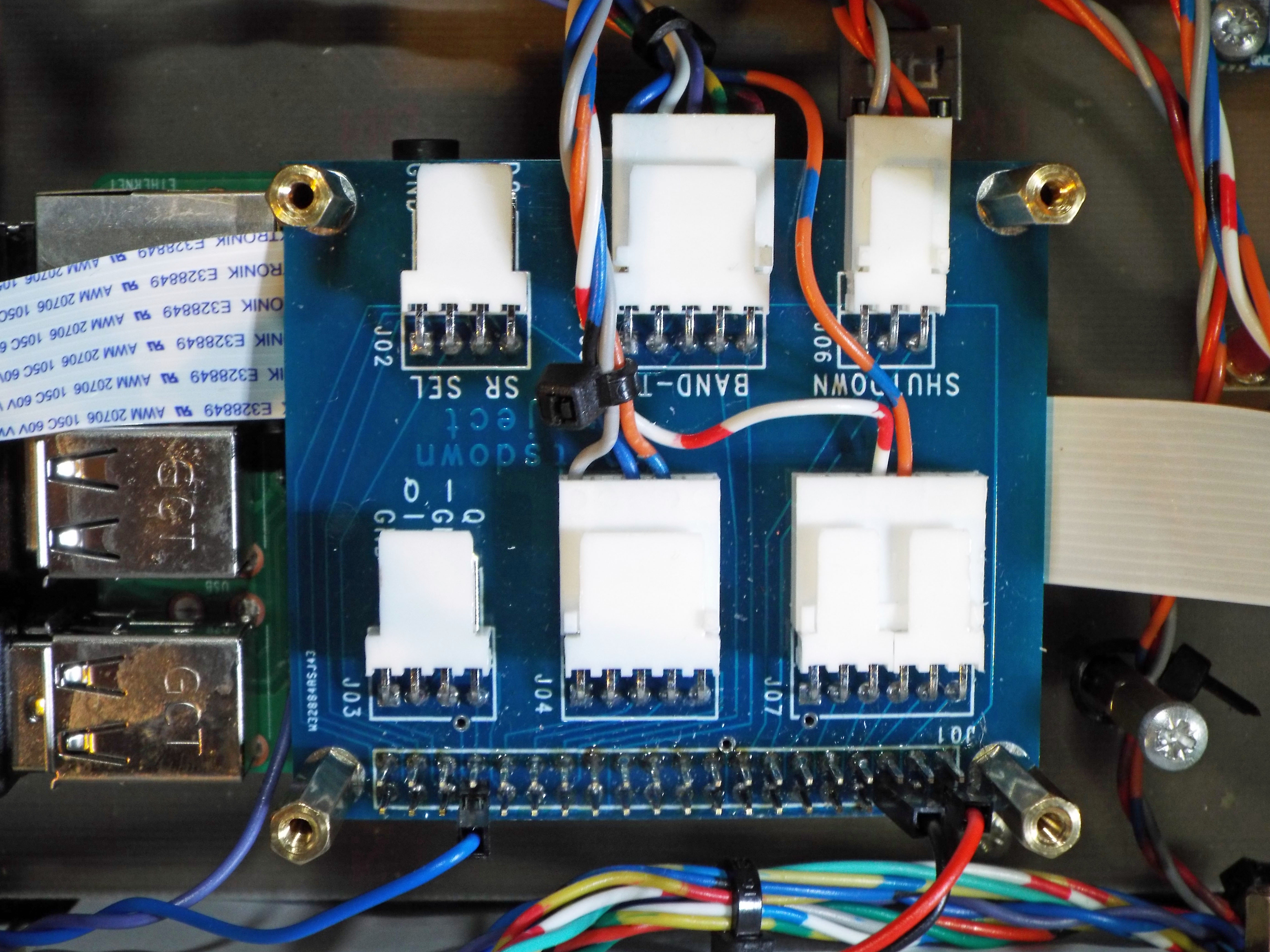

Although I bought a header for the Lime Mini I did not fit it as I decided not to risk the most expensive part of the build.
You can use the connections on the GPIO board for all switching.
The connection labeled TX LED on J05 should be connected to PTT on J1 of the 8 Band Decode board.
The attached photo shows what connections will be required on the GPIO board if you are using the 8 Way Band Decode board and the RF Attenuator board. All connections on J05 are used - they don't show up very good in the photo.
Regards,
Nick - G4NKV
GPIO Board Connections.
GPIO Board Connections..jpg (1.58 MiB) Viewed 4335 times

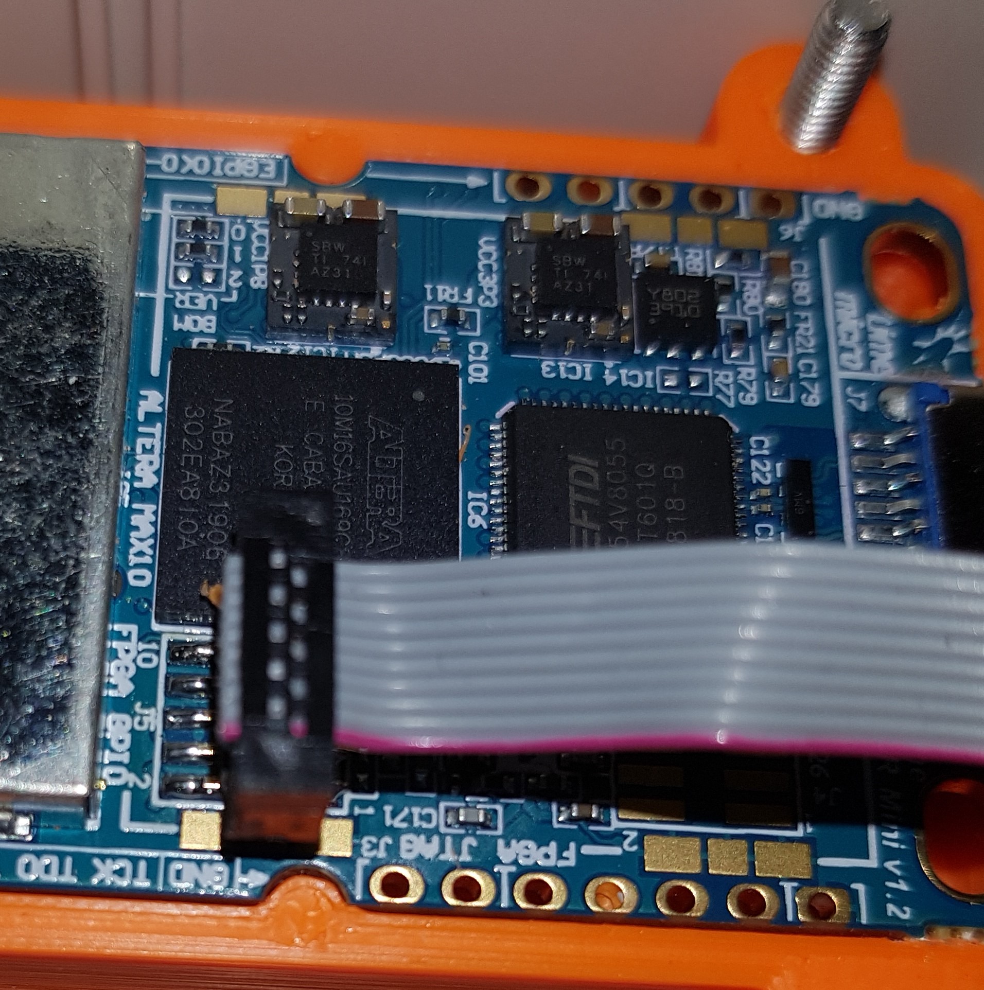

I have actually soldered on a header on to my Lime having studied the wiring layout, and seeing this done in pictures on the forum.
Having then read the text the layout drawing did not make sense.

As there are many possible configurations for Portsdown 2019, so we have not drawn a detailed interconnect and power supply wiring diagram.
My recommendation is that you use the TX and Band switching lines from the Raspberry Pi GPIO (using the BATC board) to drive the 8-way (or 4-way) switch. This is because it is not easy to connect wires to the LimeSDR Mini and a lot more expensive if you accidentally apply voltages to the lines (which will blow up the FPGA on the Lime) or slip with the soldering iron (£170 vs £40).
I apologise for mixing up my terminology, I have occasionally referred to the TX line (which goes to 3.3v when the TX PA should be switched on) as the PTT or TX LED line. Inside the Portsdown system, the 2 are the same. Once you are beyond the opto-isolator and out into your shack, they have different definitions.
