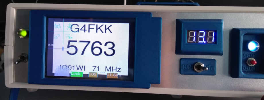

Managed my/our first DATV contact yesterday on 4M with Martin, G4FKK. Using the Portsdown LeanDVB RX and 250KS we managed two way P5 :-)

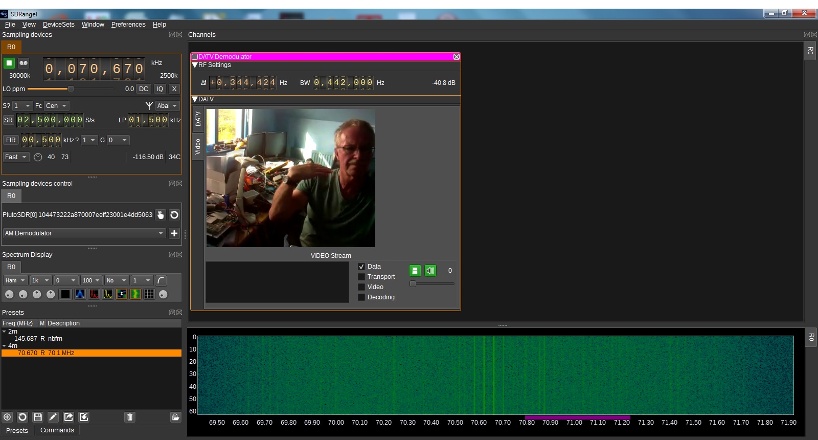

As an experiment I asked Martin if he could try his Pluto direct to aerial as he was already using it to monitor his own transmission. Running with SDRAngel he reported almost instant lock and we also managed 500KS pictures. Without any filtering (other than a 5 element beam) or preamps I am impressed by this. Certainly worth exploring as a suitable RX for 4M as it saves messing with upconverters. There's even a how-to video on setting up SDRAngel on youtube here: https://www.youtube.com/watch?v=Bb8S_J9peD8
Thanks for the software :-)
