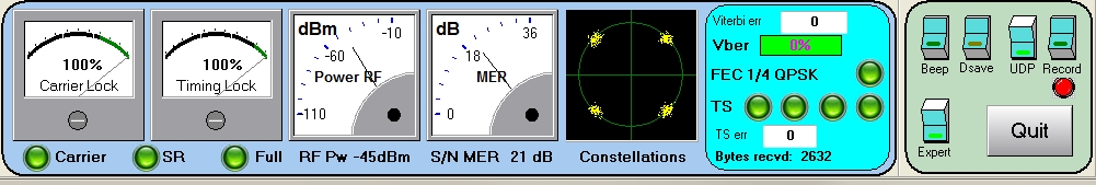

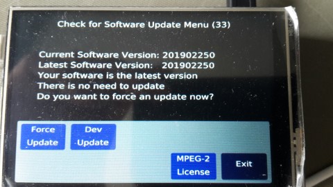

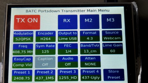

Referring to our QO-100 chat regarding 1/4FEC
PD settings with webcam C270, Lime connected to a powered USB hub
UDP: VLC and Dektec StreamXpert no video/service
FEC: 1/2 and 3/4 no problem

Posts: 3028
Re: Portsdown Stretch 2019 Software Update 201902250
Post by G8GKQ » Thu Mar 14, 2019 12:59 pm
Hi
There are some issues related to LimeSDR bitrate calculations in the current build. But 125KS FEC 1/4 is such an extreme setting that I had not tested it as I had not expected it to work.
Also, I do not have a C270 to test with which does not help.
I have checked the calculations for 125KS FEC 1/4 and the TS bitrate is 57598 bits/sec giving a video bitrate of 33198 bits/sec. Not much!
I'd be interested to know whether it works at 250KS?
