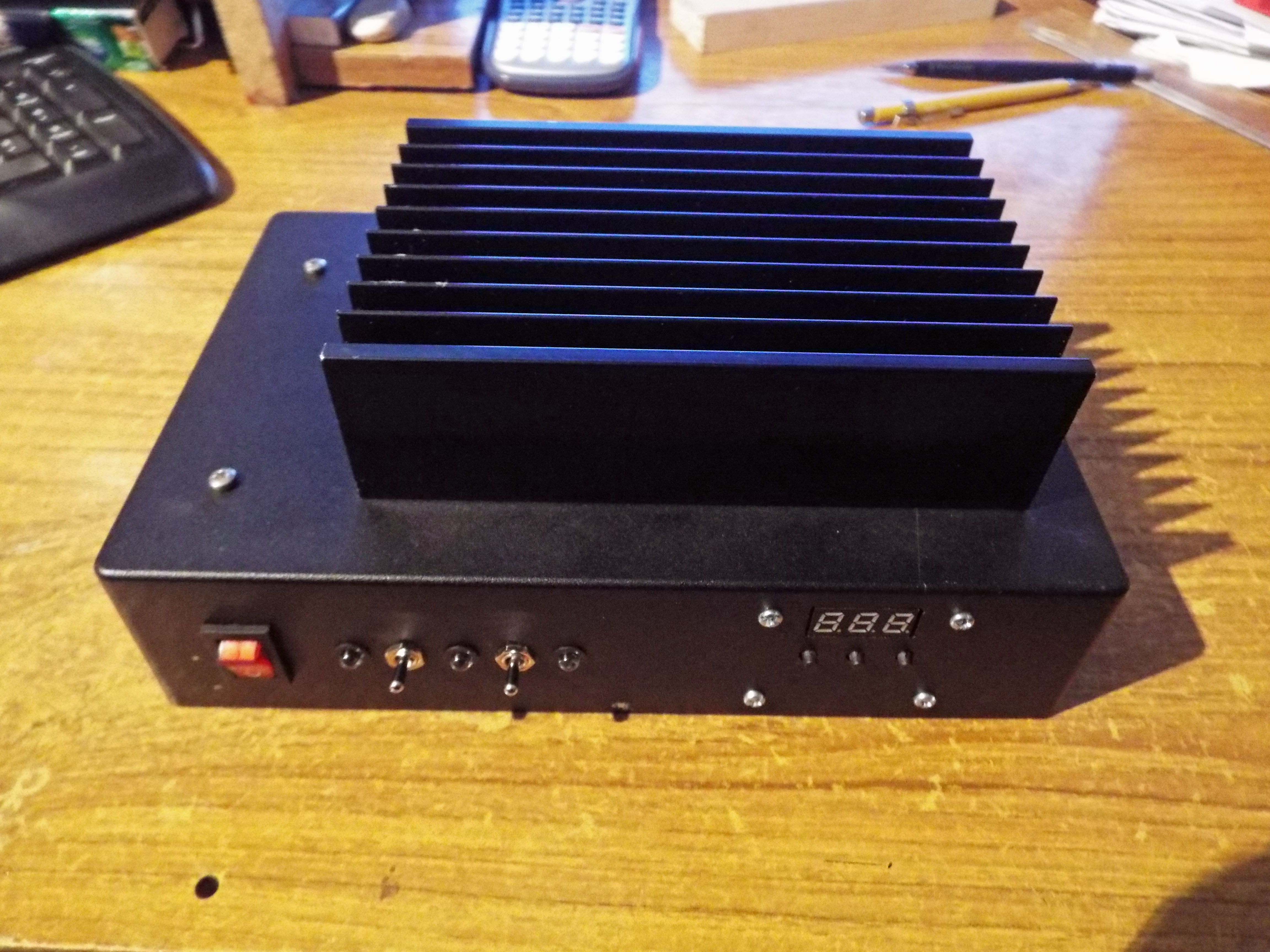

The heatsink is from RS - part 169-4252 - see attached photos.

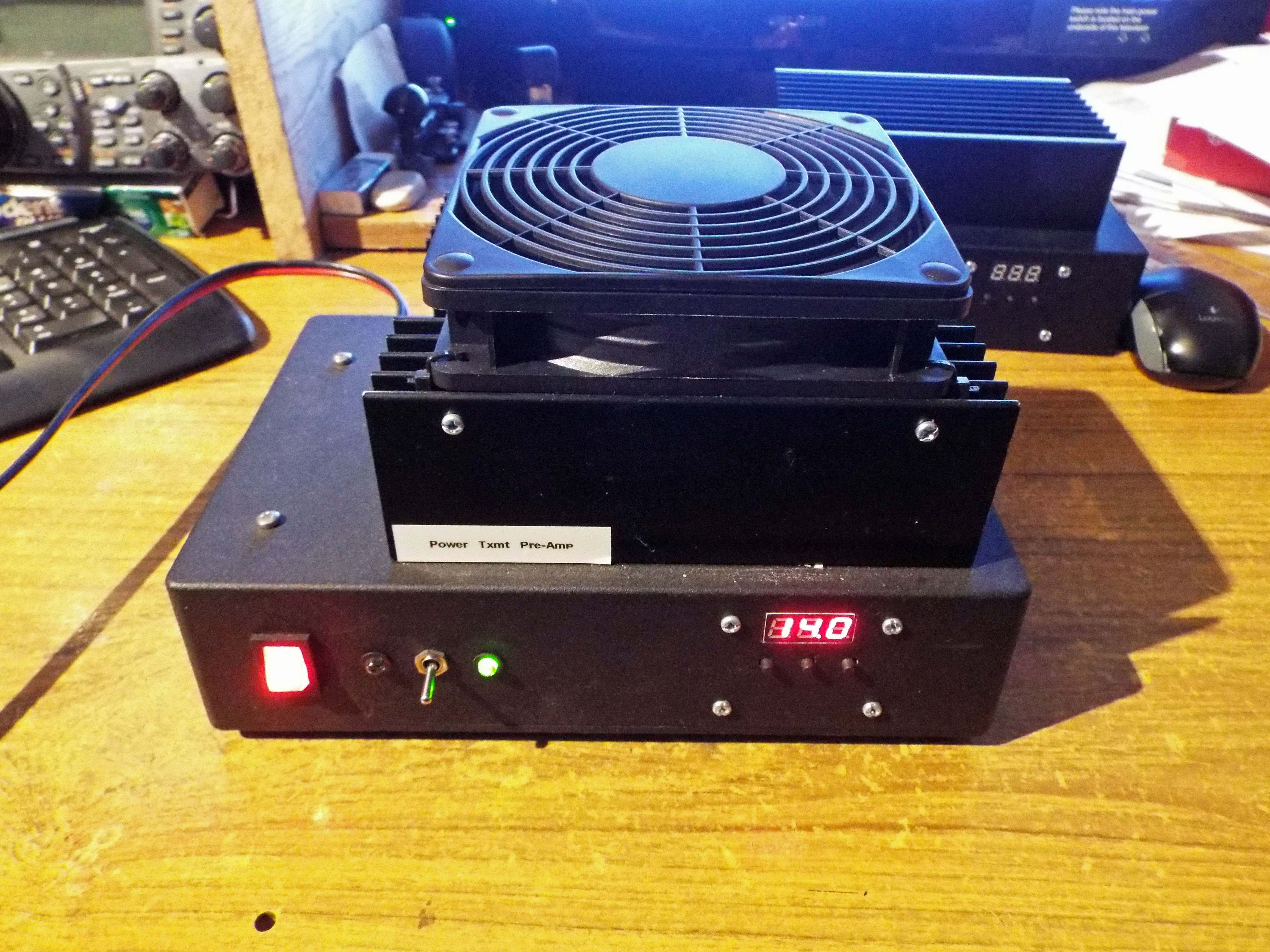

It does not have the fan fitted yet, but this will be done the same way as the on on my 2Mtr amp - see photo.

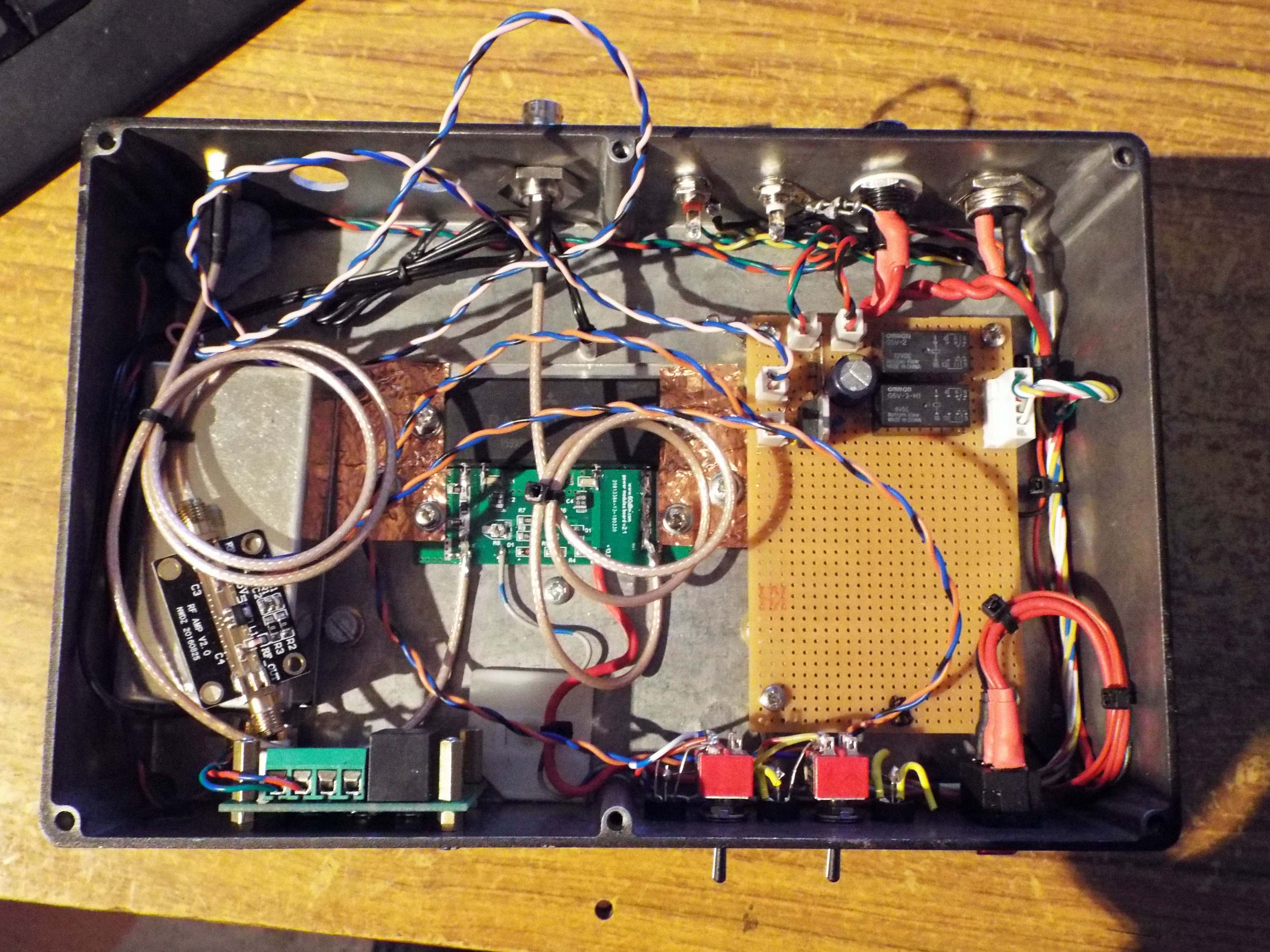

I have fitted a temperature indicator/controller on these amplifiers - you can see the temperature sensor on the internal view of the amplifier just above the RF module (it's a mess at the moment as the RF switching relays are not yet fitted). The temperature controller is mounted on the front panel - this was obtained from E-Bay.
I have set the fan to run at low speed all the time, and to only go to full speed if the temperature goes above 45 C. So far, on the 2Mtr version, it has not had to go to full speed.
Nick -G4NKV
- 2Mtr Amplifier.
- 2Mtr Amp.jpg (1.26 MiB) Viewed 6858 times
- 23cms External View.
- 23cms Amp External.jpg (1.69 MiB) Viewed 6858 times
- 23cms not yet finished internal view.
- 23cms Amp Internal.jpg (1.41 MiB) Viewed 6858 times
