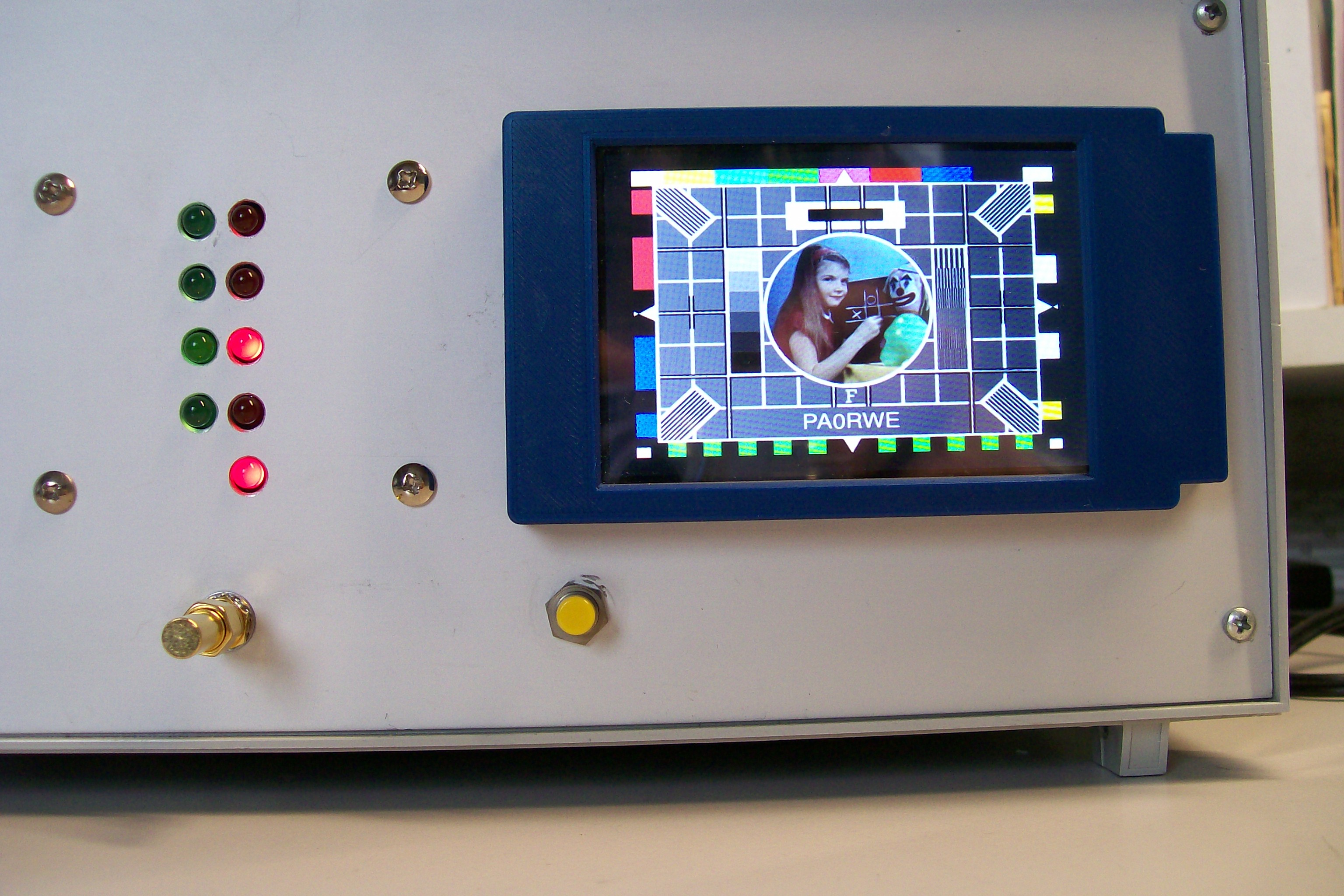

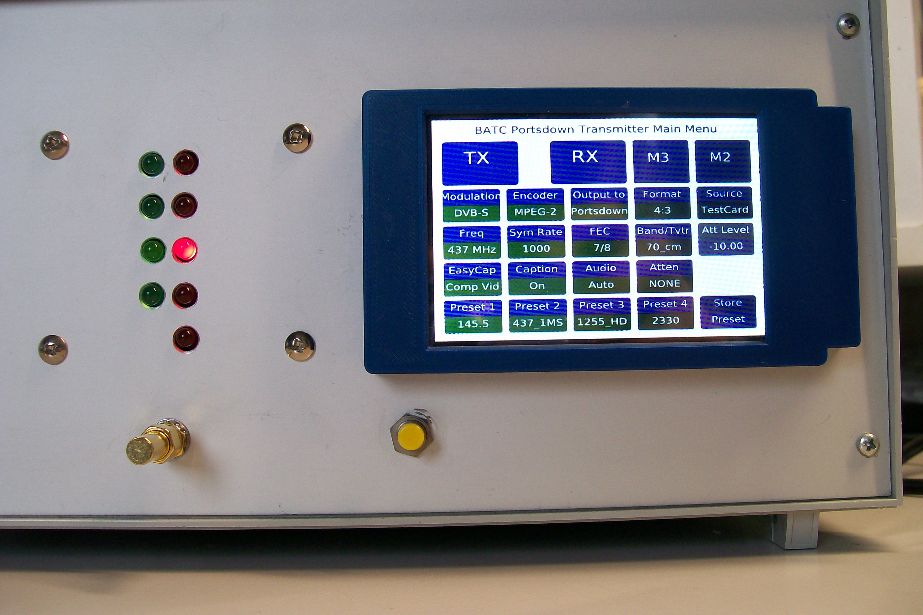

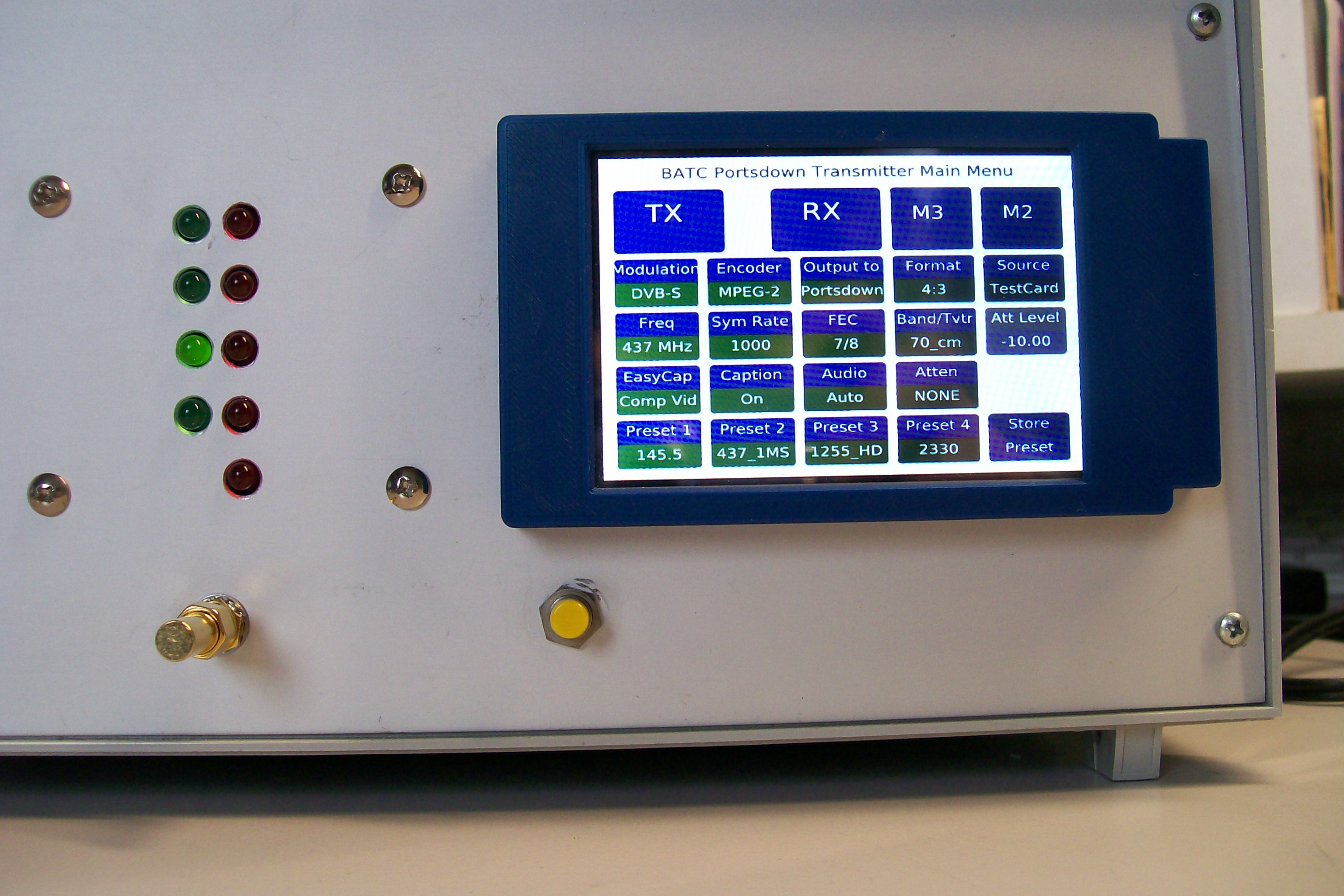

I have added 3 photo's so you can see what I mean.
1st: Normal situation 2: In TX mode and 3: return from Tx. As you can see the green LED is lighted.
I did a factory restore but the problem stays.
BTW: there is no difference between H264 and MPEG-2 anymore....
Thanks for reply!
As far as I can see I'm not in transverter mode. I'm using the 8-band decoder and RF-switch.
The strange thing is that this problem was introduced after I build the Portsdown in a nice enclosure. I checked all the connections twice...
- (2) In TX mode
- case (3).JPG (1.1 MiB) Viewed 5882 times
- (1) Normal start situation
- case (2).JPG (1.08 MiB) Viewed 5882 times
- (3) Return form TX
- case (1).JPG (1.07 MiB) Viewed 5882 times
