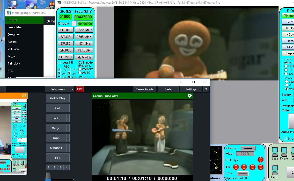

Dave Crump's suggestion has been excellent. I found a discarded ADSL router and two LAN cables, connected it to Portsdown and the mini PC I use and switched on.
Windows showed an Ethernet without internet connection and the PC had these addresses:-
IPv4 address: 192.168.0.2
IPv4 DNS servers: 192.168.0.1
The Portsdown info screen showed WiFi address and new address 192.168.0.3
I sent the command ping 192.168.0.3 in the Windows command window and got a satisfactory reply.
I entered the above address into Vmix2Portsdown batch file, changed the Vmix Stream outputs to those shown on the BATC Wiki page and pressed the Vmix External button. It turned red. I selected Encoder <IPTS in> on Portsdwon menu and transmitted. Minitioune was soon showing the stills or videos. The animation of Lonnie Mack's wonderful Cookie Blues gave me the audio/lyrics 2 seconds later.
Vmix to Pi working first time.JPG (140.21 KiB) Viewed 3856 times
This means Portsdown users can use VMix away from internet. Test card to "talent" transitions when out car park /p are possible for 1MS/s or greater transmissions. I bet some of you won't be able to resist....... Certainly it will appeal to the scouts visiting our JOTA station next year.
David M0YDH
