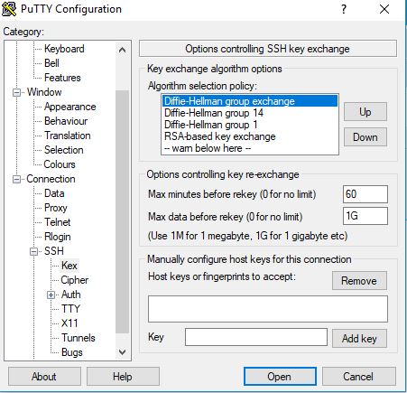

I connect up network cable add a touchscreen add the power wait a while, a minute or two do a IPscan see 192.168.1.73 go to use putty and get
I have had a bloke look around and cant see where I have gone wrong

Rob,
on the main screen select the top line of the selection policy field as highlighted in the attatchment and then using the down
button on the right hand side move it to the bottom of the list and then try reconnecting to the ip address. You will have to do
this every time you use putty. It worked for me.

Thanks for the hint
Wayne VK5BI , your version looked a little different so I downloaded a newer version and now all is sweet , many thanks
