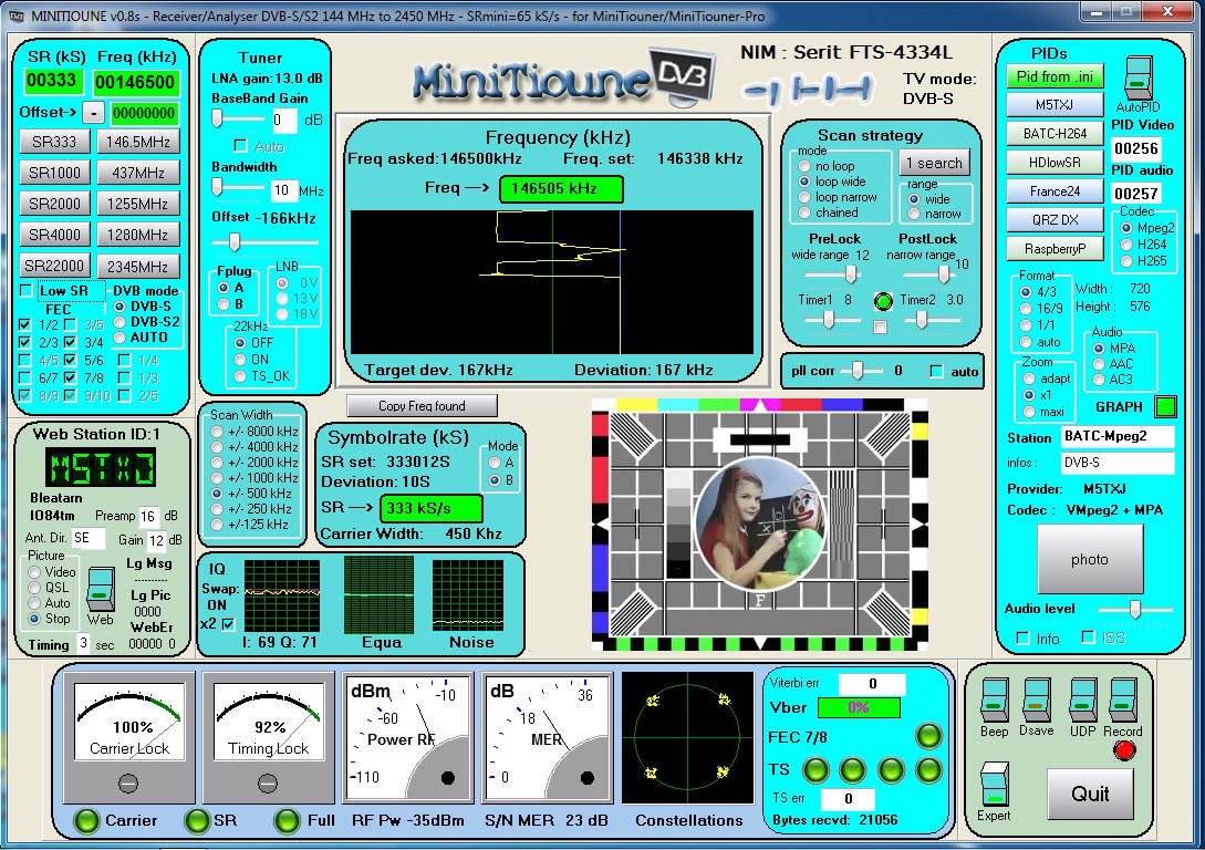

Re: Poor constellations.
No problem Dave, at least it looks a bit better now, indicated mer varying between 23-25db where it never got above 18db before.
73 Dave.
73 Dave.
- constellations2.jpg (404.79 KiB) Viewed 3489 times
