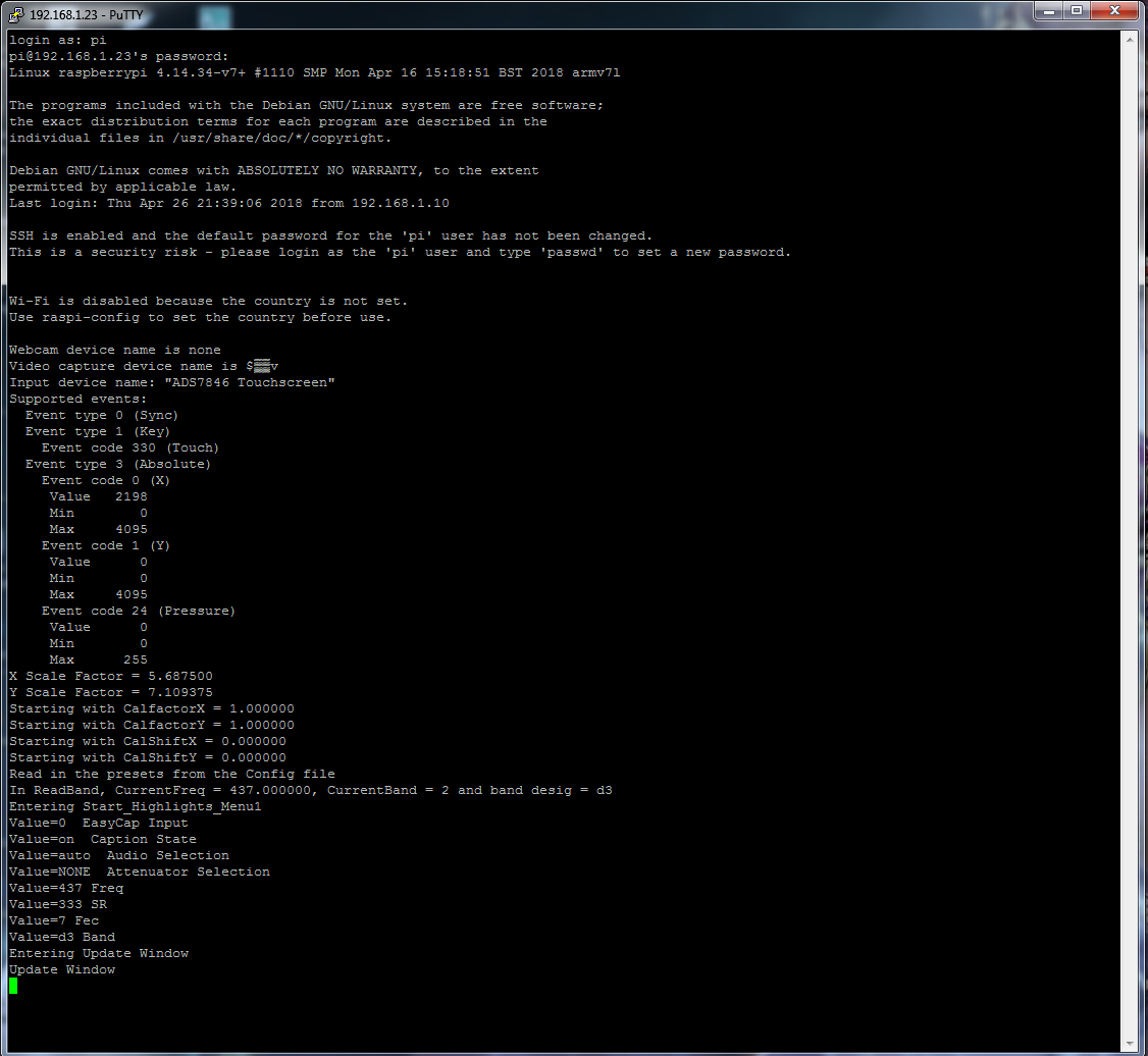

I have rebuilt the software and got the same results.
By using putty I can see what happens from logging in - using the touch screen produces no output in putty, so most likely the screen is faulty.
Attached is the output using putty - can anyone confirm that everything looks OK from what is displayed ?

Hi Nick
That all looks normal. I think that the touch sensor circuitry has failed.

Shouldn't 'Event code 0' have a value of 0 if the screen isn't being touched? It seems to be 2198... Is something pinching the LH edge of the display? A bezel or mounting of some sort, perhaps. However, having said that, wouldn't that cause 'Event code 24' to be non-zero?

With regards to the event codes, etc, I have no idea what they mean so that's why I added the image. This was the first time I have created an operating system for Pi on an SD card and was not sure if I had done it correctly.
My intention was just to see if the OS had installed correctly and worked OK. Whilst it was installing I did note and error or two being mentioned, but I don't know what they were as they scrolled off the screen too quickly.
