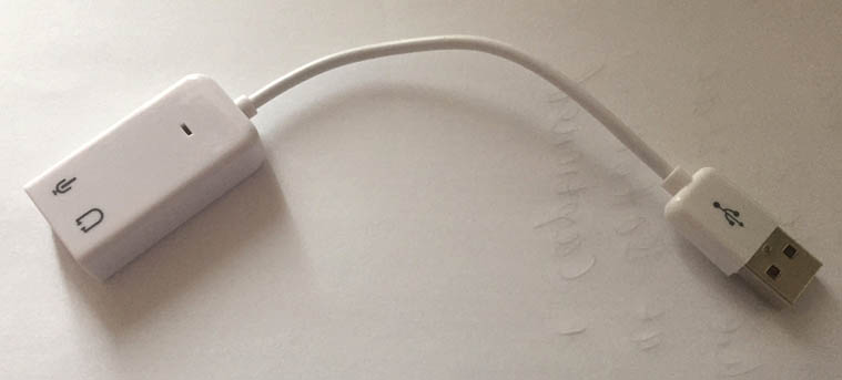

Can anyone recommend a USB audio dongle and microphone combination suitable for use when the PI camera is being used ?
There is a large selection available on ebay - I don't want to get a unsuitable one.

Hi Nick
I have bought 3 of these dongles from different eBay sellers.
Audio Dongle.JPG (45.05 KiB) Viewed 3695 times
All worked fine. Any cheap computer mic (with the powered insert) will work with them.

Thanks Dave,
Got one ordered now.
