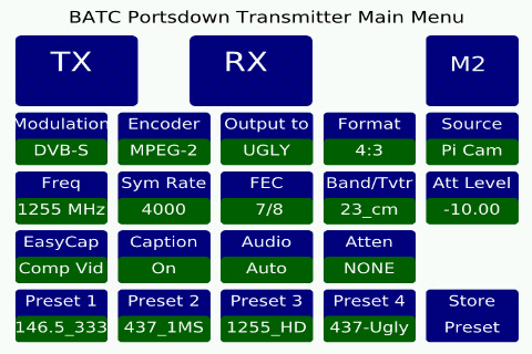

I have just published the "Portsdown 2018" software update. This delivers a step-change in the functionality available from the touchscreen and makes room for new features in the future.
Most of the buttons on Menu 1 now launch a sub-menu to enable the relevant parameter to be set. There are also 4 preset buttons that can be used to store your commonly-used configurations. Menu 2 is now home to the additional capabilities, such as the Signal Generator and FreqShow. Menu 3 provides facilites to change the preset frequencies and symbol rates. More details here: https://wiki.batc.org.uk/The_%22Portsdo ... 2_Software
The update also introduces the ability to control an attenuator to set the output level for each band, and to configure 4 additional transverter outputs. Details of the transverter switching are here: https://wiki.batc.org.uk/Portsdown_2018_Band_Switching. Designs are well advanced for an "8-band switch" board to enable transverter control, and also for an "8-way RF Switch" which will incorporate an amplifier so that, when used with the attenuator, the Portsdown should be able to deliver programmable output levels of between -10 dBm and +10 dBm on any band.
There is one limitation to note: PLEASE DO NOT USE SPACES IN THE PRESET LABELS; use underscores instead. As always, please post details of bug reports here as soon as possible.
