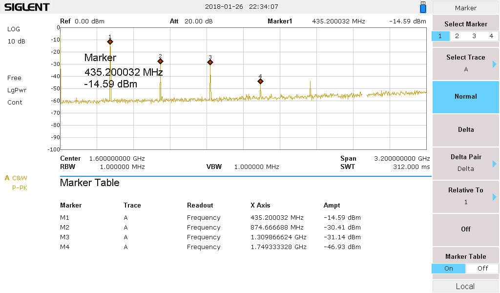

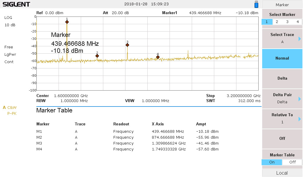

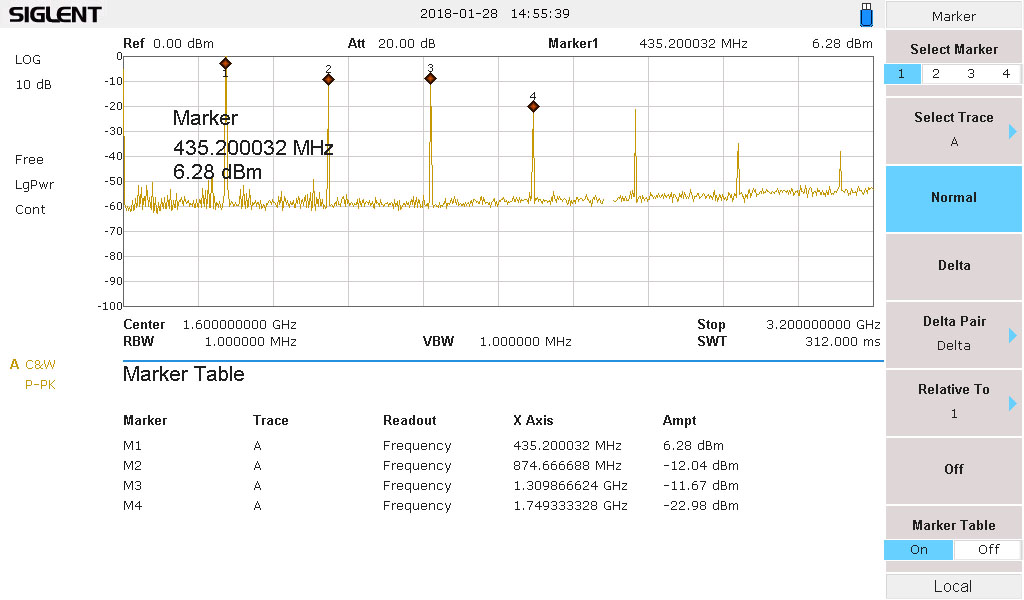

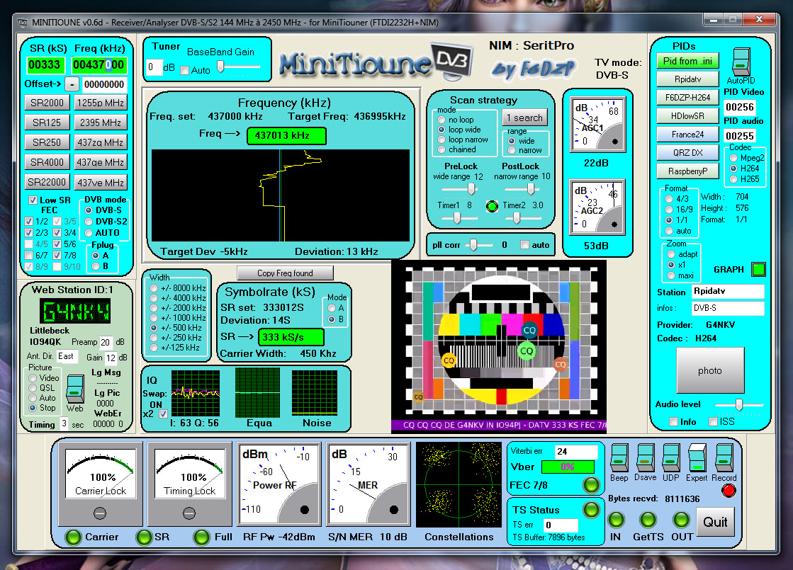

I have just completed the Portsdown build and have some issues with the transmitted signal.
The transmitter output was fed to a spectrum analyser and the MiniTiouner is used for receive. The signal took quite a while to lock and produce an image, and the constellations are poor - image attached.
Maybe there may be a problem with my MiniTioune software as when typing in the frequency or SR value there is a significant lag from entering the numbers on the keyboard to them appearing in the text box - is this normal ?
Looking at the Porstdown output on the analyser there are several harmonics of a significant level, but the output from the LO Filter is very clean - no harmonics visible, so it seems these are being generated in the Filter/Modulator - image attached.
I have been going through other threads looking for any clues to this and am now wondering if it could be how I have installed the board interconnections. To keep the layout tidy all my looms are twisted single cores, and many of these looms (Breakout to ADF4351, Breakout to IQ on Filter Mod, Breakout to SR Select on Filter Mod, Breakout to Shutdown Button/LED and 4 Band Decoder to Panel LED's) are for a great part all tied together.
In the forums I found mention that the IQ wiring should be short and not near other wiring, and also found a mention that the wiring to the ADF4351 should not be twisted as mine is.
Before I pull apart the wiring and replace it can anyone confirm that this may be the issue, or could there be any other possible cause's.
Regards,
Nick - G4NKV

- 70cms Analyser.jpg (135.25 KiB) Viewed 5574 times
Re: First Test - Poor Results
Hi Nick - don't twist I & Q together, assume that isn't what you meant. Certainly don't twist the I2C lines.
How are you receiving this? Try a direct cable connection through attenuation. Your problem might be multipath.
Nick I'm by no means the expert on this, but I've been staring at the pics, and the spectrum and constellation do look a bit grubby, and if you say the LO is clean, then it's odd.
It looks like the sort of grubby I'd expect if it were the Pi operating in ugly mode - are you sure it's actually using the Filter-Modulator to TX?
Hi Nick
I've refrained from jumping in, because my first 2 thoughts have already been covered by Mike and John. - Thanks guys!
To answer your other questions in order:
The Moving Balls test card always takes quite a while to lock. The Camera in H264 or any of the MPEG-2 modes lock a lot faster.
MiniTioune can have a significant delay in screen update on less capable PCs, but still reproduce clean constellations - so I don't think that's your problem.
The harmonics from the F-M board are normal and are not the cause of your problem. You always need a good low pass filter after your PA as stated here https://wiki.batc.org.uk/Filters.
Wiring is unlikely to produce the constellations that you have. I would suspect something to do with the coupling between the F-M board and the MiniTiouner. Also, the level on the analyser looks low - I would expect around +9dBm at 437 MHz https://wiki.batc.org.uk/Portsdown_Output_Levels. Or perhaps you had an attenuator in-circuit?

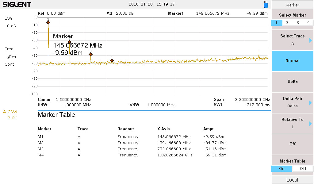

Mike/John/Dave,
Thanks for input.
As John realised I did have an attenuator (20dB) in circuit. When I removed this it showed that output from the LO Filter was not as clean as I first thought. As a result I connected the output of the ADF4351 to a 70cms filter obtained from e-bay (the one in the Wiki). This gave a cleaner output, but when fed to the Filter/Mod the output from the Filter/Mod showed no real difference to using the LO Filter.
My main concern was the harmonics from the Filter/Mod, so I am relieved that this is normal.
As there was no real difference on the Tx output using the LO Filter or the ebay one I would assume that the LO Filter is probably OK.
I have attached 2 images showing the LO Filter output on 2mtr and 70cm. Are these as should be expected ?

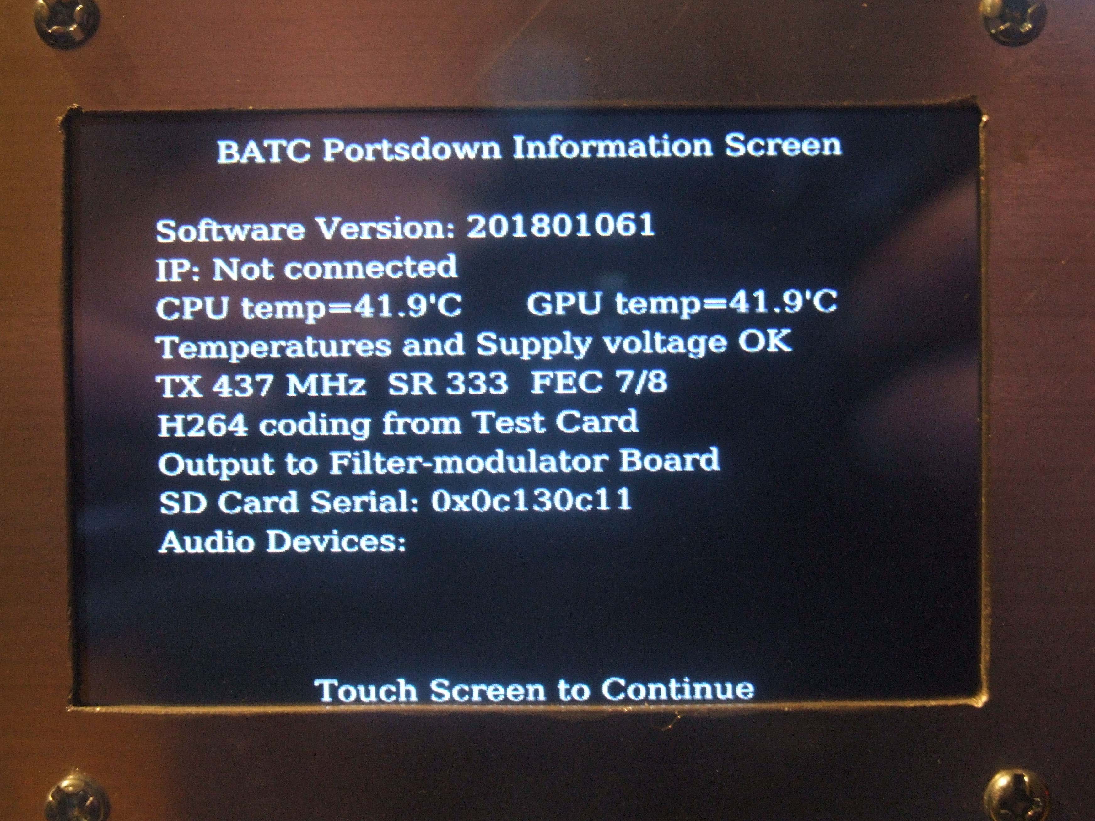

I have also attached an image of the output from the Tx using the LO Filter without the 20dB attenuation inline.

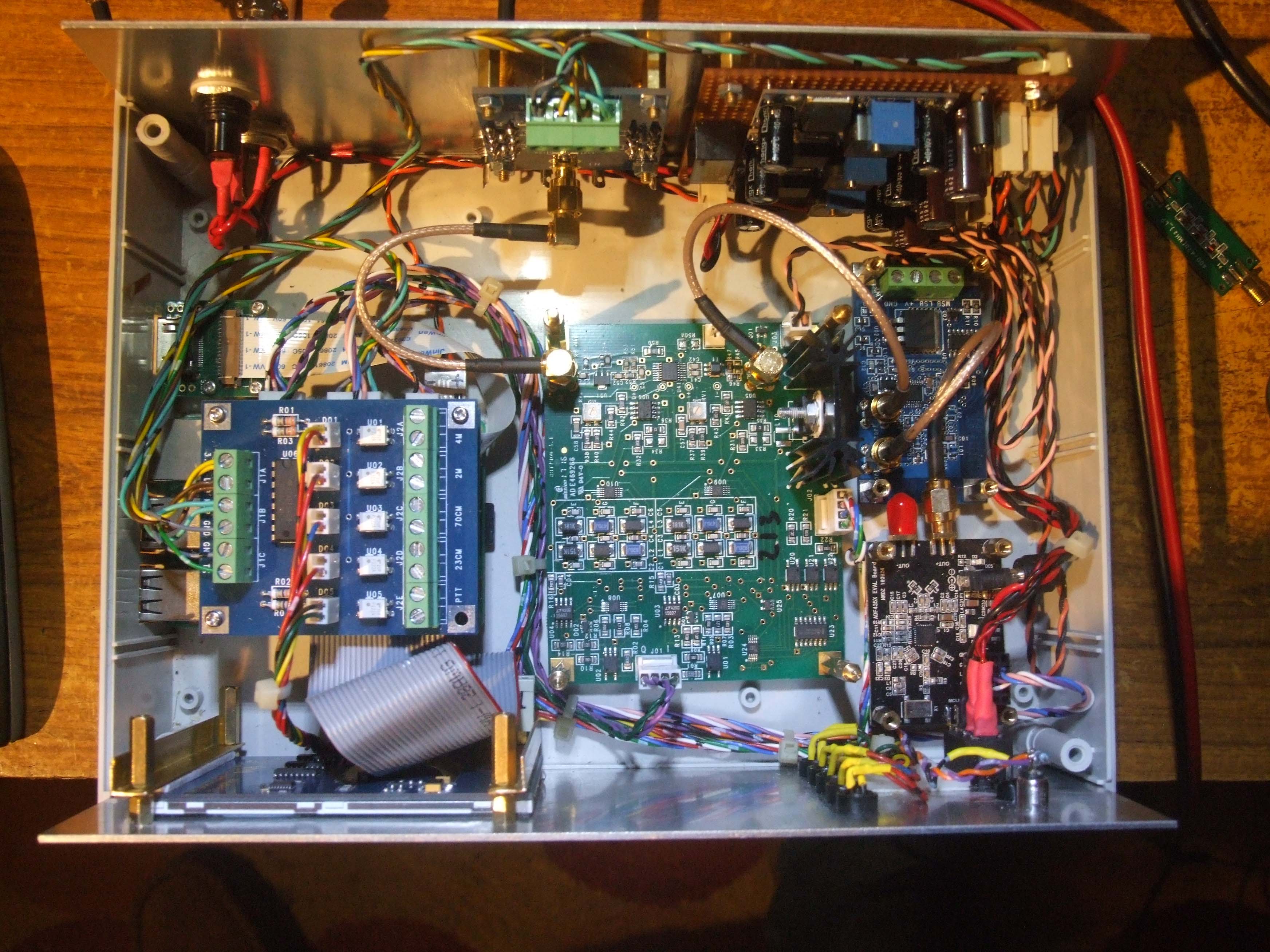

Also attached photo of information screen and one of inside of Tx.
Hi Nick
60 dB of attenuation should be just right. It’s what I usually use. Interested to see your results with that.
LO filters look to be working as expected. Nice build!
Dave,
That was a quick reply - thanks....

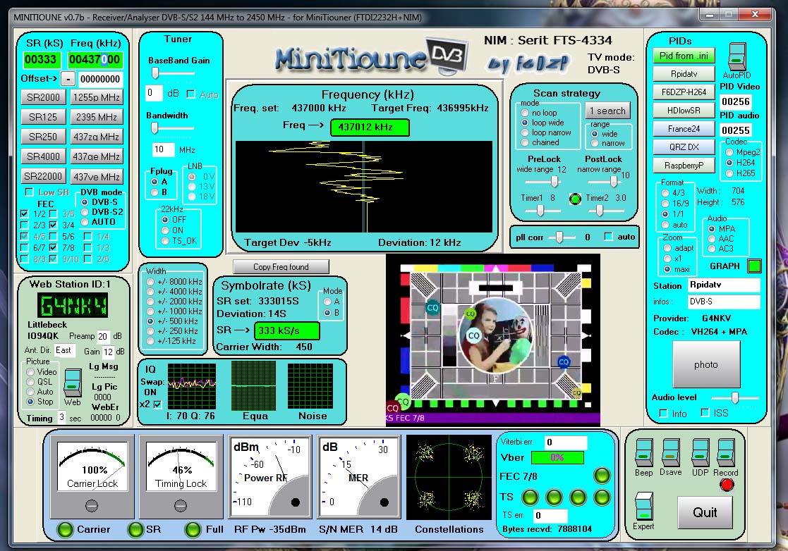

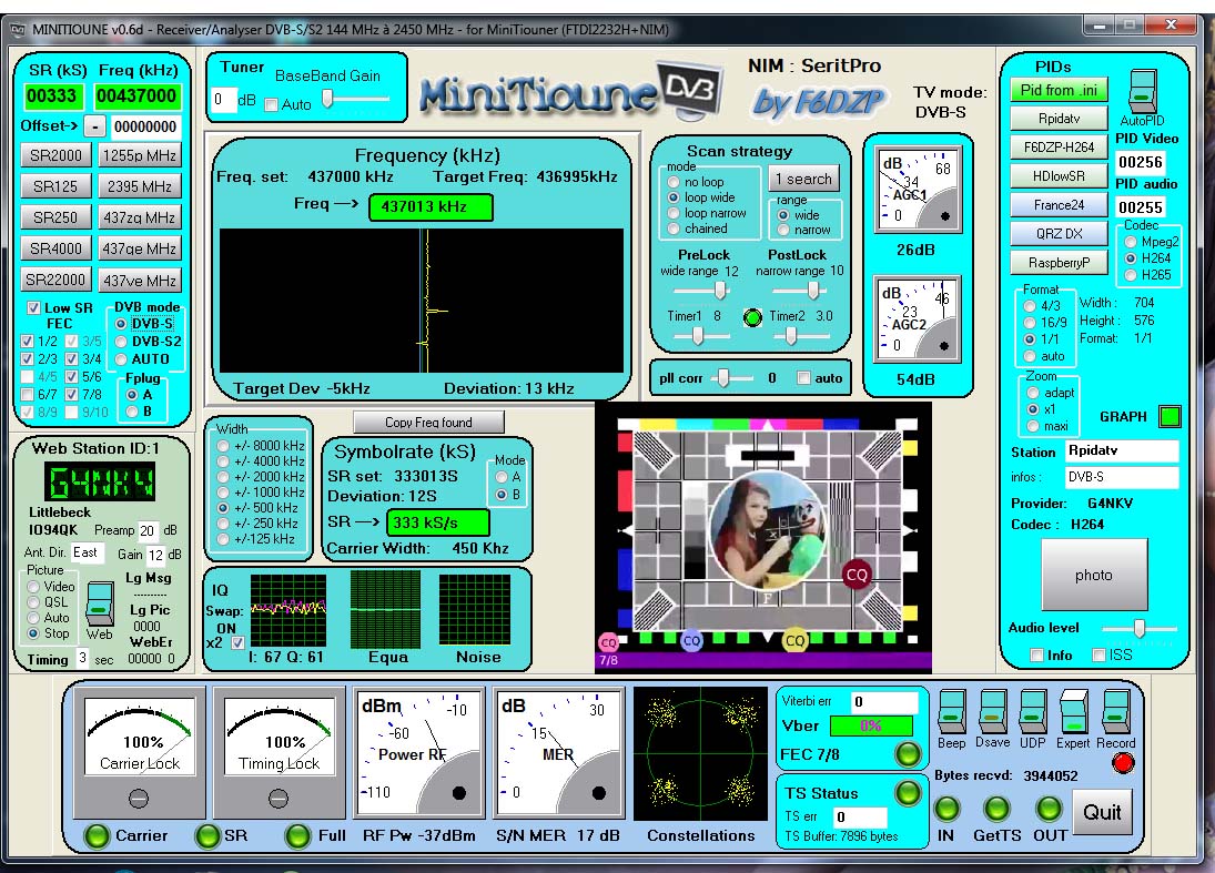

Attached are images of the results with a direct connection. I get different results between MiniTioune v0.6 and v0.7.
Does one of these look OK ?
On the face of it v0.6 looks better, but maybe I have some settings wrong in v0.7.
Hi Nick
The results are not far off what I would expect. Your F-M board is from batch 2, so would have been tested with a Sharp tuner and MiniTioune V0.6d, which I suspect gave an MER of around 24 dB (you could check the test sheeet).
Since that batch were tested and sold, we have found that the Serit tuner is more critical on the waveform being absolutely correct and the batch 3 tuners were tested on a Serit and MiniTioune 0.6d, with a pass criteria of 18 dB MER at 333KS. We are now working on a simple modification for Batch 4 which improves this figure by slightly increasing the I and Q filter bandwidths, and users will be able to modify boards from previous batches. I suspect your board might be at the end of the tolerance range. To complicate matters further, the MER calibration changed in MiniTioune V0.7b.

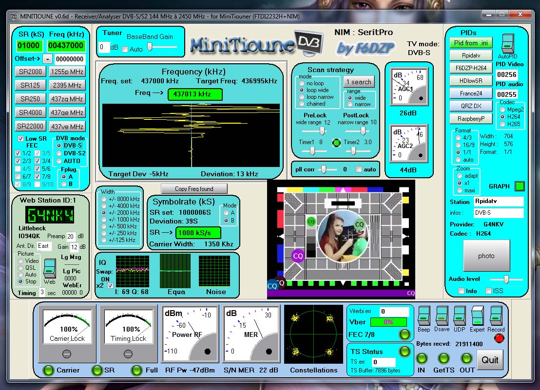

Try 1000KS symbol rate, you should get around 23 dB MER with MiniTioune V0.6d, and a better constellation if all is well. If that works, I do not think that you have a problem, but it will be worth you implementing the batch 4 modification when it is finalised.

It looks nicely built.
What are you powering the LO from? Is it a clean supply or could there be switching noise on it? I can see what looks like a lot of filtering but not sure of your layout or what switching supply you are using.

Dave - I tested using 1000KS and got better results - see attached image. My board was tested with a Serit tuner and MiniTioune V0.6d. Given MER's for 23cm are 25.
