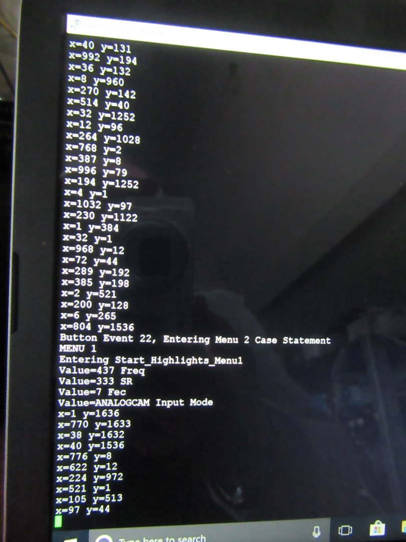

Post by G3UKV » Mon Jan 08, 2018 3:24 pm
Img 1.JPG (211.48 KiB) Viewed 6630 times
Img 2.JPG (249.74 KiB) Viewed 6630 times
Img 3.JPG (196.38 KiB) Viewed 6630 times
Img 4.JPG (176.17 KiB) Viewed 6630 times
Hi Dave
Here are 4 screen images of what happens. Img 1 shows the Putty screen when I link up to the RPi initially.
As I strike random buttons, (say 12 to 30 times) eventually menu 2 or 3 appear - but although every button givers x= and y= values (constantly changing, values even if I press one specific button several times in sequence). You can see this on Img 2-4.
However, apart from sometimes changing between Menus 1, 2 and 3, nothing else changes. The 'green' buttons are unchanged from the boot-up.
Most odd. So the touchscreen is responding to taps, but the output seems to go unchanged, except for the occasional (random) change of displayed Menu.
Martyn
P.S. Hope the attached images are visible - never used a Forum with attachments before. If these are not usable, I'll send same photos via personal e-mail.
