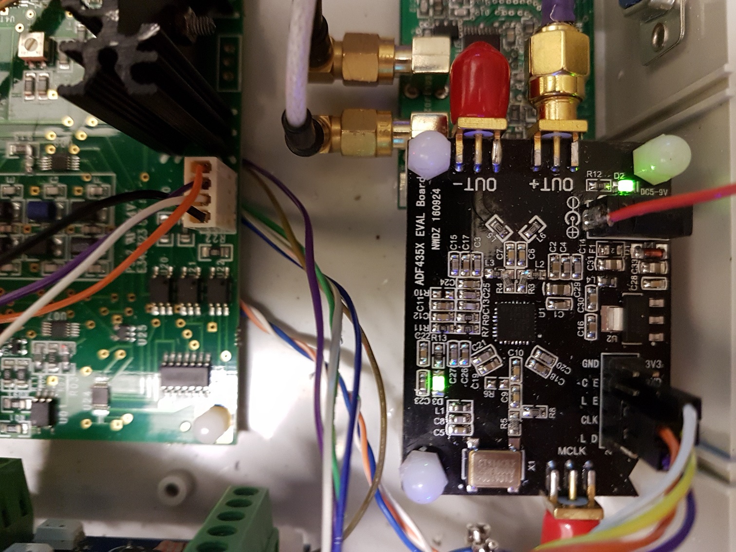

Fellow Portsdown builder David M0YDH has been around with his test gear and it
would appear there is no power output in IQ mode. The ADF4351 is showing both leds lit.

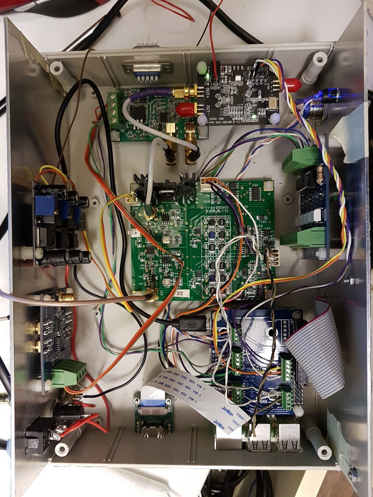

Do you have a photo?

Photos will help as well!

attached are photos as requested

Please try connecting the output of the ADF4351 directly to the input of the Filter-modulator board, so that you bypass the VCO filter. Then see if you have any RF output (or even pictures).

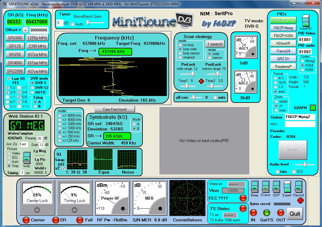

attached the ADF4351 directly as advised...hey presto a picture, locking in
quite quickly.
