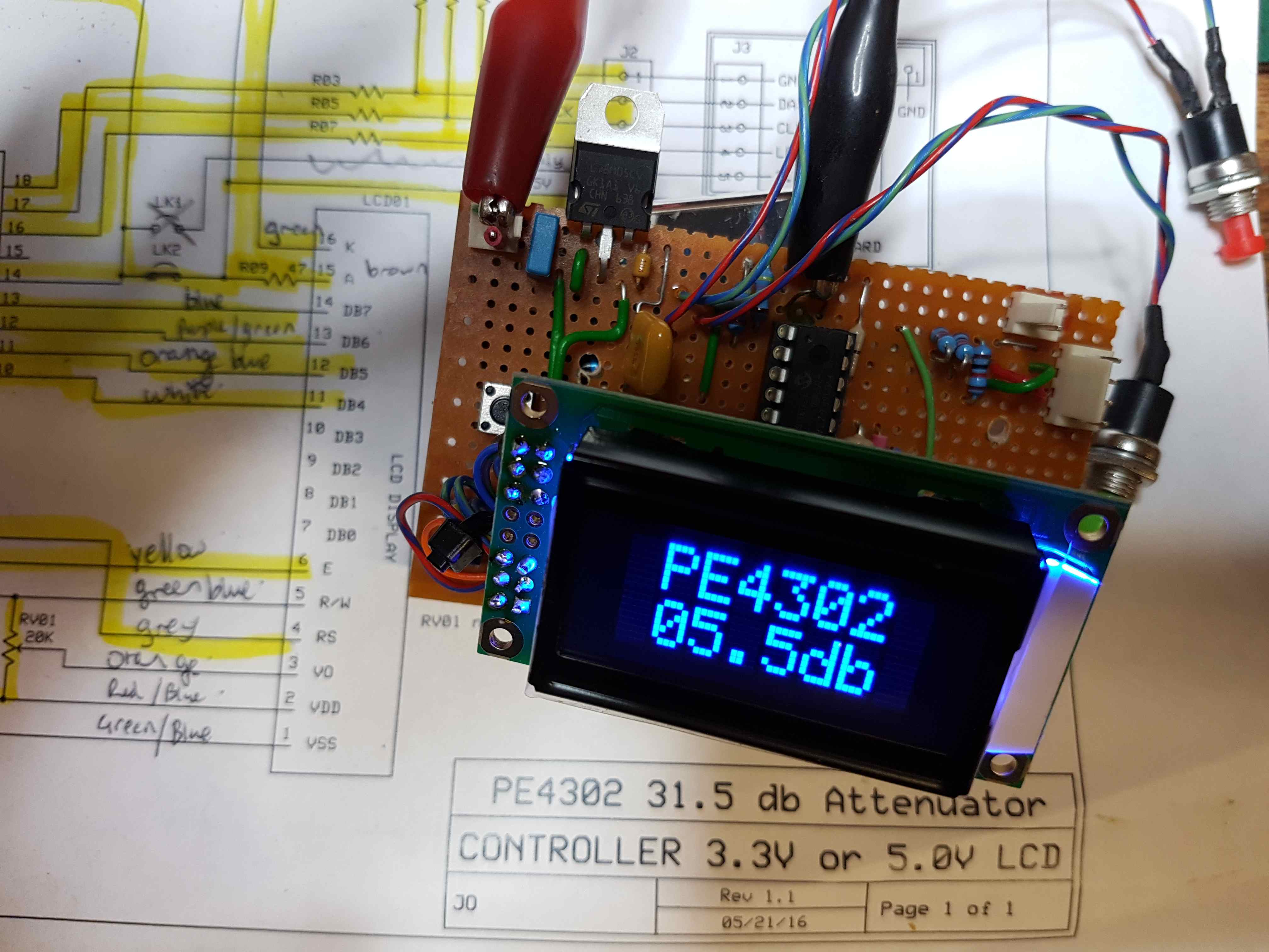

Hello Colin and John
I liked the look of this and made the controller over the weekend on Veroboard as pictured. My PE4302 is on the slow boat from China. I hope to fit the controller [complete with the missing M2 stand-offs] into the lid of my Portsdown and mount the attenuator board on a bracket above the filter modulator. Thank you for all your hard work.

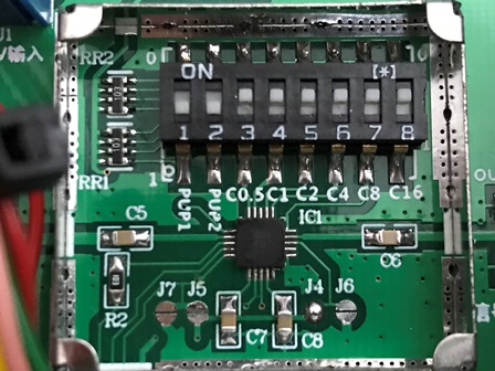

What are the DIP switch settings to make the controller change the level of attenuation? As received all 8 are on and the attenuator remains bypassed aka no attenuation when RF is applied.
The Chinglish descriptions on Ebay mention switch changes but I don't understand.

Set the solder jumpers for serial
https://wiki.batc.tv/File:PE4302_Attenuator.pdf
Set the DIP switches for max attenuation.

Glad to hear your attenuator is working now David, as mentioned above they come configured for parallel.
For the benefit of others, there should only be a solder blob on J4 to enable serial operation.

Thank you John and Colin. Here's the picture that Colin sent me. My eyes were drawn to the switches. The attenuator came with 8 on switches. The J thingies are the solder pads across the bottom of the PCB. Solder blobs were on J5 and J6 as supplied. I removed these with solder wick and soldered J4. Et voila!
One for the Wiki to save others anxiety?
