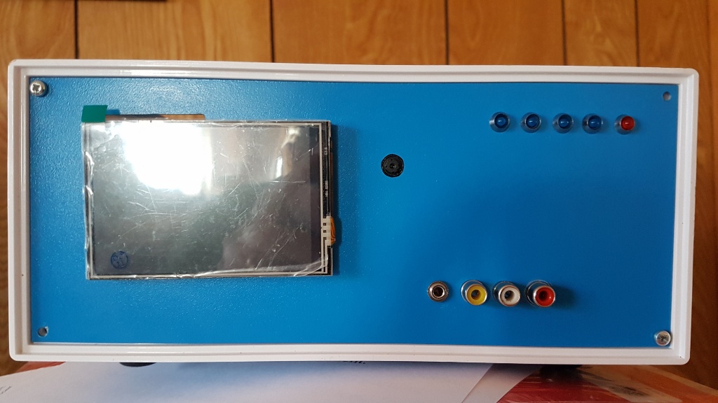

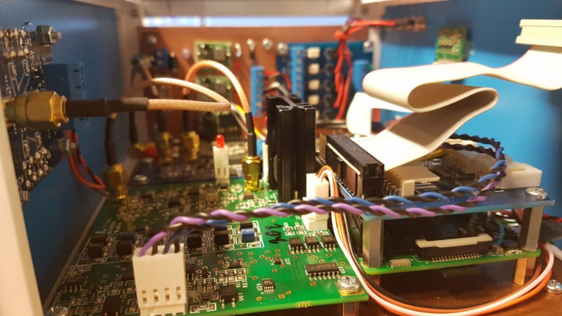

My Portsdown is coming together nicely, I still have the USB, RJ45, band/ptt and power connectors to fit on the rear panel. The display needs attaching at the front when the bezel arrives but most of the wiring up is complete.
73 Dave.
Front panel, not distorted as it appears in photo.
Internal view from l/h end.
