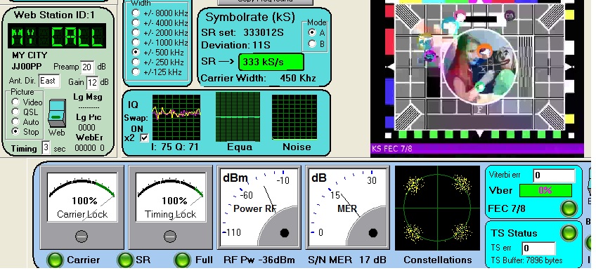

Chaps, I've been looking through the wiki,and it has answered pretty much all my questions. And got me this far.
But.... as this is my first time playing with the minitioune and davt, I have no idea if the constellations I am getting are good or bad.
Attatched is one example.
This is 437MHz, 333ksym. The portsdown filter/mod is connected directy to the Serif tuner, via as many attenuators as I could find. So there should not be any qrm getting in there.
What's the verdict chaps?
Jules

A bit more info......
The expected MER, from the wiki, should be 10dB better than I am getting. So suggests that this is not as clean as it should be.
This is just a standard build, by the book. Using the pre=populated/set-up filter/modulator board, from the BATC shop.
The output at 437 (from the modulator) is around 12mW, so that suggests that the drive levels and LO filter board are ok.
The only thing I have different to the wiki instructions, my LO board shows a 3v3 feed on the header, rather than the 5V that the wiki wiring suggeses. So I've fed the LO with 3v3. But the LO sounds clean on an SSB RX, so that looks ok.
Another issue I am seeing is, the minitioune seems to often refuse to get lock. The tuning trace is fine, but the carrier lock and timing lock are hammering between 0% and 100% a few times a second. All the tune/PLL settings are as installed.

Hi Jules,
Awful - absolutely terrible! Not really. Its not a very good MER for a direct connection, should be over 20 as its still a fairly strong signal but when you get to using it over the air, that't probably not going to be the limitation. What it should look like is more like this https://flic.kr/p/Hv3Mms
Off air though, here is a picture from Arthur https://www.flickr.com/gp/ad6xy/q93831 you will see it looks quite similar.
Where that would be a problem is when looking at higher order modulation, which the Portsdown can't send https://www.flickr.com/gp/ad6xy/bCy548
I would see what is causing that spreading. Is it the TX or is it the RX? Does it change with frequency? Did you follow the instructions?

Hi Jules
I'm not sure that your constellations are so bad. The Serit Tuner seems to be more critical of the very sharp IQ filtering on the Portsdown than the old Sharp tuner was.
Some things to try:
1. First, the not so obvious: Have you selected IQ output mode, rather than QPSKRF that you might have used for early testing?
2. Reduce your symbol rate to 300KS on both the Portsdown and MiniTioune. If you get 2dB or so of improvement in MER, it suggests that the IQ filter clock might be at the edge of tolerance.
3. Increase your symbol rate on both to 1000KS. This uses an LC filter and may tell us whether the problem is as described in (2).
Please post your results here and we'll work out what to do. Failing that, are you going to the FRARS rally? We'll be there with some test gear and knowledge.
Some things to try:

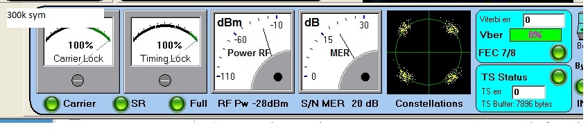

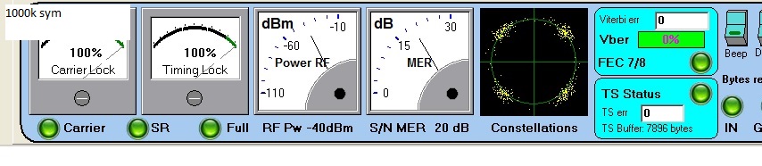

Ok, here is the raw info for you to be going on with. I've not started digging through the schematics myself yet.
At 330ksym, I'vere-run, for comparison. And get the same MER of 17dB. As I'd popped a bit more atten in, in case I was overdriving the Serit.
The 300ksym gives an MER of 20dB. Pic attached.
At 1000ksym I get 20dB as well.

OK Jules
Sounds like you have some minor problems there, but nothing to be worried about at the moment. Probably the filter clock AND some minor MiniTiouner snag.
I would suggest that you continue with building the rest of your system and we'll try and identify the exact issue at FRARS. We can try different transmitters and MiniTiouners to locate the last few dB.
