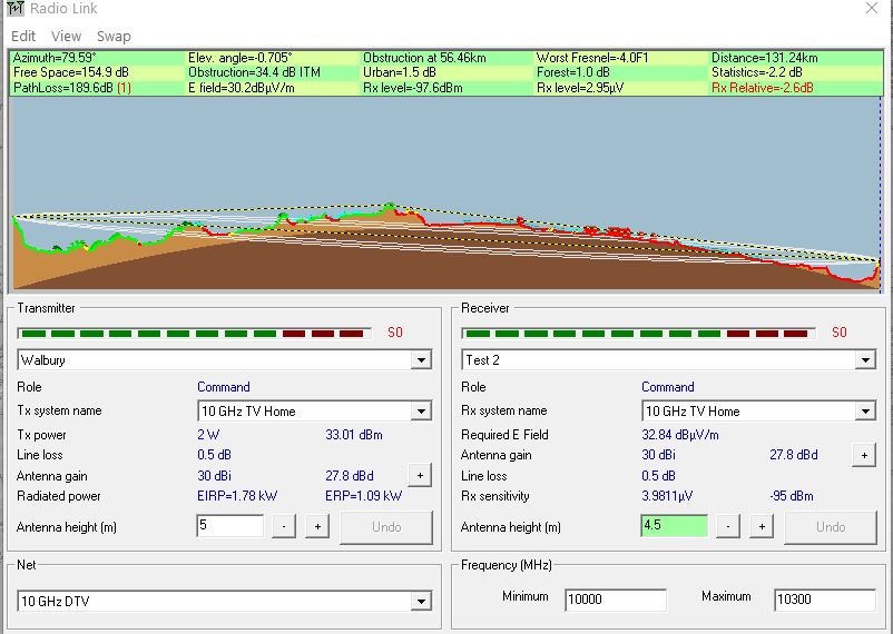

http://www.heywhatsthat.com/bin/profile ... ,-1.477184
Basildon lanngdon hills to Coombe gibbit

You can use a separate LNB but then you need a separate dish or c/o system - I'd use the transverter down to 437 but you will probably need a bit of gain (sat line amp ?) before the Serit.
But beware and don't get caught like I did - the DB6NT needs +ve volts on the feeder to put it in to transmit - I use +12v out of my DATV receiver to power the pre-amp and relay when in receive - as soon as I connected the transverter to my rx input it went in to transmit. Took me a while to figure why I wasn't receiving anything! A bit of DC blocking on the input to the line amp will do the trick.
The path looks do-able, so give us a shout when you're ready!
73 Noel
