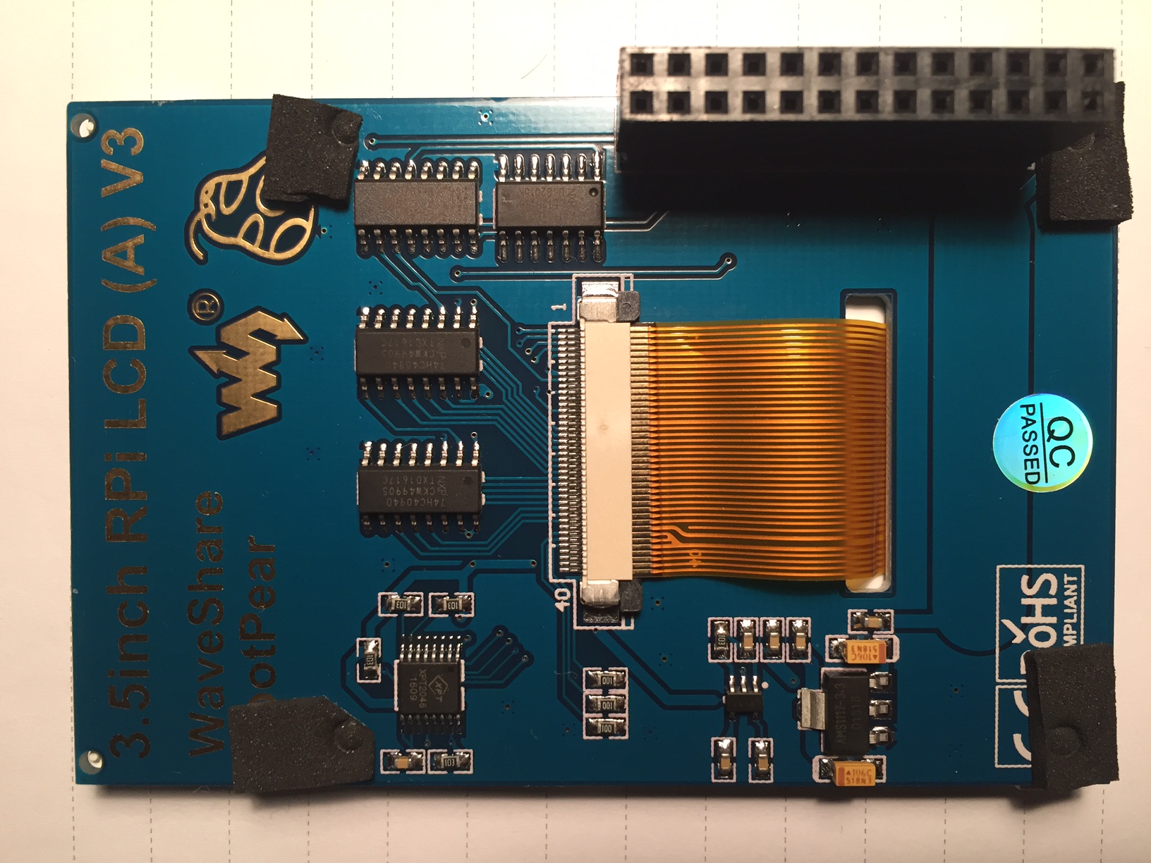

this is the Waveshare LCD I have is it the correct version?

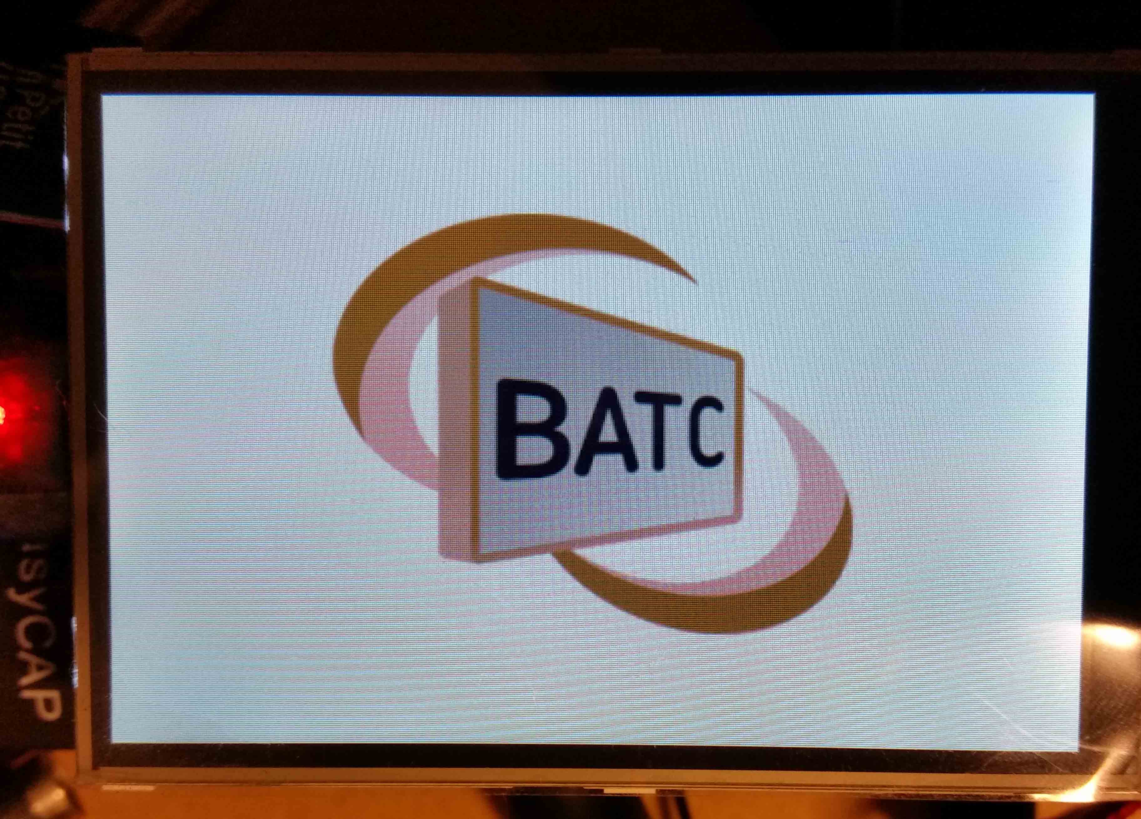

and waht the LCD shows ie negative image

I suspect an LCD Hardware problem here. The display looks identical to the one that is fitted to the Demo Unit below (apart from the rubber pads that I fitted). Please try to check all the connections on the display especially the ribbon cable. Or just return it as faulty.

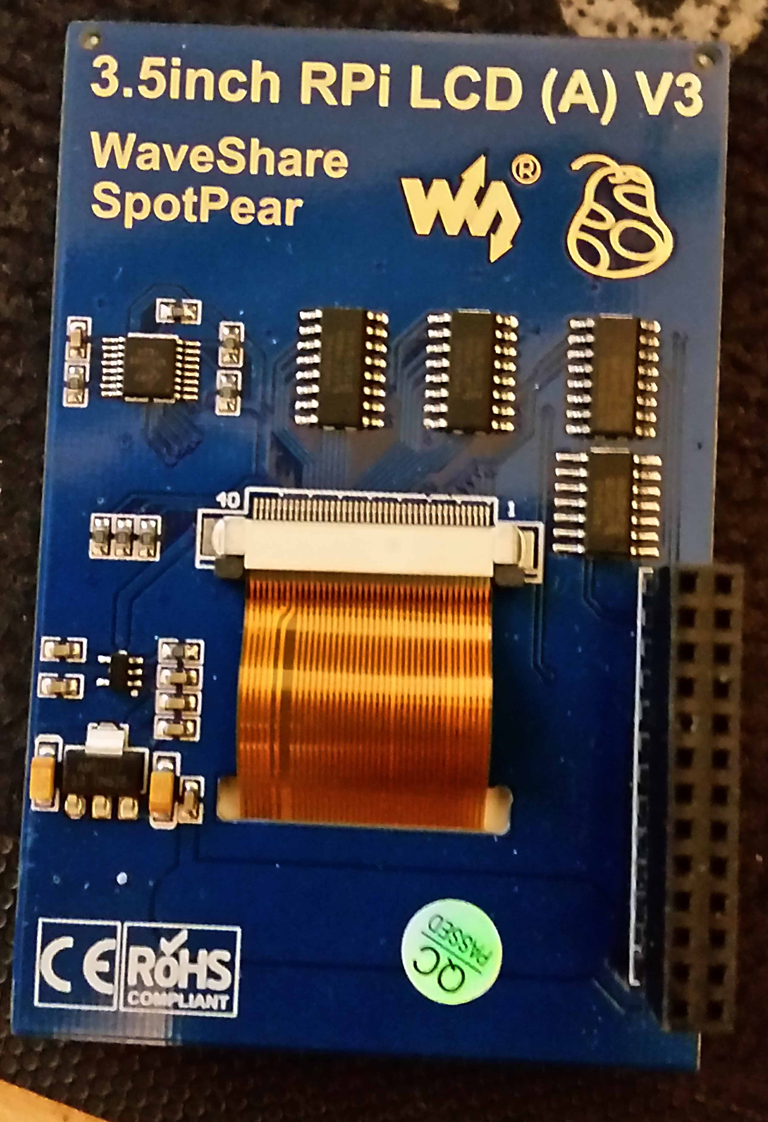

Having problems with my screen ....it doesn't respond when touching it .
Was working ok ...but now decided not too .
It's a version A but doesn't have the ribbon cable on the back.
