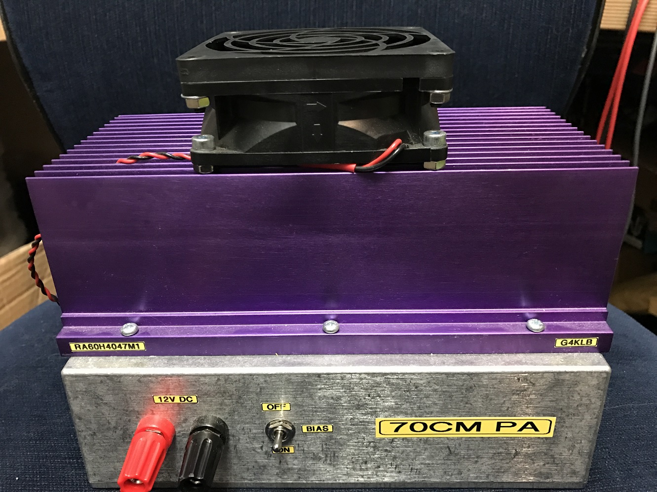

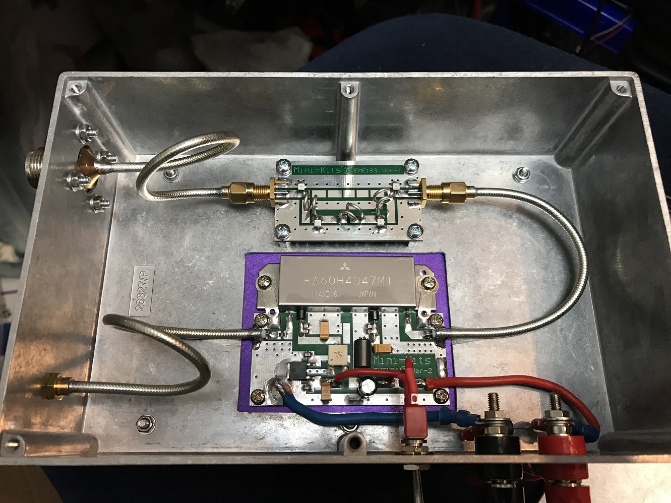

70cm only needs a brick amplifier and filter.
You will need to attenuate the input from the Portsdown or it will give 50W out :o
