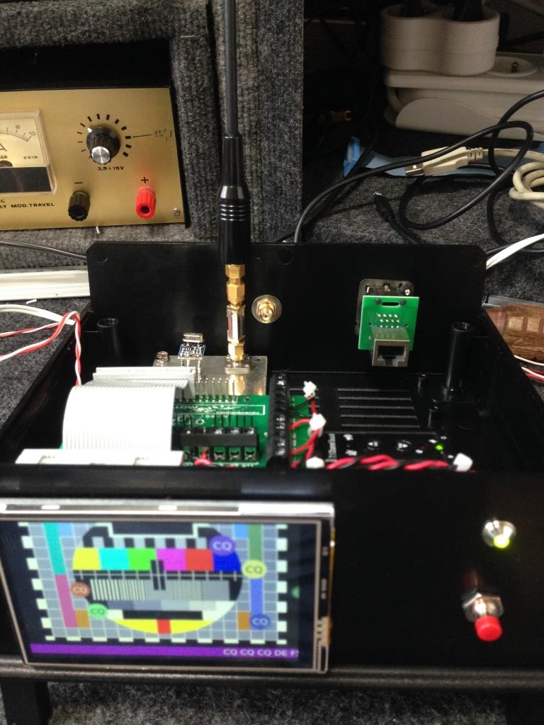

Yes I did it :)
Wolfie G8VAT
Posts: 171
Re: Success Stories
Post by Wolfie G8VAT » Wed Apr 19, 2017 9:24 am
Wow! that is neat Dimitri, I'm well impressed nay jealous because my own is still sitting in a box an array of unconnected parts..
Dah-di-dah
Graham G8VAT
F5SWB Dimitri
Posts: 39
Joined: Tue Feb 14, 2017 8:39 am
Re: Success Stories
Post by F5SWB Dimitri » Wed Apr 19, 2017 11:21 am
Many thanlks wolfie (Graham), it's not yet completely finished but very soon :)
I'm waiting again for some other parts (ie a little RJ45) to get the ability to plug the RPI out of the box to a SSH session for the update.
It will done in few days.
To be continued :D
73's to all.
