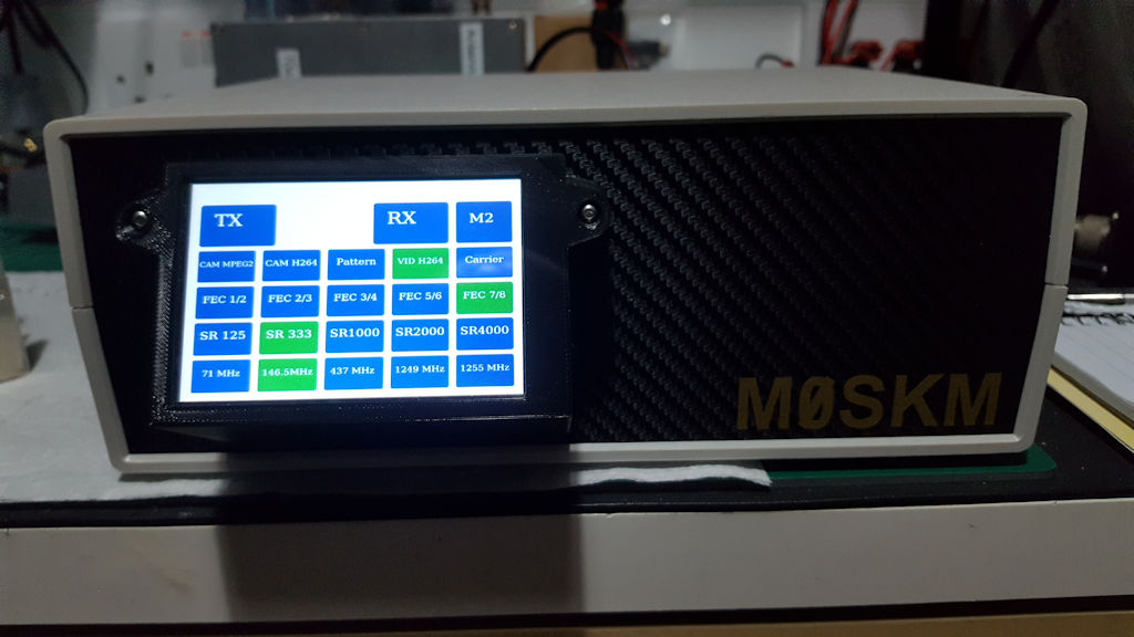

Re: Display bezel - calling 3D printer users
Posted: Tue Dec 05, 2017 8:56 pm
by M0SKM
Hi Geoff
This is the very bezel; it's just fine.
Steve
Posted: Thu Dec 07, 2017 12:13 am
by M0SKM
M0YDH wrote:What isn't seen is the packing piece to make the screen stay in place. Mine is shown in pine on the Portsdown builders group
David M0YDH
Another option is to stick the display in with few dabs of hot melt glue. Mine has been in use since March and hasn't budged. Takes less than two minutes to fit; and not too difficult to remove if the need arises.
