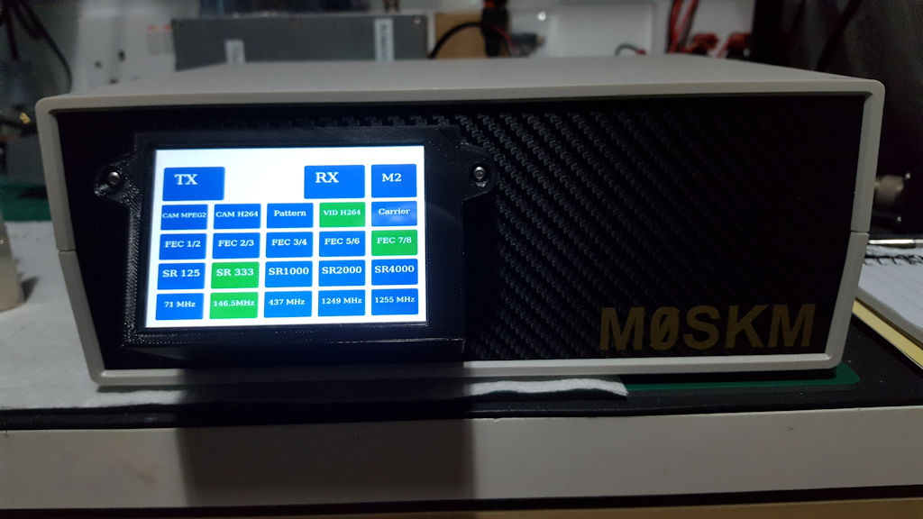

Has anyone printed this out and used it?
I've just printed this one out, and the screen fits. However it looks a bit offset to me. The aperture could be more over to the Right as the left hand side of the screen is exposed, and the right hand side is covered by about 5mm of the case. Of course it will depend on how much of the screen space is actually used. I have not got that far. If anyone has tried this design, I would like to know if you found the same thing?
I don't seem to have mastered uploading Photos to show you what I mean. The instructions and "Add Image" button didn't work for me! (Using Chrome Browser).
Geff
G0DDX
De Geoff
G0DDX
Re: Display bezel - calling 3D printer users
Post by G8GKQ » Tue Dec 05, 2017 3:23 pm
Hi Geoff
The displayed image is offset on the screen area, so when you power up your screen, your housing should look correct. There is a dead area on the right hand side of the screen that is not sensitive to touch and has no pixels displayed.

M0SKM
Posts: 376
Post by M0SKM » Tue Dec 05, 2017 8:56 pm
Hi Geoff
This is the very bezel; it's just fine.
Steve

M0SKM
Posts: 376
Post by M0SKM » Thu Dec 07, 2017 12:13 am
M0YDH wrote:What isn't seen is the packing piece to make the screen stay in place. Mine is shown in pine on the Portsdown builders group
David M0YDH
Another option is to stick the display in with few dabs of hot melt glue. Mine has been in use since March and hasn't budged. Takes less than two minutes to fit; and not too difficult to remove if the need arises.
