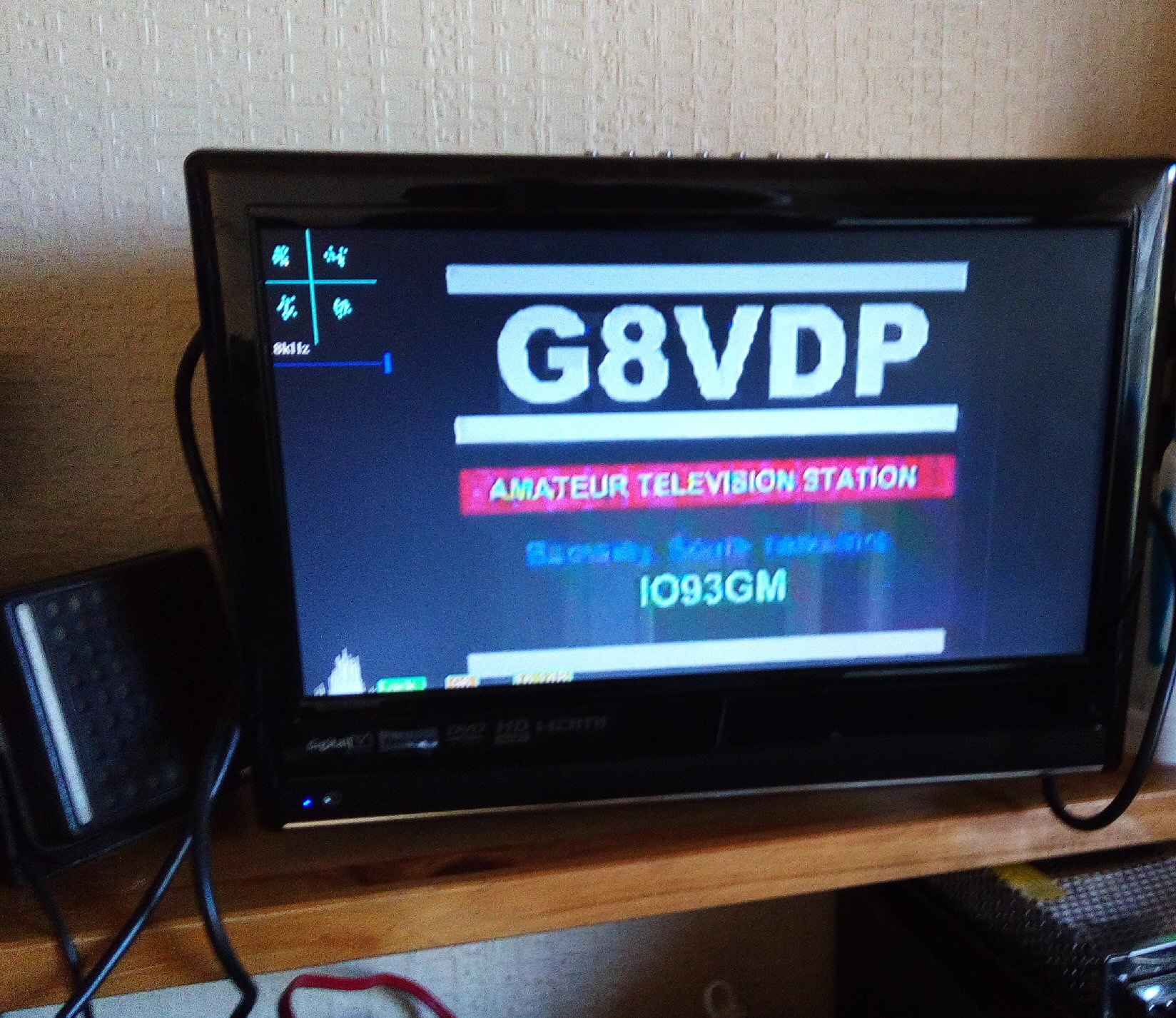

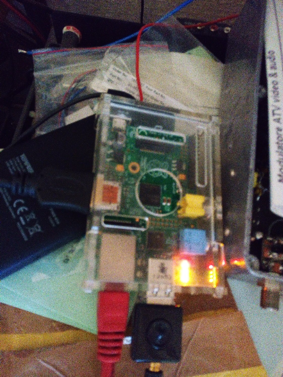

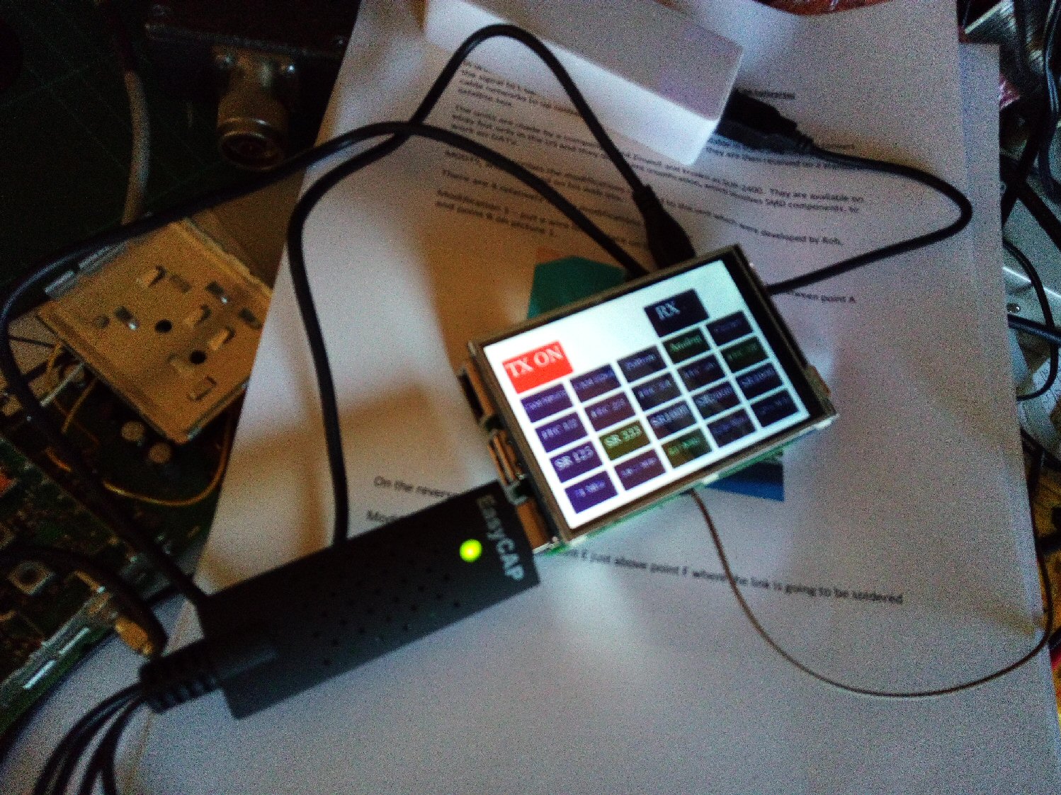

UPDATE
Dave,
Correction to earlier post regarding me having nothing to receive on .
I had a mini brainwave. I have an original Raspberry pi , so I thought , why not Porstdown it ?
So, I did and set it up with SDR-RTL dongle , took a bit of fiddling but it works Raspberry PI one with little RTL dongle
Raspberry P3 txing to it analogue into EasyCap , Its now proved my Easycap and my 2 dongles.
Not only that , Its proved your team work and efforts for us catcheruppers is do-able.
Wow , happy old man here.
Smaller RasPi one with dongle.jpg (641.16 KiB) Viewed 12374 times
still smaller 1st Digital TX RasPi to RX.jpg (512.28 KiB) Viewed 12374 times
1st Digital TX RX RasPi 02 smaller.jpg (543.86 KiB) Viewed 12374 times

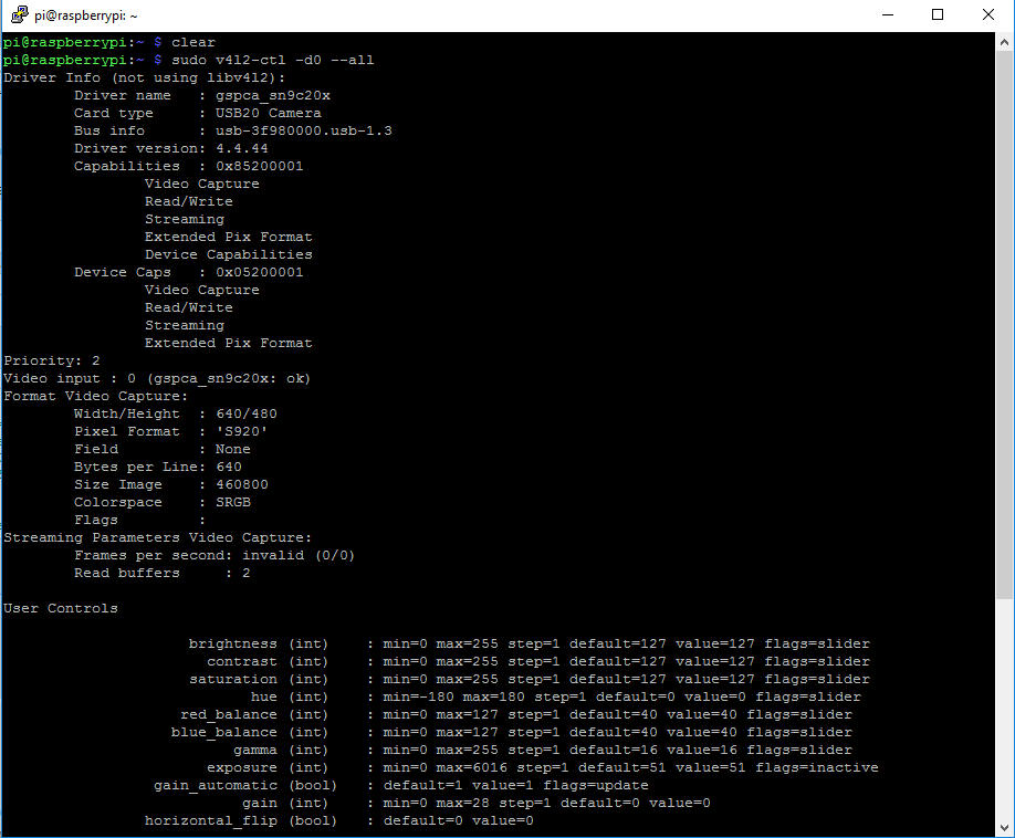

I'm in a similar position to G8VDP
I have a small Clip on USB Camera, it would seem that the Pi has recognised it, but does that mean it will work?
There doesn't seem to be any method of viewing or displaying the input video so having nothing to receive with (yet), I'm in the dark.
Pi Camera.jpg (133.18 KiB) Viewed 12276 times
