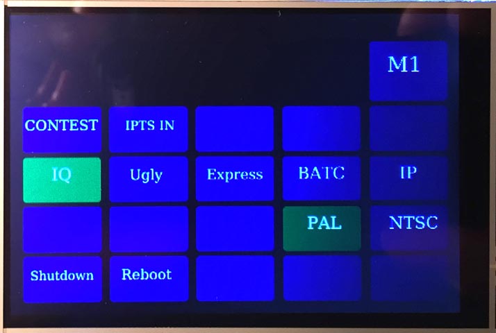

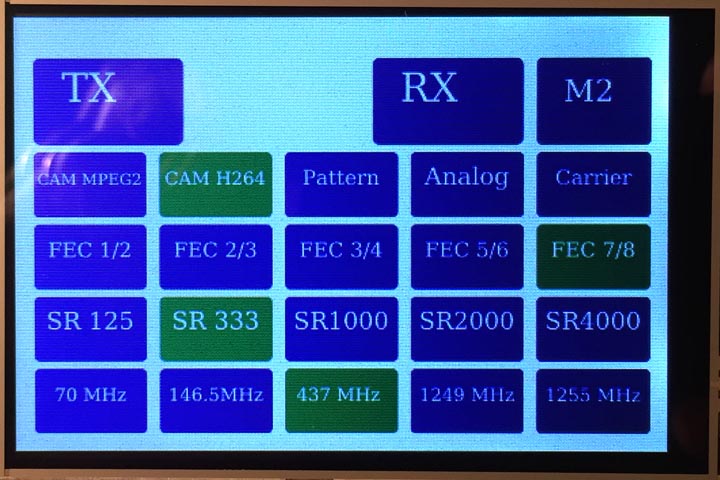

New Software Release - Special Contest Edition!!
I've just issued a new release 201705301. This introduces a second menu page on the touchscreen, enabling the selection of additional sources, Output Modes, the video input format and Shutdown and Reboot.
After upgrade, you can select the second menu by touching the M2 button on the first menu. You cannot transmit from the Menu 2 page - it is simply used for changing settings. The background is black to indicate this.
The top row of buttons is an extension of the source menu on Menu 1. You can select Contest input here and the numbers that you have previously set up will appear during transmit and be transmitted; no need for hand-written cards!
The second row enables you to change output mode from the touchscreen. For normal use with a Portsdown filter-modulator board select IQ. You can also select Ugly (QPSKRF) mode, DATV Express, BATC Streamer or IP outputs. Many of these will need to have been pre-configured in the console menu.
The 3rd row enables you to select PAL or NTSC video capture on the BATC's Fushicai EasyCaps. It has no other function (and is there because my best shack camera only outputs NTSC or HDMI!).
The bottom row includes Shutdown and reboot buttons. You can return to Menu 1 (to transmit) by selecting the M1 button.
I have plans for the blank buttons, but would be interested to hear of your ideas!
Lastly, the deselection of transmit whilst in pattern mode no longer risks inadvertent parameter changes. You can now touch the screen anywhere to deselect transmit and that is all that will happen.
I would recommend all touchscreen users to upgrade to this version and use it on the air during the Contest on 10/11 June. Remember that there are certificates for the best Portsdown contacts!

- Menu2.jpg (64.88 KiB) Viewed 6803 times
- Menu1.jpg (107.86 KiB) Viewed 6803 times
Re: Transmitter Software Capabilities and Issues
Well done Dave G8GKQ,
I upgraded my Portsdown software for RPi-3 to release 201705301 smoothly…and it came right up and transmitted correctly on the first try. I think the second LCD “buttons” screen is great because I can now easily say REBOOT or SHUTDOWN from the touchscreen without booting up my CONSOLE PC. Thank you for your efforts!!
