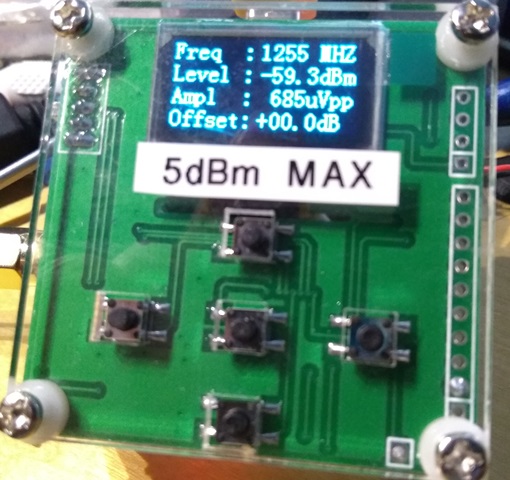

Without the filter board inline I've been checking the outputs from my 4 way switch, using this little eBay power meter, good for +5dBm max.
2018-11-24 18.57.58.jpg (95.89 KiB) Viewed 6984 times
Changing the indicated frequency changes the displayed value so I can but 'hope' that its a reflection of the manufacturer's published sensitivity scale??
I get the following readings:
Direct from the modulator 4m 843mV, 2M 800mV, 70cms 670mV and 23cms 490mV.
After passing through the attenuator and 4 way switch AND ATTENUATOR (SET TO ZERO) I get understandably a bit less: 4M 814mV, 2M 720mV, 70cms 620mV and 23cms 475mV. These seem appropriate.

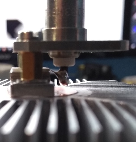

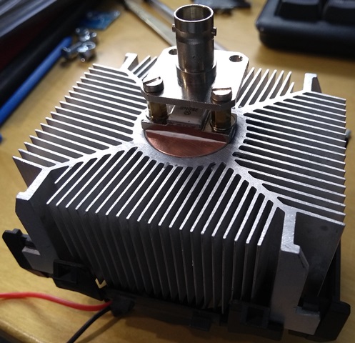

I needed a compact 100 Watt dummy load for testing so I bought one of these : https://www.ebay.co.uk/itm/DC-3GHz-50oh ... 2749.l2649 hoping it wasn't a piece of junk......
Works well and measures 50 ohms too. Bolted to an old PC CPU heatsink that had a solid copper core all the way through. Some only have a short slug. Drilled 2.5mm on 18mm centres and tapped the two holes M3. BNC socket from stock, job done. Running 100 watts HF intot it produces warmth, but with fan running on 12 volts it keeps it all at sensible temperatures.
