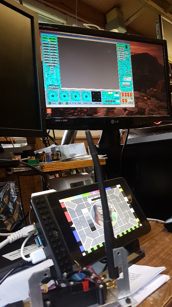

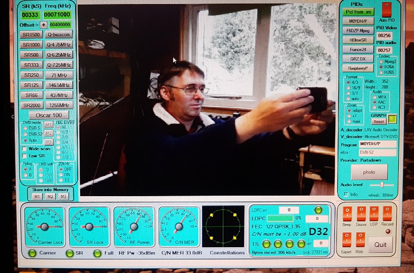

Pictured is a Lime mini FW 1.29 and Portsdown 4 202009010 transmitting a strong across shack signal without a byte of transport stream being received. D24 plus with superb constellation but no picture. Any firmware gives all tests passed on Lime report. Ive updated to Lime DVB which is now transmitting ; wasn't before after last month's blunders. Again 4 reds on TS. Oh dear. Langstone isn't installed.
I'll press on with my homework that you set, restore to FW 1.29 and try the Jetson.
David M0YDH
David M0YDH
- Super signal. No picture.

That's usually a sign the RX isn't working. Do you know it does indeed work?

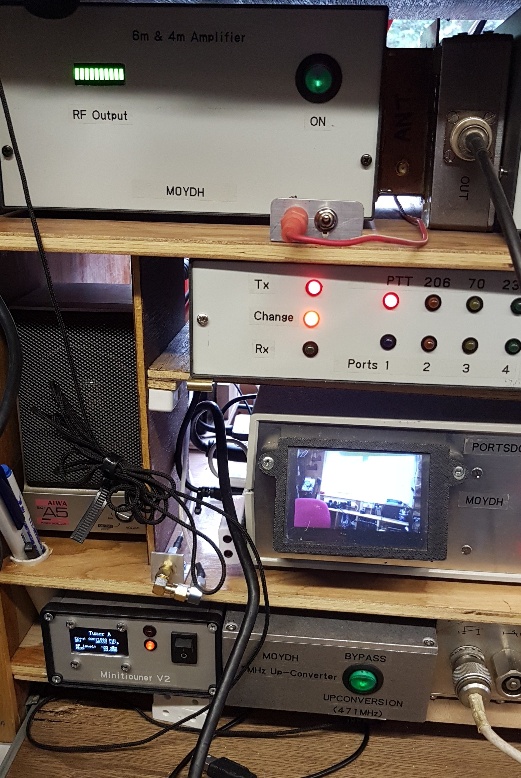

Hello Mike
I've successfully repeated last weekend's tests. Phew- relief. The Portsdown in my rack here is on Stretch 201912100. I have one Lime mini and one V2 Minitiouner. The output is to Lime mini mode. Your upconverter is doing a good job! Lime DVB mode isn't producing output on the Portsdown 2019.
I suggest that the absence of transport stream is a v4 software or Lime firmware problem? As long as the rack portable station works then I'm fine.
Does anyone in the Midlands want to borrow a 71MHz DATV station for the forthcoming only activity on the band BTW? I'm on parent taxi duty for duration of the 4m and 6m activity weekend. Unless I park somewhere between e.g. Mike and Shaun G8VPG it's not going to be used this year.
David M0YDH

- Portable station on 4m tests
- PhotoPictureResizer_200906_160742096_copy_521x778.jpg (189.14 KiB) Viewed 4933 times
- Retest Portsdown 2019 and Minitiouner on 4m.
- PhotoPictureResizer_200906_160443484_copy_816x540.jpg (167.8 KiB) Viewed 4933 times

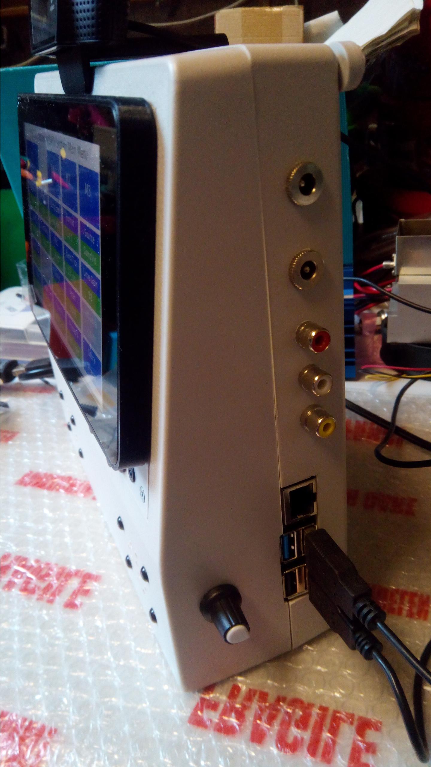

Hello you clever programmers.
I have just built up a portsdown4 It is working lovely. ** Thank you developers **
I put phonos on side of case ( Yellow Video out ) but cant see if its implimented "yet" in menu.
Unless I missed it ?
Many thanks Ken G8VDP

That's a nice-looking build. Keep an eye on the internal temperature (Menu 2, info); I had to put a fan in my Portsdown 4 which I had built into a plastic box with a Pluto - I caught it at 70 degrees C. While they will run OK at that temperature, I wasn't sure about the long-term reliability of the other componets in the box.
Video out is not working on the Portsdown 4 at present. Lots of things have changed around the graphics and video architecture from what worked on the Raspberry Pi 3, and when I tried to enable the video out on the Portsdown 4 I lost all the menus. I'm not saying that it will never work, but your yellow phono might stay unused for a while.

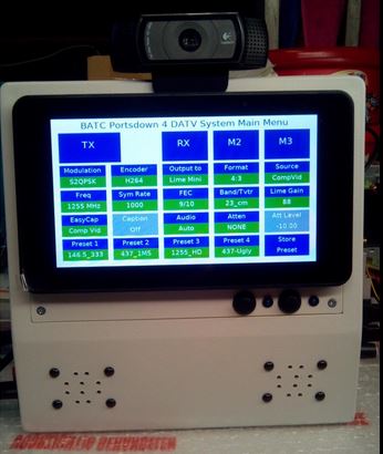

There's lots of room inside that case still. Despite it having a mains switch mode supply at 5v 5a in it. I can use it in the car too with a 12v/240 mains inverter. The 2 black buttons & LED's under the screen turn on the 2 DC outputs on the side of case. 12v & 5v for powering externals , such as small amps Chinese or (G4BAO), and/or a media player.
Its my Portsdown pi4 build 3, the 1st is filter modulator type. 2nd is the same as the above grey one but black case & pi3b+.
No. 1 is in a metal case but I've noticed with these plastic cased Portsdown's they are susceptible to crashing if a handheld 2m or 70cm is used TX within a meter or so. Not ideal if you take them / portable or mobile. Yet from shack I can do 100w from base antenna with no effects on Portsdown.
Its just handheld there's an issue. Nothing new there though. We know why.
I may need to add some internal screening.
Re temperature, thanks for warning. I'll fit a fan asap and drill a few exit holes.
