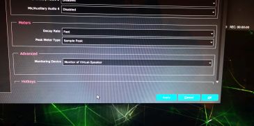

Now open OBS and go into advance audio properties and change all your audio sources to monitor only, when you've done this open setting, audio then change monitoring device to "monitor of virtual-speaker"

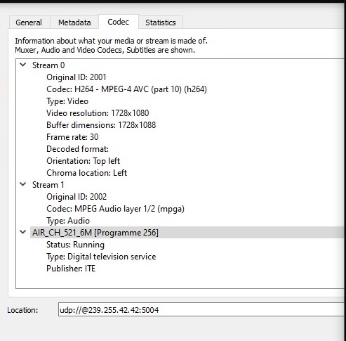

First problem I found was that the LKV373A V3 sender has gone end-of-life but according the LENKENG web site the new model is the LKV383 V3 which they say is compatible with the LKV373A V3 so I ordered one via eBay (£39.60). It arrived on Saturday so I took the plunge and upgraded it to the Yodeck firmware as per CQ-TV 269 preparing myself for a "bricked" sender! Well I'm pleased to report that the Yodeck firmware upgrade worked perfectly checking the multicast output using VLC.(Screenshot attached).

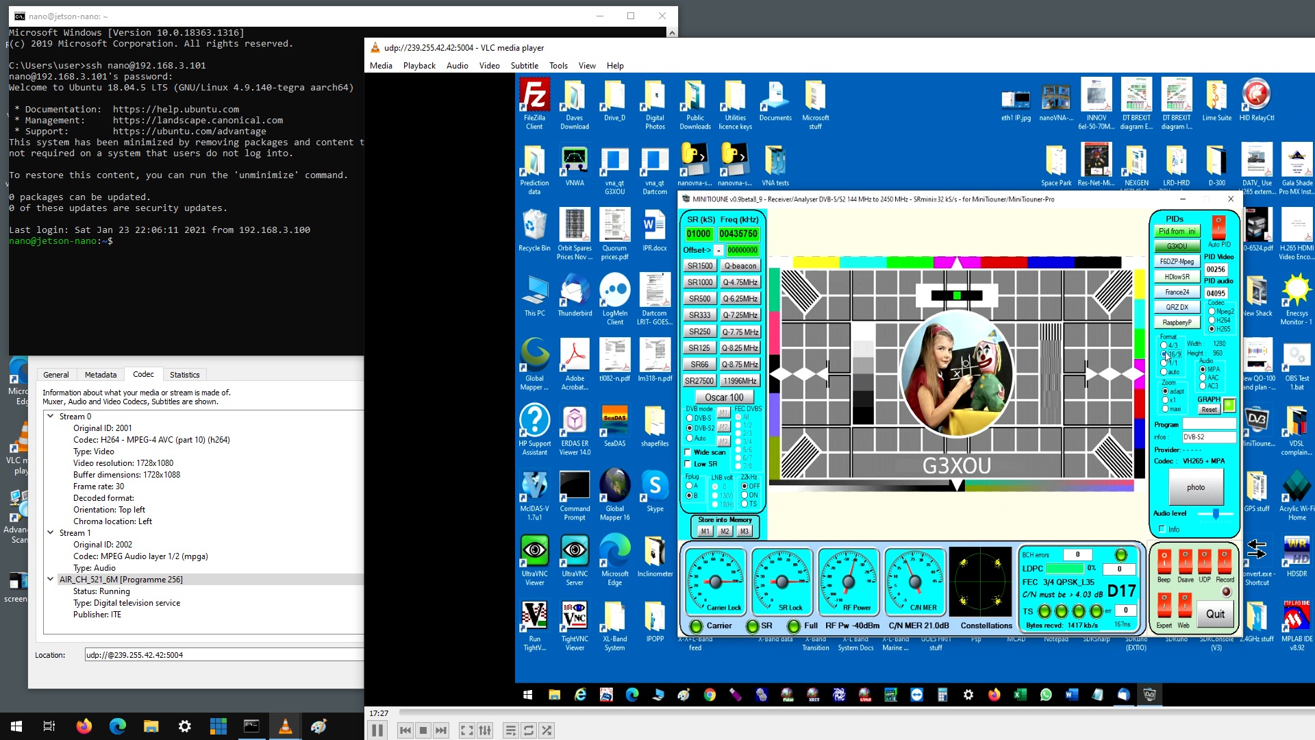

All went well with the build of the NanoBox as per CQ-TV 265, 268 and 269 - Jetson Test Card was fine monitoring it with my MiniTiouner.

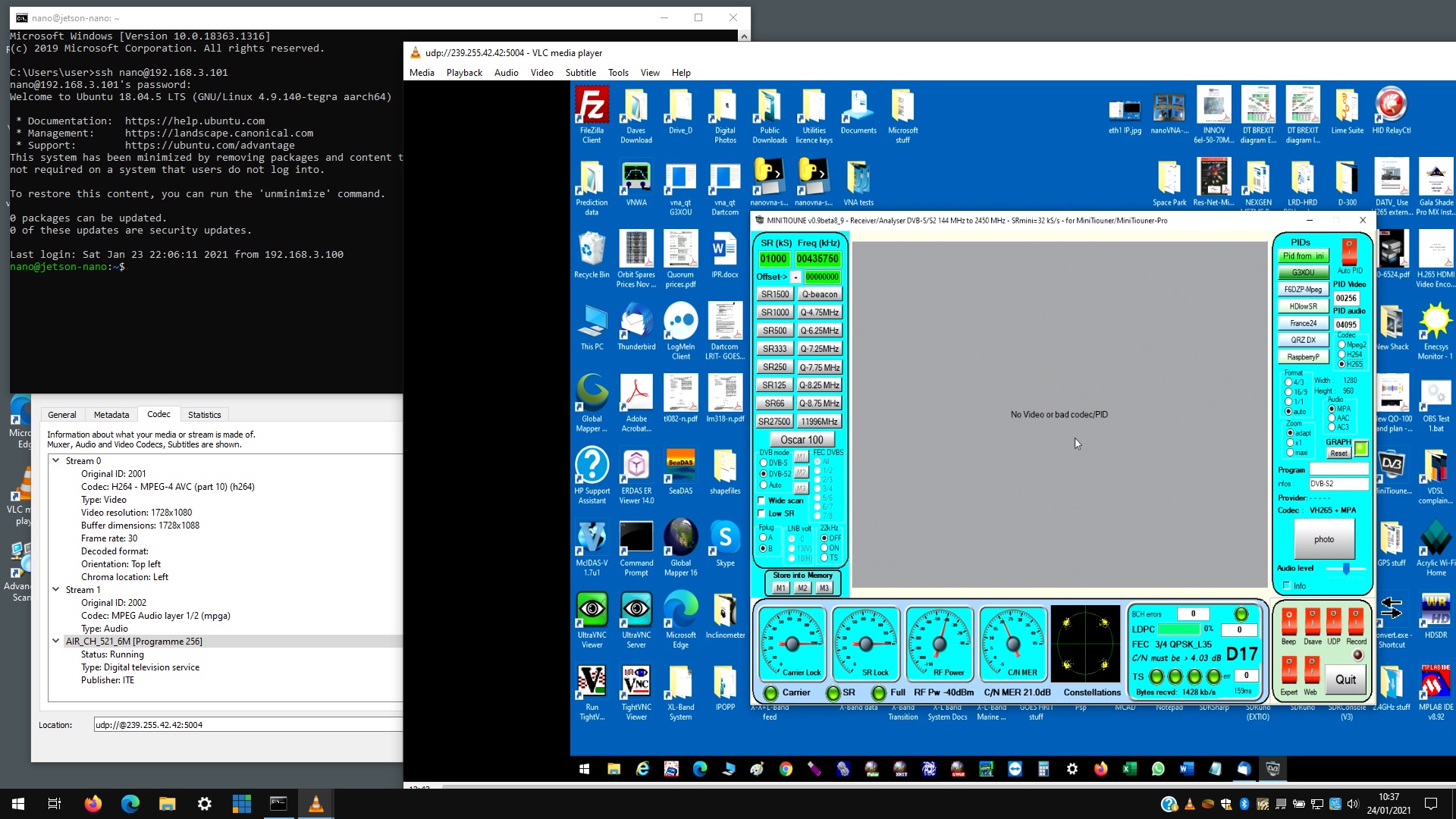

However I'm now stuck with a big problem in that I cannot get any video on the transmission using the C920 camera, Pi Camera or HDMI Sender. I am using the latest version of the Portsdown 2020 software. All the Jetson Nano control functions, setups etc work perfectly when selected on Portsdown 2020. With just the C920 plugged into a USB socket on the Jetson, selecting the C920 as the Video Source, and transmitting get a perfect transmission on the MiniTiouner but no Video and the two blue LEDs on the C920 do not illuminate. Changing to the Jetson Test card with with either H264 or H265 and the video is fine. (see screenshot) I've tried connecting the C920 via a powered USB hub with the hub connected to the Jetson in case it was a volts drop issue powering it from the Jetson USB port. With the C920 removed I plugged in the Pi Camera and an audio dongle with the same results. Using the HDMI Sender gives the same results. (See attached screenshot). I can see the LAN activity LED pulsing when the HDMI Video input is selected on the Portsdown but no video is being received on MiniTiouner. I have checked the multicast output from the HDMI sender with another PC connected to the TP-Link TL-WR841N router using VLC - all OK.
I've done two SD software builds on separate 32GB SD cards - still the same problem.
The Jetson Nano is the 4GB model with the updated PCB B01 with two Pi Camera connectors. I've just wondering if they have changed something on the B01 Jetson Nano that has made it non-compatible with the DATV software build as per CQ-TV 269.
Do you have any suggestions as to what might be the problem?
73, Dave G3XOU
