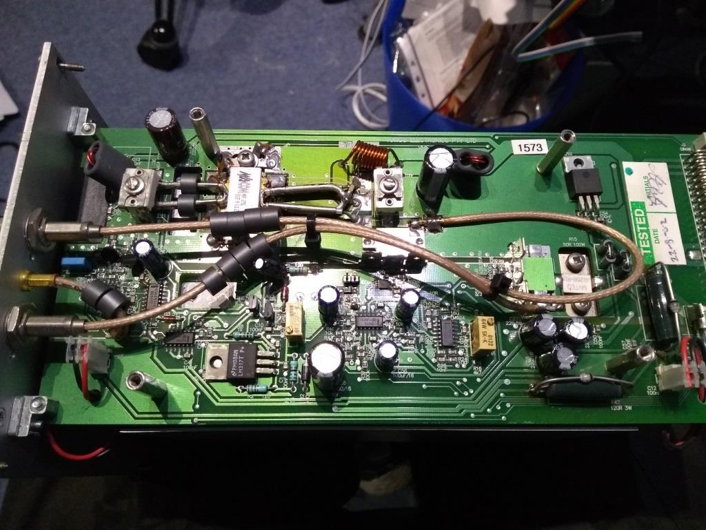

As usual a good morning out at the annual CATS bazaar where I picked up a nice looking amp that might do me good service on 2M DATV. The vendor 'thought' it was to do with paging or comms and it was marked as GUYS (hospital) on the back. Certianly loos like VHF and its TUNABLE. The company that made it (in 2002) is still in business so I've emailed them for circuit info etc. A sweep of the input shows a good match at 146 and at 156 MHz (unpowered). The device itself is a MRF275G-MOT Transistor, RF MOSFET, 150W, 500MHz, 28V, Motorola. The board includes a pre-driver and a VSWR output via an Analog Devices log detector chip. I hope they let me have at least operational info.....
2018-11-18 18.55.47.jpg (137.48 KiB) Viewed 4998 times
Looking forward to feeding it some DC and then RF :-) A pair for £15, with fanned heatsinks :-)

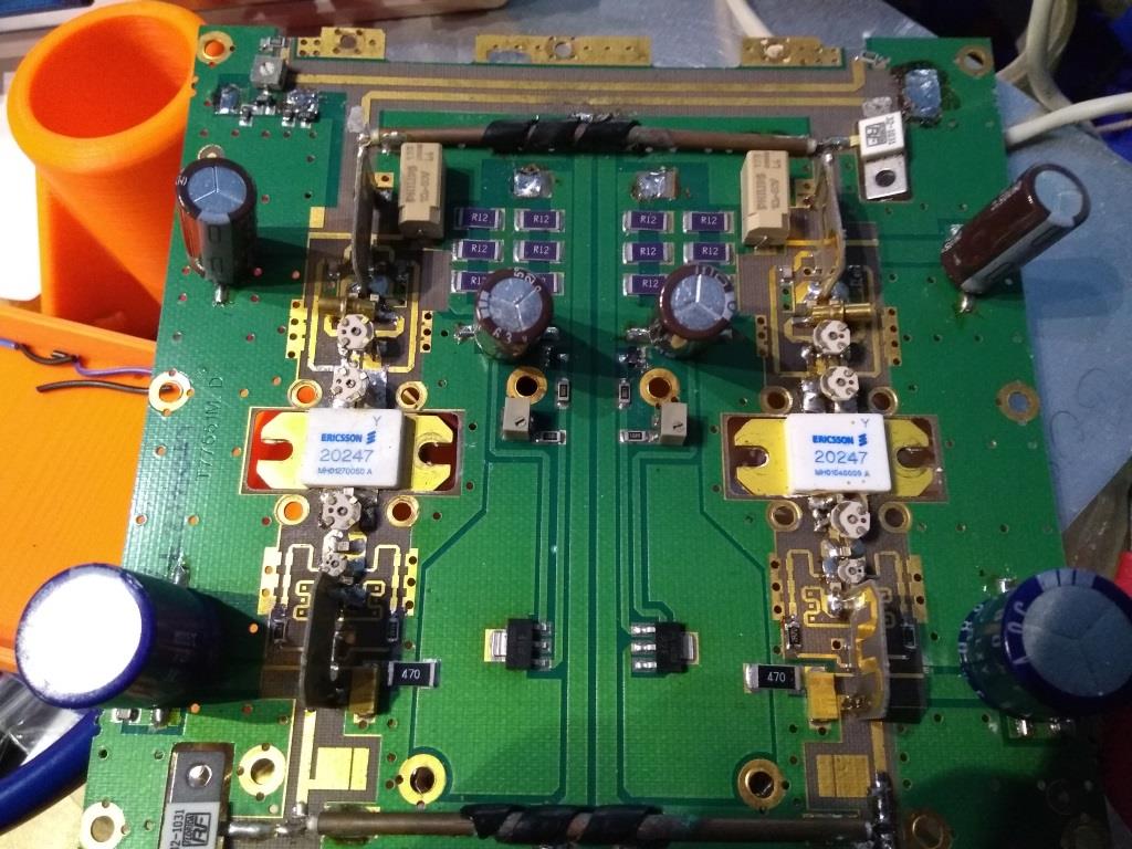

I also picked up what looks like a PA for something mobile phone based (??), with an identical pair of Ericsson 20247 (PTB20247) 150 Watts, 470-860 MHz UHF TV Power Transistor, this was all of 50p :-)
2018-11-18 19.09.15.jpg (136.49 KiB) Viewed 4998 times
Got a Dolphin PA for 70cms so no rush to do anything with the latter, but 50p? I wasn't laving that behind!

Well this gets mainly better and better.... although the makers say they don't support this product anymore (16 years old) I have had a good look at the circuitry. The input is a mere BF988 (200 mW max dissipation) so I was wondering what the planned output was likely to be. However, there is a little black box hiding under the PCB and it turns out to be one of these: https://www.rfmw.com/datasheets/p1db/CA2832C.PDF
A 35dB gain block for VHF? That'll do nicely. I can see that the powerfet pair MRF275 can be made to earn their keep, although needing 28 volts to do it. Once my Portsdown if finished I'll move on to this beast and see if I can persuade it to amplify as required.

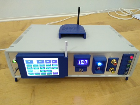

Post by radiogareth » Sat Nov 24, 2018 6:55 pm

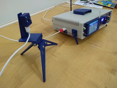

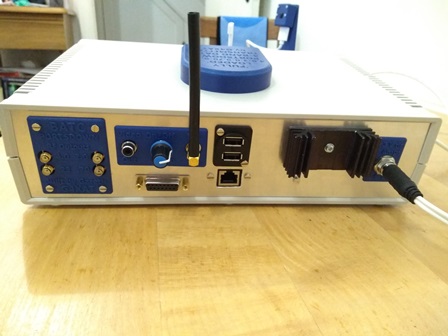

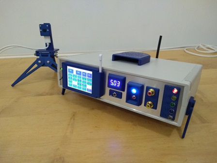

And its finished.....(minor fault in the 4 band filter switch/amp) but everything else works :-)
A huge thank-you to everyone who has contributed to make 'Portsdown' possible. Its capabilities continue to amaze me. Quite how many hours its absorbed I have no idea, but its one of the many projects I've been waiting to do. Its a tight fit, but serviceable. Front panel has touch-screen and pen holder (vital;-)), Voltmeter for RPi/battery/off, shielded shut-down button and LED, video and audio in to Easycap, band indicators and TX light. Rear has the four band outputs, composite video out from the RPI, Audio on/off/volume , speaker under hood on lid, 15 way D has the 4 band amp control, tx control and 'DC input' out. Two spare USB sockets, RJ45, heatsink for linear 5 amp regulator and a HD waterproof screw-secured DC in 2.5mm.
Thanks again to those who drove, and are still driving this project.
2018-11-24 18.01.10.jpg (45.4 KiB) Viewed 4850 times
2018-11-24 17.58.27.jpg (87.78 KiB) Viewed 4850 times
2018-11-24 17.57.45.jpg (51.27 KiB) Viewed 4850 times
2018-11-24 17.57.13.jpg (49.28 KiB) Viewed 4850 times
2018-11-24 17.57.04.jpg (52.07 KiB) Viewed 4850 times

Post by G4uvz » Sun Nov 25, 2018 11:05 am

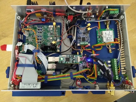

Just looking at the pictures of the build ...It 'appears' that the Filter board is in cct After the Modulator???
Mine has been running successfully for 12 months with it in position after the LO and before the modulator board?
It is difficult to se on the picture may be it is belt and braces with two filter boards??
Just interested to know?
Adrian
Posts: 1490
Re: Portsdown boxing/build thread
Post by radiogareth » Sun Nov 25, 2018 12:41 pm
Whoops! Well spotted, not sure how THAT slipped through!! Pretty damm clear on the block diagram I have printed out here too. Some quick cable re-routing I think!!
G4uvz
Posts: 219
Post by G4uvz » Sun Nov 25, 2018 3:09 pm
Glad to be of assistance!!!
