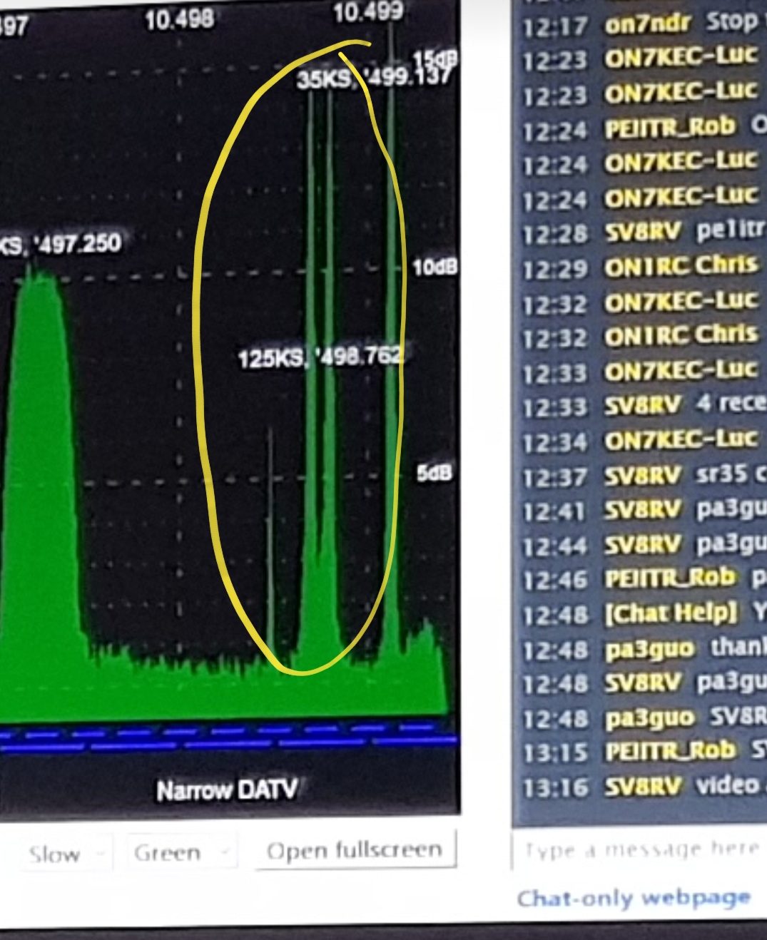

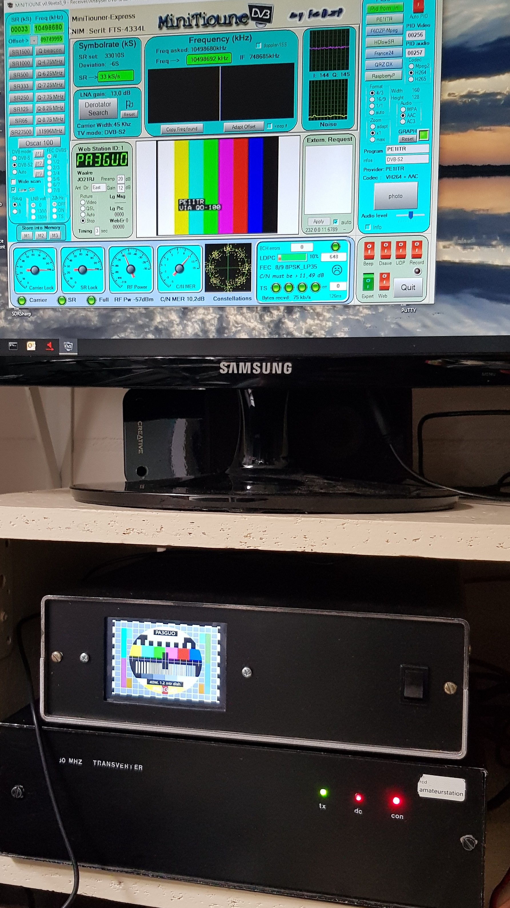

33ks works fine, using 8bit psk, FEC8/10, 2-way DATV QSO via QO-100 between PE1ITR and PA3GUO.
Distance <100kHz, looked like a single signal on the webSDR.
