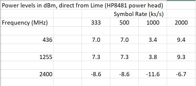

Hi all,
some test results at my end. Programmed a 32GB SanDisk Elite card as per the Wiki procedure; upgraded the Lime firmware to 1.30 then LimeDVB ok (as reported at the time). Interestingly, the Lime report page says 1.30.
All started ok first time, with 7 inch display correct way up. Tested the power output on 3 bands, results as below. Can't seem to get any significant power output for 'Carrier' mode but DVBS-2 ok. Power measured using an HP8481 head and HP436A power meter, last calibrated a long time ago, so measurements for indication only. Power head connected directly to the Lime Tx output with one N/SMA adaptor. Lime gain 100, DVBS-2, FEC 9/10, Test Card, all powers in dBm.
There seems to be a reduction in power at 1000ks/s for some reason and as mentioned 'Carrier' mode seems to give a very low power (<-16dBm) even on 436MHz.

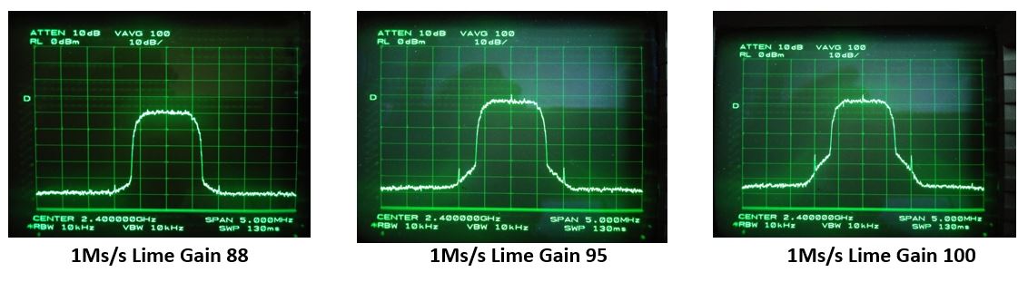

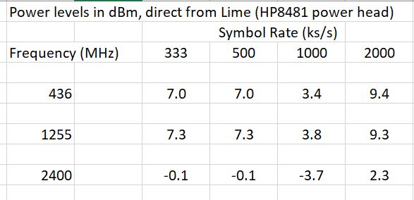

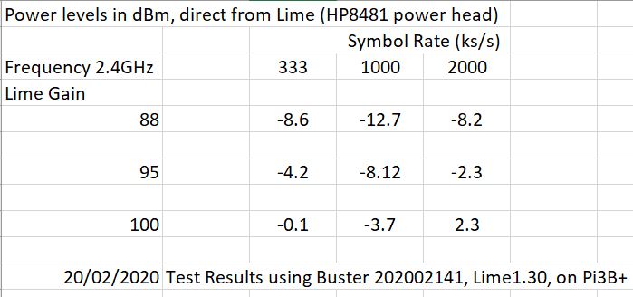

an update on my power table above. Unfortunately, the 2.4GHz results posted were for a Lime Gain of 90 not 100 as stated. The 436 and 1255MHz results were ok. It shows how you have to be careful when changing frequency as other stored settings may change. The corrected table is below. What I have also done, is to show how power output varies with Lime Gain and the effect on the spectrum, for 1Ms/s at 2.4GHz. All results DVB-S2.
Jen G4HIZ
Jen G4HIZ

Thanks for the correction Jen - I was having trouble reproducing your 2.4 GHz results!
I have identified the reason for the 1000 kS power drop and will correct it in a minor update later today. This will potentially worsen the 1000 kS spectrum at high Lime Gain levels, as the spread is quite simply caused by overload in the Lime output stage. Reduction in Lime Gain to produce the same output level as shown below will result in the same performance.
