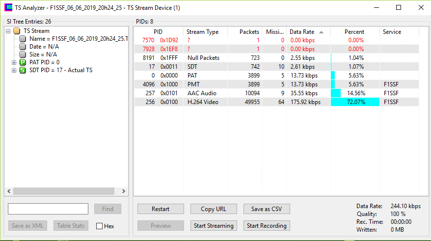

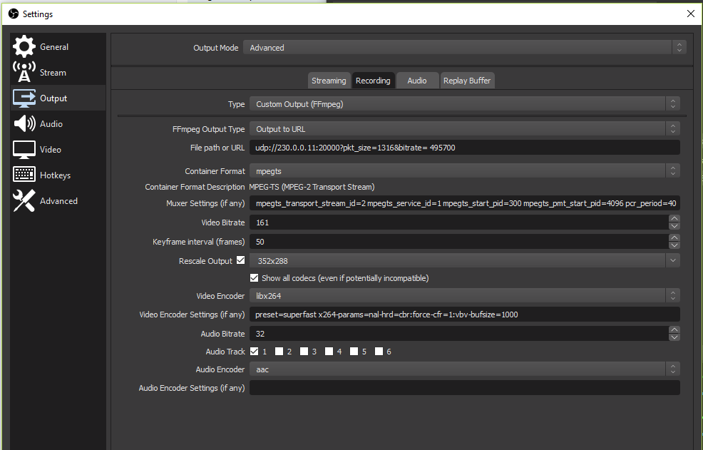

See my output file:
OBS OUT.PNG (42.32 KiB) Viewed 6719 times

Hi Franck I think the issue is you have not changed the bitrate in the FFURL, you need this to be the same as muxrate so try changing it too 268500 so it should be
FFURL=udp://230.0.0.11:20000?pkt_size=1316&bitrate= 268500
Hopefully this will now work also check in the script as well.
All the best John

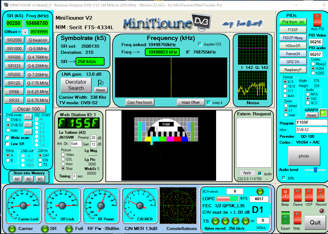

see attached my pattern on QO100...and if I try to use webcan, image is cloudly and pixelizedand looked.
I continue tomorrow...
See you later, thank you.

The video and pattern are perfect.
I must to wait few seconds before FFMPEG stabilizes.
I noticed some flaws on the mix transitions, I must cut the TX so that the image is correct.
The sound looks good too, and I have no more cuts.
sincerely congratulations for the relevance of your information 8-) 8-)
vid perfect.PNG (33.35 KiB) Viewed 6611 times

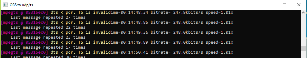

also, sometime FFMPEG has some mistakes
Is it possible to correct it?
73 Franck
G7JTT
Posts: 354
Re: OBS via IPTSin on the PortsDown
Post by G7JTT » Fri Jun 07, 2019 6:55 am
Fantastic that you've got it working, I always let the stream run for a minute or so before TX to let it settle down and yes I still get the odd error in FFmpeg but think thats down to the laptop only being an old i5.
